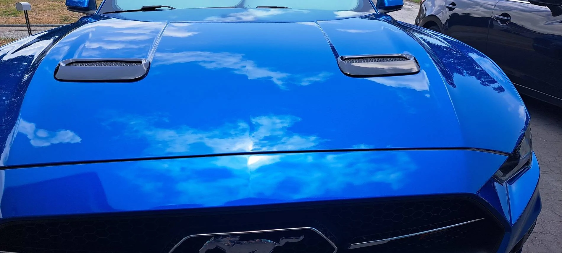

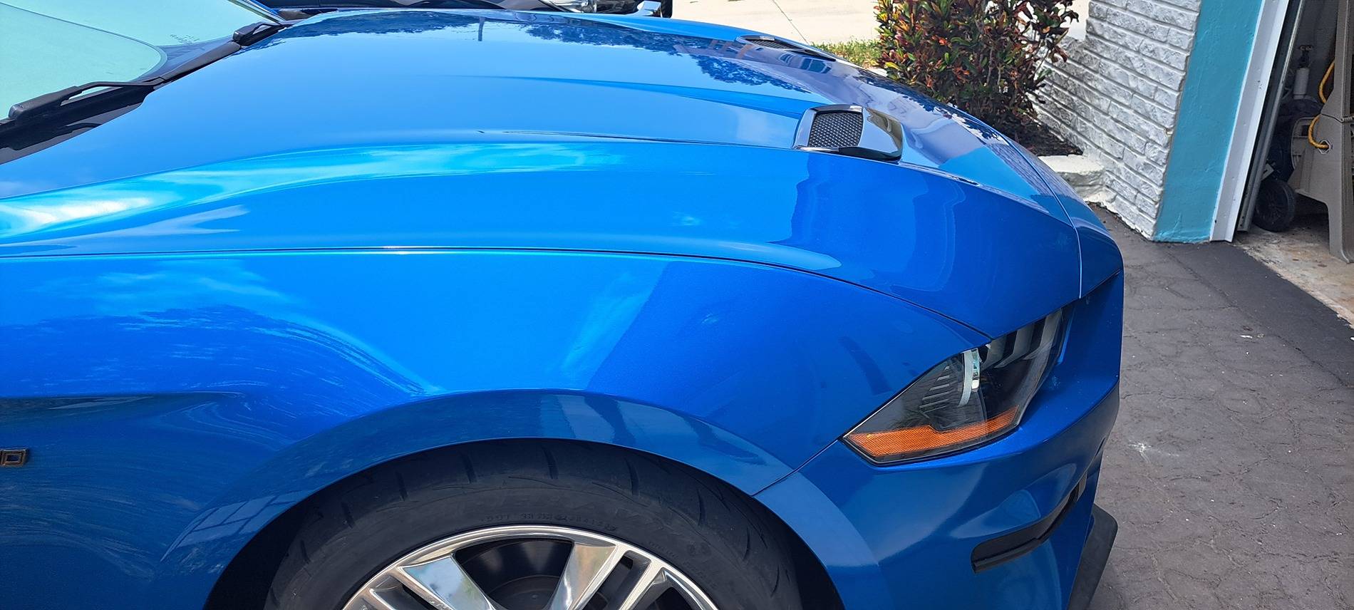

Well, I just got it back today. I think that it looks pretty good.
