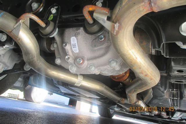

2017 Undercarriage Corrosion

I live in S/W Florida My Mustang is now 8 years old,and NO rust on the undercarriage or any where else,something wrong there.

17 lightning blue pp LFP 670
even salted roads will not cause that kind of rust in that short of time .. im tell ya that car sat somewhere in standing water for along time before you got it .id be on someones ass from ford about that .. i see cars all day long come into my shop and ive never seen that on a new car.. maybe some older cars like 02 and below but never on a 12 and up... thats unacceptable in my book
Threebanger
I am legend.
Jul 16, 2014
518
212
The Dirty South
Bray
2020 Twister Orange GT350
Looks like serious exposure to salt water (IE tidal surge/flooding) or salt from the road up North. Not normal for a year old car at all.

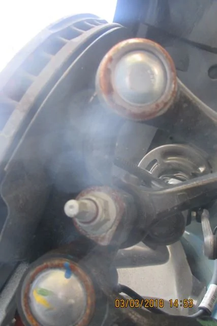

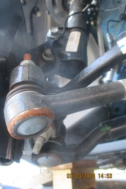

2017 2000 mi. garage queen. Rust from condensation in the garage. Seems to proliferate around welds and lower grade alloys not protected by paint or plating. Shocking, but as long as it's just on the surface, I'm not going to worry about it. Might get ambitious with a wire brush and some aluminum paint at some point.
pcrane
Feb 28, 2018
2018 Mustang GT
Update - finally got the dealership to look at it and the service manager looked at it with me, compared it to another 2017 with 2K miles, and acknowledged that it was not normal and classified it as excessive. Unfortunately, according to him, it was not something Ford would cover under warranty, but he wrote it up that he inspected it and his observations, and took pictures for their records. He said my best bet was to report it to the BBB Autoline as that would force Ford to take a look at it. According to him if either he or I called Ford about it they were unlikely to respond favorably.
Also; has asked if I would be willing to trade it for another one, which I took as a even trade/swap. Boy was I surprised, although I don't know why. What they tried to do was offer me trade in price for my car to go towards another one, which would have been over a $4500 loss for me. What a waste of time and disappointment. So much for doing the right thing. I guess it's on to the next step in the process....

Way worse than mine that was tested by Ford engineers on Michigan roads in January 15 for 48 miles. It looks like a salt water dip to me.....

It isn't Ford's fault if the car was parked in flood water. That's why they aren't going to help...or your dealer doesn't want to have it raised because ford will point the finger back at them.

You can beat this up and back and forth all day. But this car was sitting in water for some time. I believe it's time to talk to the dealer.

You should file a report with NHTSA because the brake line corrosion is a serious safety hazard.
