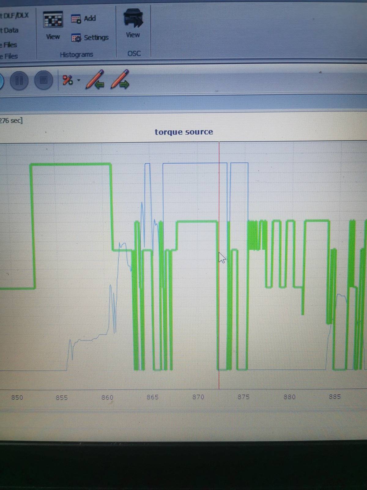

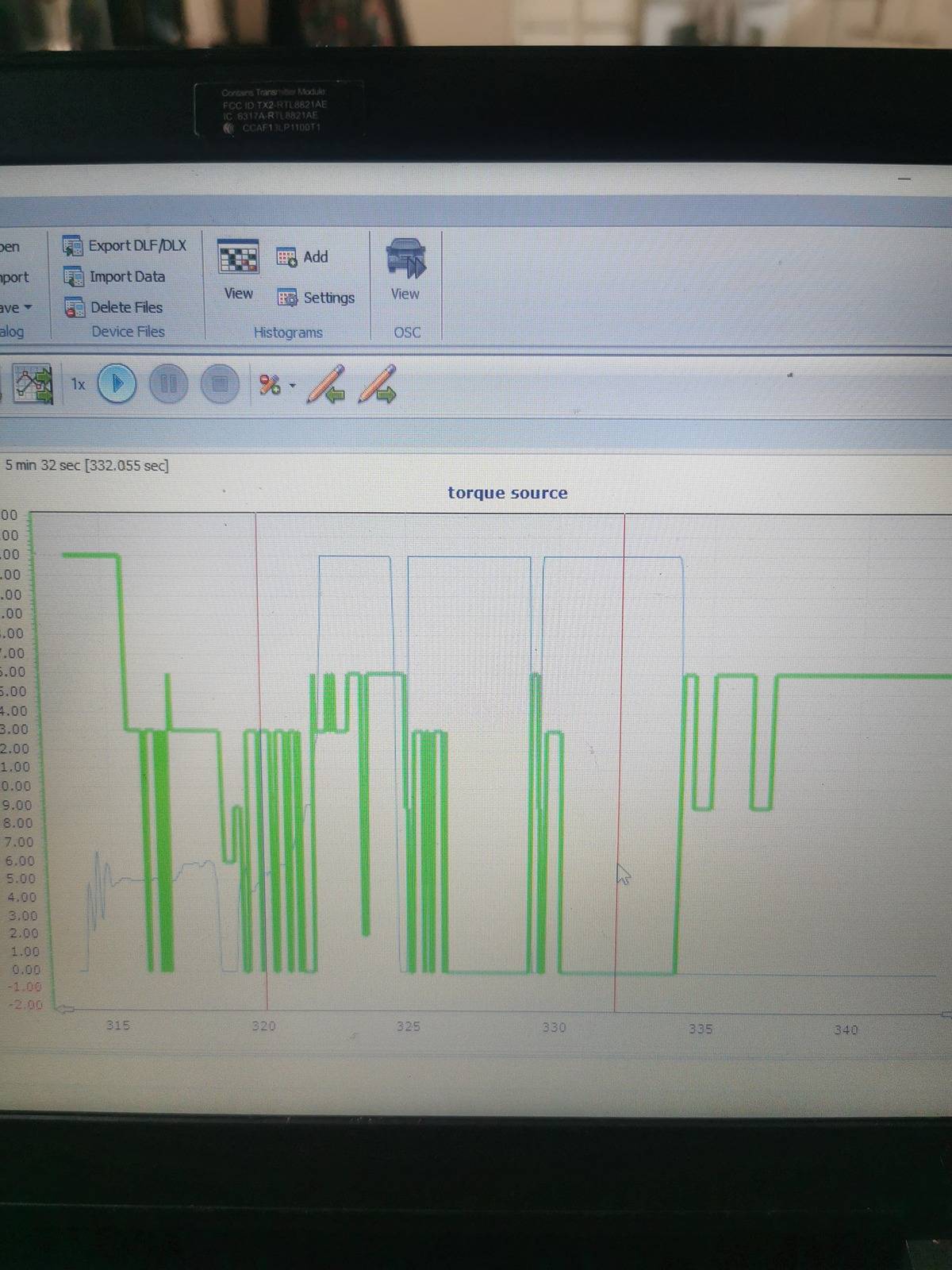

Logs are showing as low as 11⁰ of timing, there no knock retard and fuel is within 2-3%. Datalogged today and 2md gear got 11⁰ shift to 3rd and got the normal 16⁰. What can I look at in these logs to see what's going on? the car does not pull like it should. 115.9 n/a at Castrol dragstrip, 119 today in my dash not sure how accurate those are but still, I thought it would be like 125mph. 3:55 mt82d4 car it's not geared for 1/4. I can post pics of logs if someone lets me know what to show them

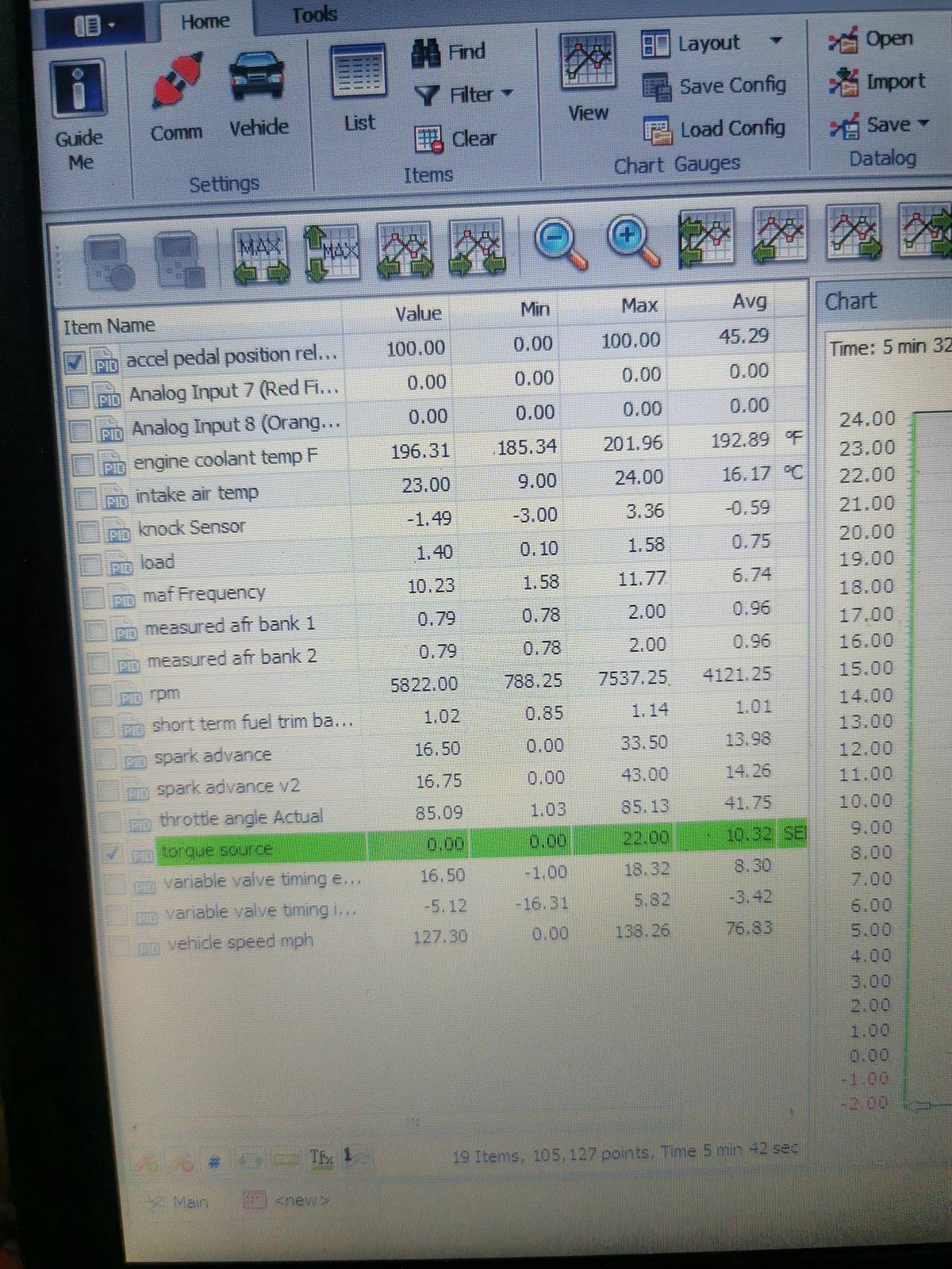

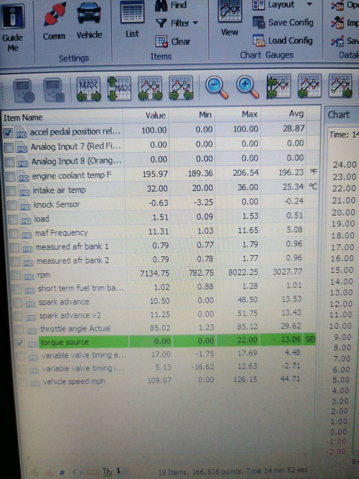

Do you have AdvanceTrac off?
If you don't and don't have full traction (which shouldn't be the case at that power level unless track prep is bad or running street tires) traction control will cut timing to rein things in - along with other things it can do.
This won't show up as KR, just reduced timing advance.
Log Torque Source and it should give you more info

engineermike
Jul 15, 2018
6,306
6,635
La
2018 GTPP A10
0 is driver demand
13 is oscillation modulation
16 is torque based decel

I don't really know what that means, any ideas why it's pulling timing throttle is 100%
Torque Source should be Zero when you are WFO,
You need to check the log and see if Torque Source value changes during the run.
Host up the log, Kinda hard to tell anything from a screen shot,

tq source is green throttle is blue you can see it changes

let me know if this worked
