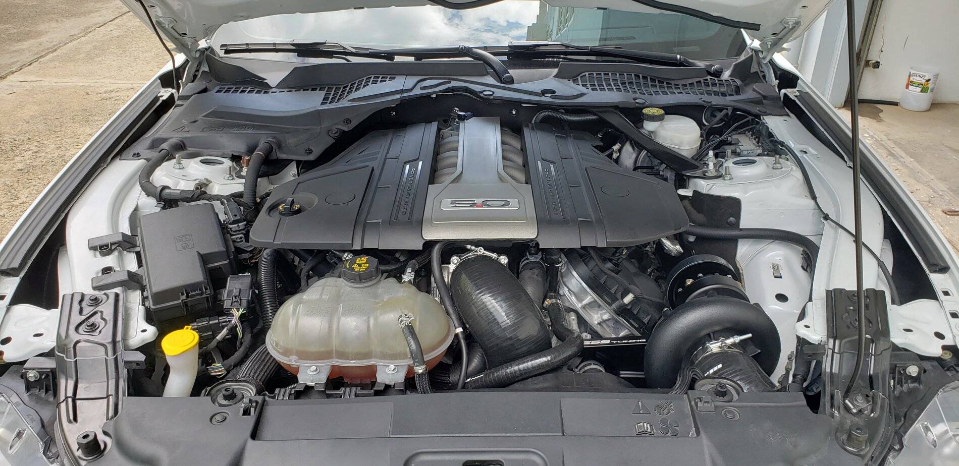

Install complete in 8 hours. Had to use a slightly bigger belt(K061037) as I wasnt able to install the one provided(K061033). Tension seems good with K061037, dunno if probably my19 has a slightly larger balancer...
