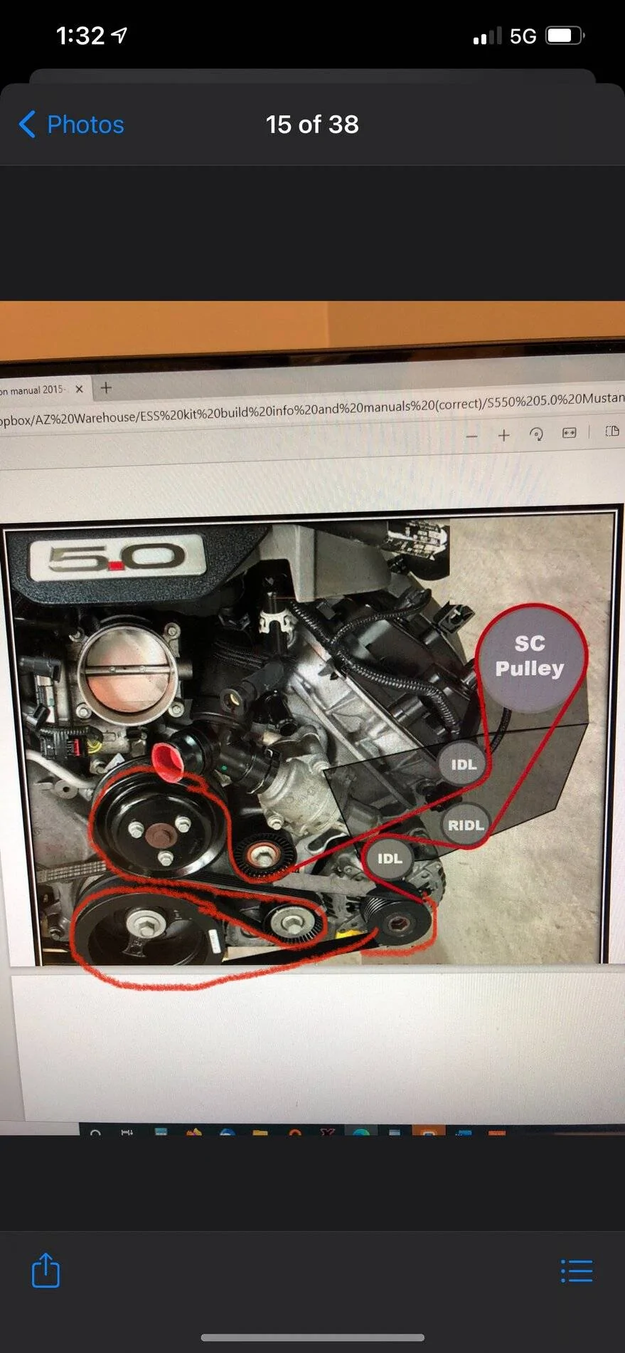

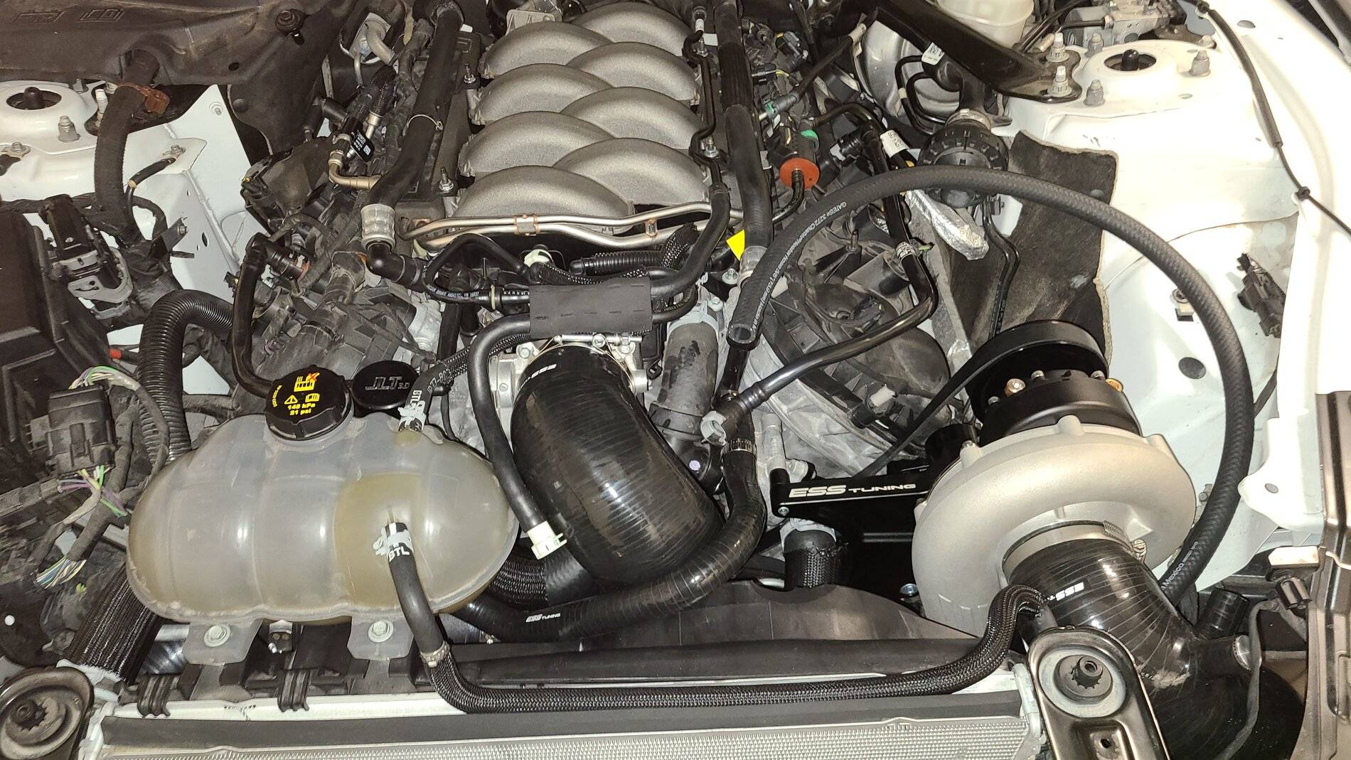

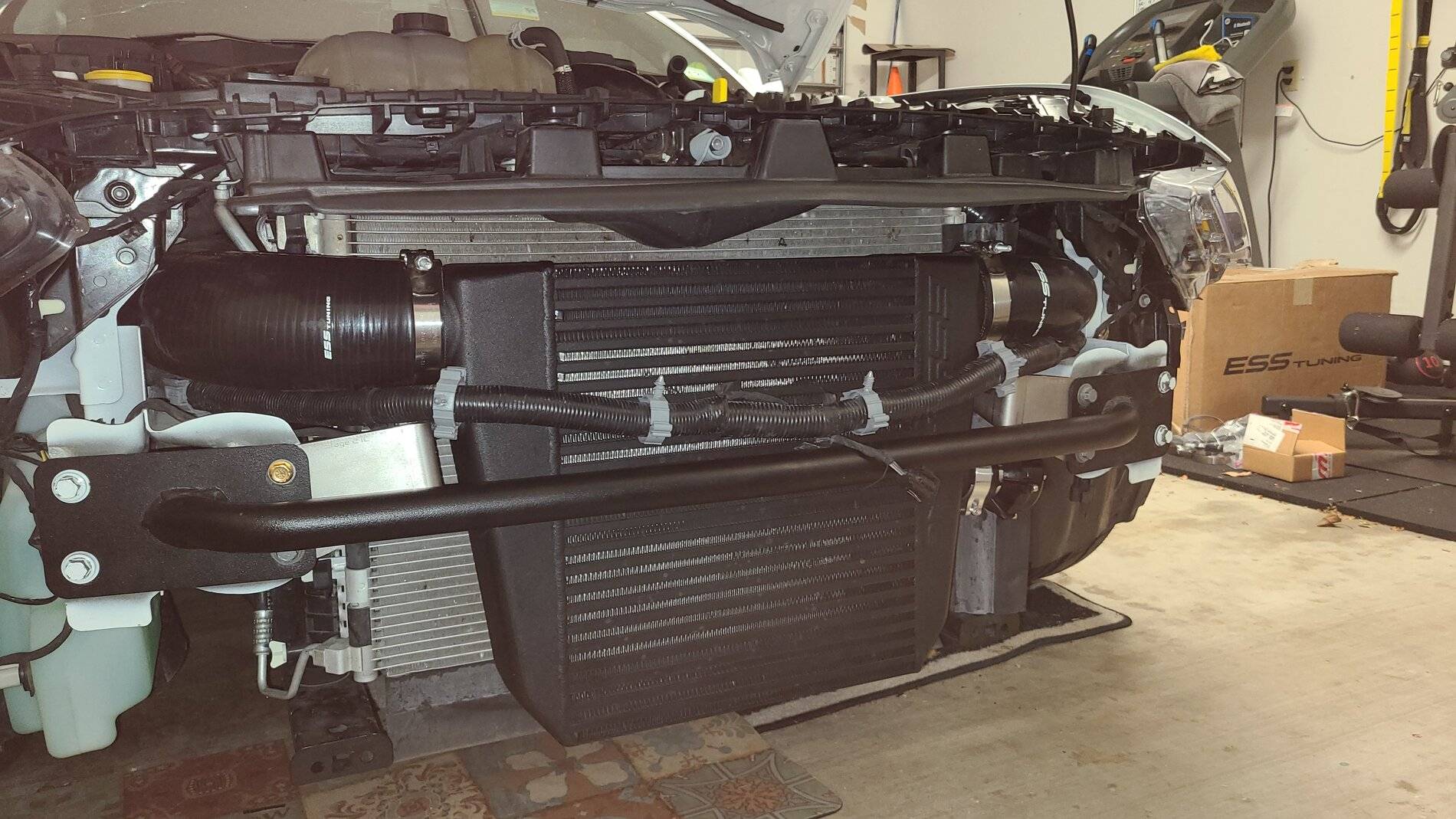

Thanks for the reply. I have already installed BMR rear suspension upgrades. If I'm bored this winter I will put CF drive shaft, Ford Performance Axles. Hey, did you go with a One Piece Drive Shaft and axles?In the immediate sense I'm staying on 93 octane and a Sunoco 260GT fuel tune and 115mm pulley (8.5‐9psi) I have a free flowing exhaust, but with stock headers. The ESS intake is 4" at the filter mount. I think a 4.5" might yield a little more power and boost though. I definitely think 800whp is possible on an 11psi pulley, exhaust and good race fuel and less intake restriction, but I think at that level you might experience other types of restrictions on the engine/drive train. As far as the drive train, if you're going to spend a lot of time on prepped surfaces imo it would be wise to upgrade the suspension and axles before you experience a break, which will ultimately cost more money to fix and upgrade versus just upgrading in advance.
