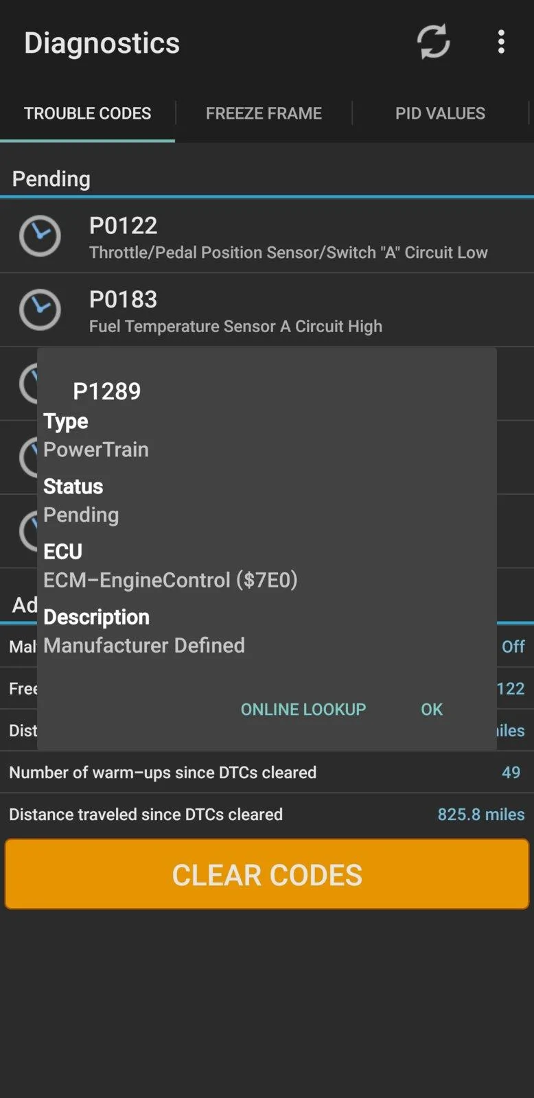

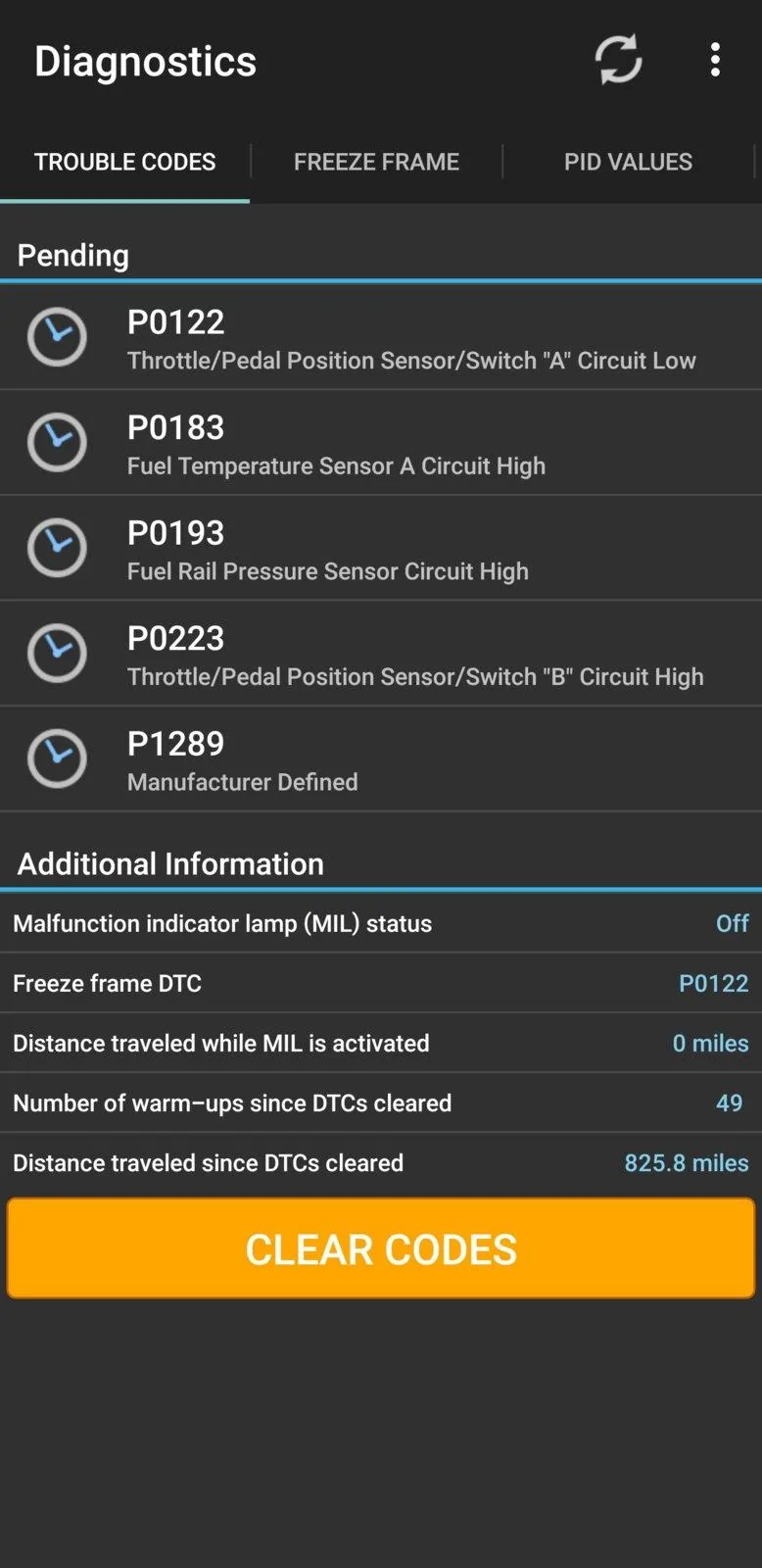

I recently tracked the car at Road Atlanta and spent nearly an hour on track strait with no temp or brake issues what so ever, During the event I did have some troubles with the car but not mechanical. The car exhibited some weird electrical glitches. I depress the clutch for start and still got the notice to depress clutch for start. Attempt to start car and then everything goes dead. Swapped a clutch switch with a fellow track mate and still nothing. At one point the dash notification said press on brake to start engine. I some how got the car to start and then it shut off. Several codes thrown, see attachment. I was able to somehow start the car again and I hit the track for almost an HOUR!!! She ran like a beast!. Car is a street car but damn sure ran like a race car. Got back from the session, shut the car off and presto, dead in the water. Loaded her up on the trailer and home bound it was. Car is in the garage. Have been trouble shooting with a fellow enthusiast (awesome mechanic) we thought we had it nipped. Ordered a new gas pedal and installed it last night. Still dead. I have some more to do tonight, check fuses, relays (again) scan for codes and measure voltage at TB per my friends request. I will keep you all posted with the details and the results. Ultimately she will be in the dealer this Saturday, I really was hoping to have this solved and not have to see the dealer. If anyone has seen or heard of a similar situation please share. I thank you all in advance.

Let me clarify, The engine turns over when I hold the accel pedal, clutch and brake in while pressing and holding start. This, as I understand it, is the procedure to clear any fuel flooding the cylinders. I haven't done a full battery load test but it has the juice to turn the motor over several times. I will load test the battery tonight but I doubt that is it. Attached are the codes that did not post initially.

P1289 is a high cylinder head temp code.
P1289 is the CHT but it is pending due to the fact that the car does not start. All temps where normal initially. I don't believe even if the CHT fails it will prevent the car from strating.
Offboost, many of you recommended, I will load cell test tonight and disconnect the fuel rail and CHT sensor. I did have a data logger running but it is a dongle installed in the OBD port. No wiring was touched prior to the track day or at the track.
