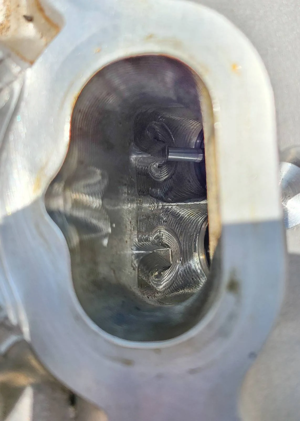

I opened a case with the BBB Auto Line today against Ford Motor Corporation; hopefully we can come to an acceptable agreement out of court but if not, I'm prepared to see it all the way through. I also went down to the dealership to check out the progress on the car and to see what went wrong with K5550933 (RIP). The car looks great considering; Bayside Ford appears to be really trying to keep everything in good condition so I'm super thankful for that. It seems the Regional CSR was mistaken when she relayed the info regarding parts availability because everything they need is already there. The new engine is in the car and the engine was actually fired up last night apparently. The tech stated there were a few things to button up along with topping off the fluids. I expect it will be finished by Thursday (knock on wood).
As for the failure, it was due to the #7 intake valve.
Dam- another swallowed valve !
