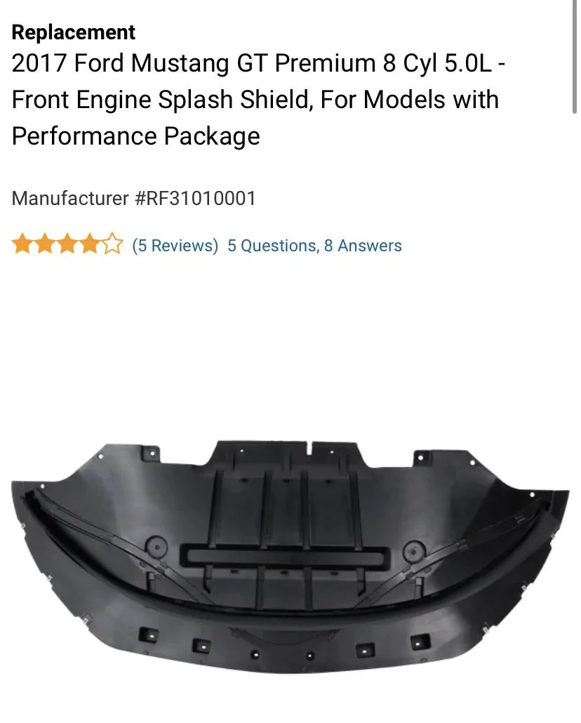

Hi guys, It is dangerous to drive without the engine splash shield or belly panel(same thing I believe)? Mustang gt premium 2017. Thanks for the help ๐Ÿ™๐Ÿป๐Ÿ™๐Ÿป๐Ÿ™Œ๐Ÿผ

Thanks for everyone help, mine falling apart for some days and now Is totally gone, Iโ€™d just order a new one today, as soon as I get it Iโ€™m going to install it. Id better to pay 100 buck for the piece than paying a mechanic to fix electrical components or something related to a hit.
