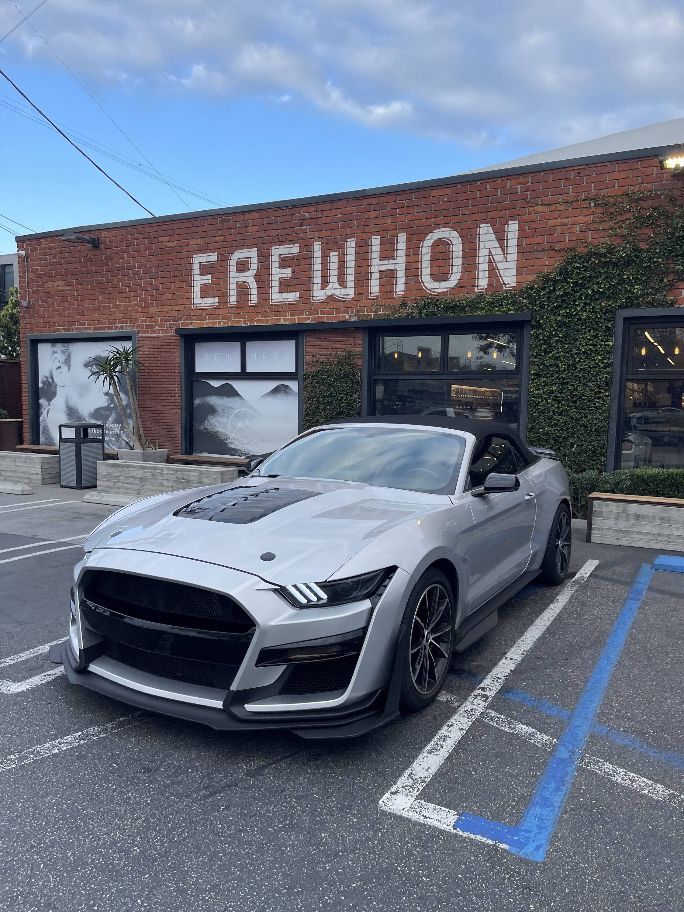

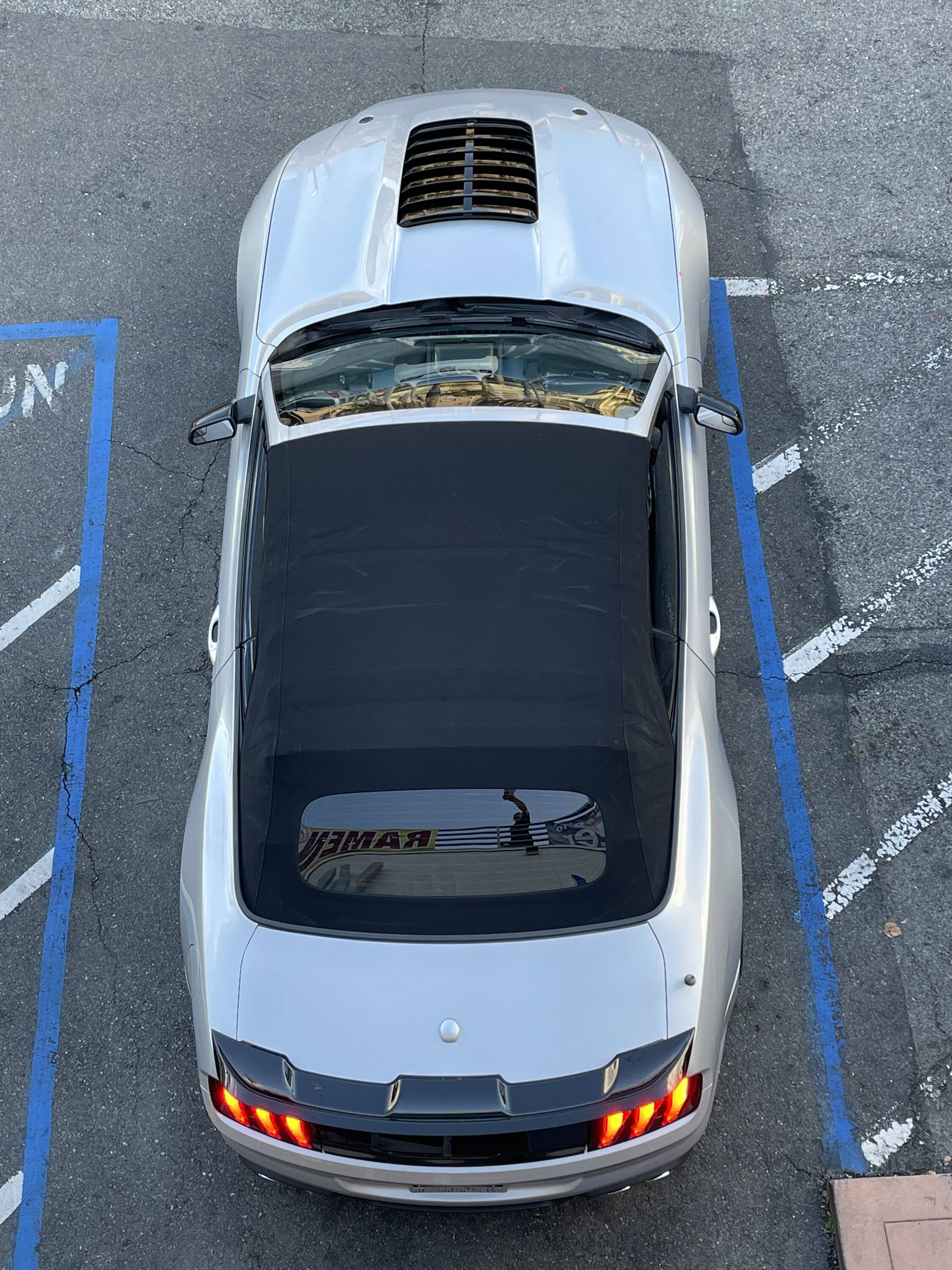

As for the car looking like a GT500, that was the goal. It’s not just a bumper hood swap but an OEM spec Shelby wide body, hood, fenders, bumper, lights, supports and all the underlying parts had to be replaced to convert the front end and 2” spacers to fill the wheel wells. The goal is to have an exact replica GT500, but as a convertible since they don’t actually exist, then eventually do a drivetrain swap in the future at some point. Also the entire interior is swapped from a Shelby Super Snake. There’s more details here in this forum all about the process, but I do need to update it.
