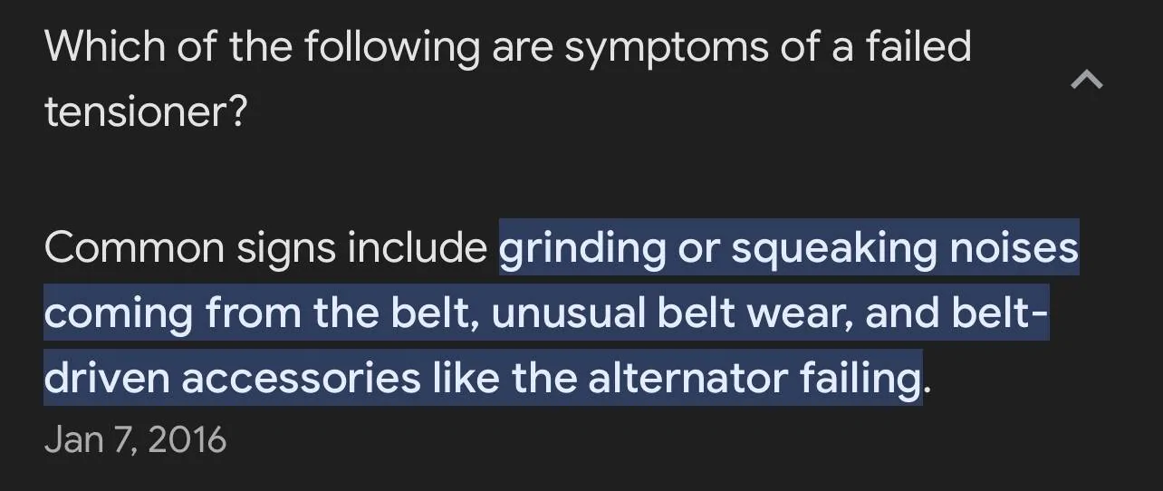

I have the exact same issue. Did you replace the belt tensioner pulley + idler pulley to fix? Did you replace the alternator?
