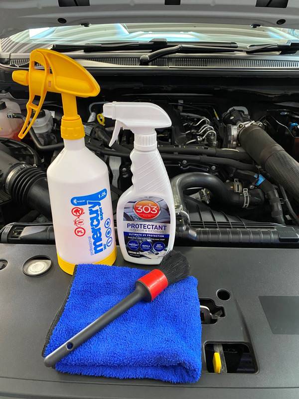

In terms of All Purpose Cleaner, I am using Auto Finesses Verso. However I have used and liked Meguiars HD Multi Purpose Cleaner.
https://www.waxit.com.au/collections/all-purpose-cleaners/products/auto-finesse-verso-apc
https://www.meguiars.com.au/product/multi-purpose-cleaner/
With Brushes, I like these SGCB ones as they have a range of size to suit different situations. I also prefer the more durable plastic handle.
https://www.waxit.com.au/collections/interior-brushes/products/sgcb-detailing-brush-set
These could also be useful for getting into deeper, tighter spots.
https://www.waxit.com.au/collections/wheel-tyre-brushes/products/vikan-reach-n-clean-angle-brush-kit
Having said all that, a paint brush works almost as well, even Waxit sells a set for the task.
https://www.waxit.com.au/collections/interior-brushes/products/vikan-wooden-handle-brush-set-of-5
I have used paint brushes before and I would probably recommend wrapping some electrical tape around the metal brush holder to avoid damage.
Hope that helps. :like:
