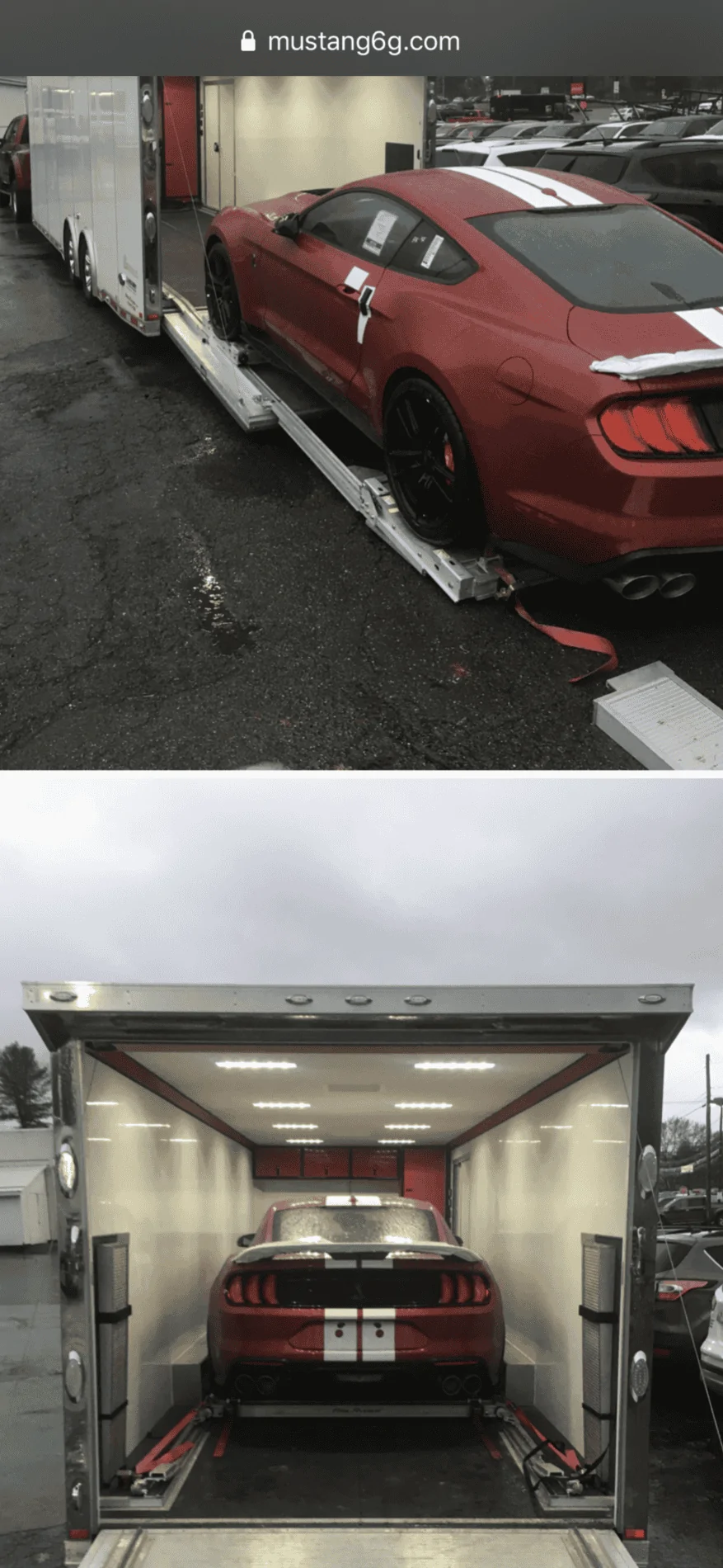

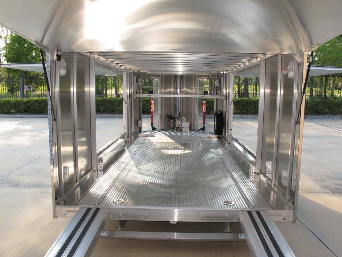

There was another post somewhere on here that mentioned the Rail Ryder system.

I remember seeing this one, and this is when I decided I want that option. I would love to know the brand of this and the specifics and where to get one.
My understanding is Rail Ryder is the brand. I googled it and found the website railryder.com. From looking over the website it seems as though you have to put your info in and they build you a kit to put in your trailer or they can build you a trailer if I remember right. Betting it’s gonna cost a pretty penny though.

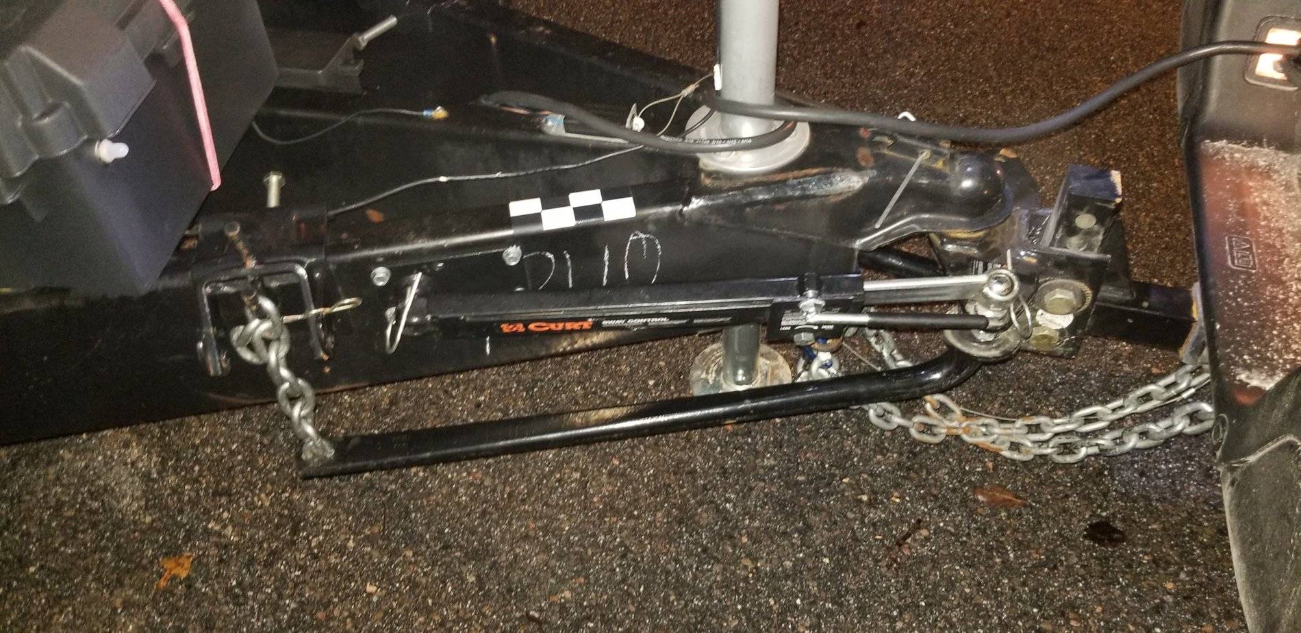

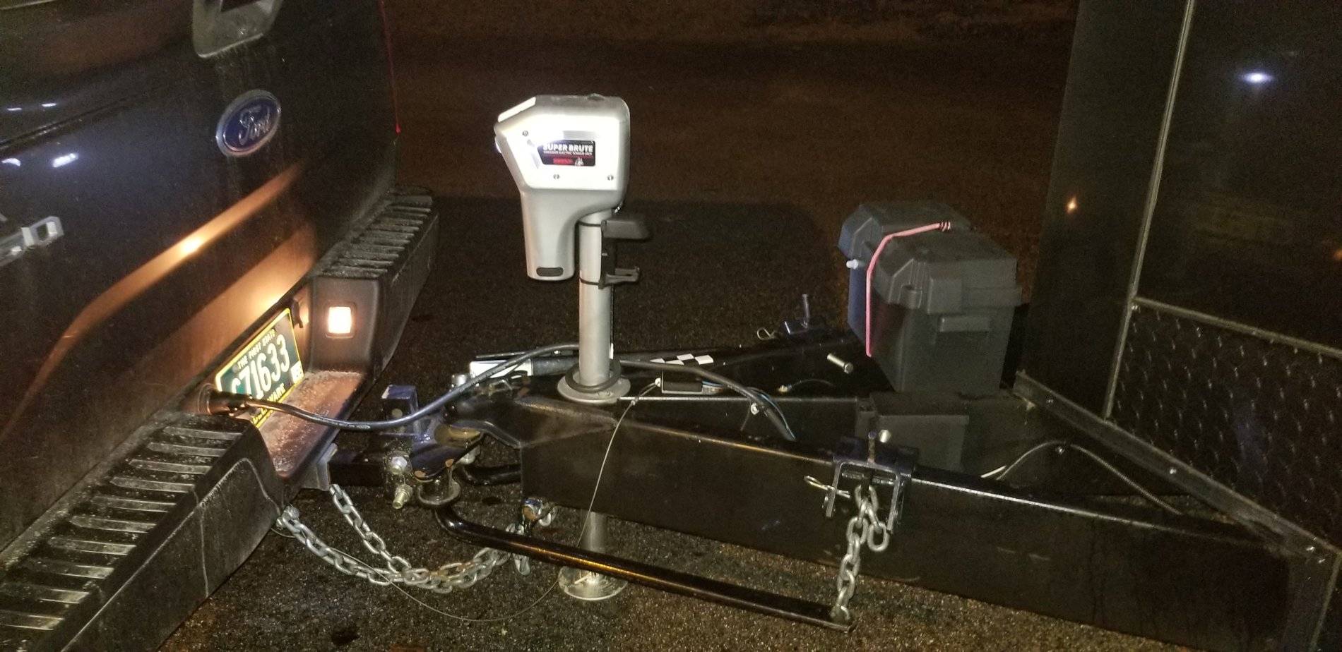

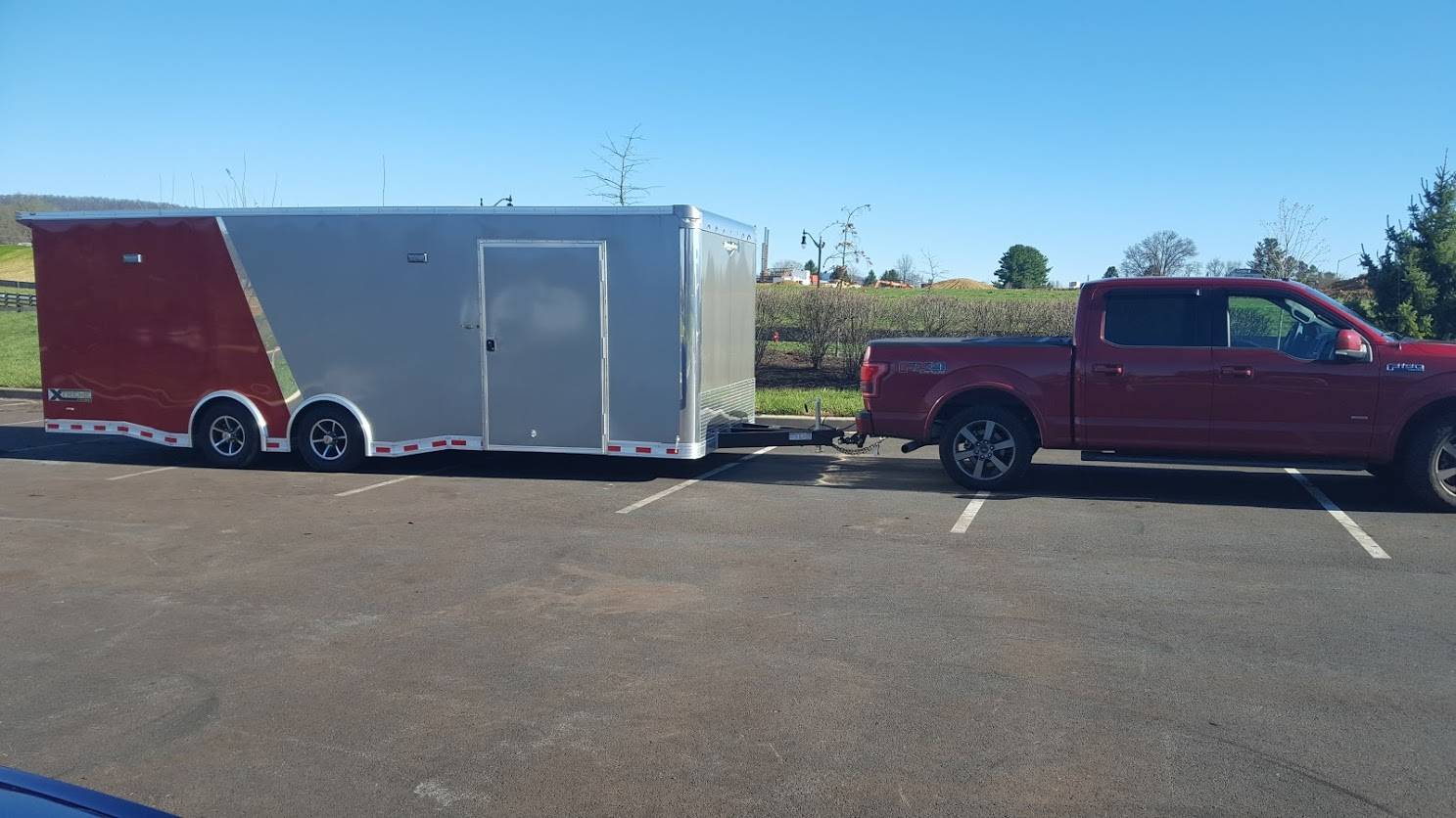

You NEED:
8.5ft wide
V NOSE
ETRACK
WEIGHT DISTRIBUTION HITCH +ANTISWAY BAR
ELECTRIC JACK
REAR AIRBAGS

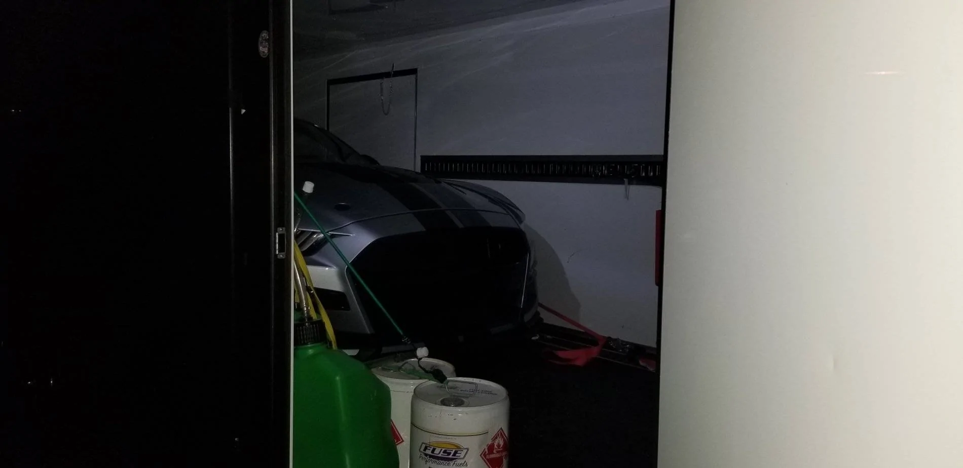

I just towed 12 hours with a 2.7 EcoBoost.
26ft +2ft V
This is more comfortable than any open trailer ive used thus far, except for aluminum tilt trailer

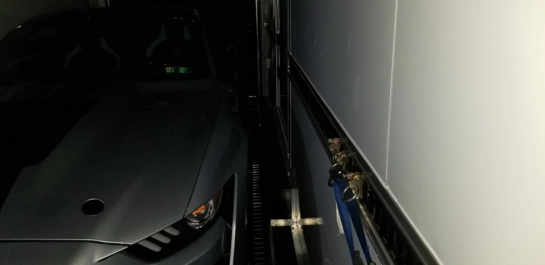

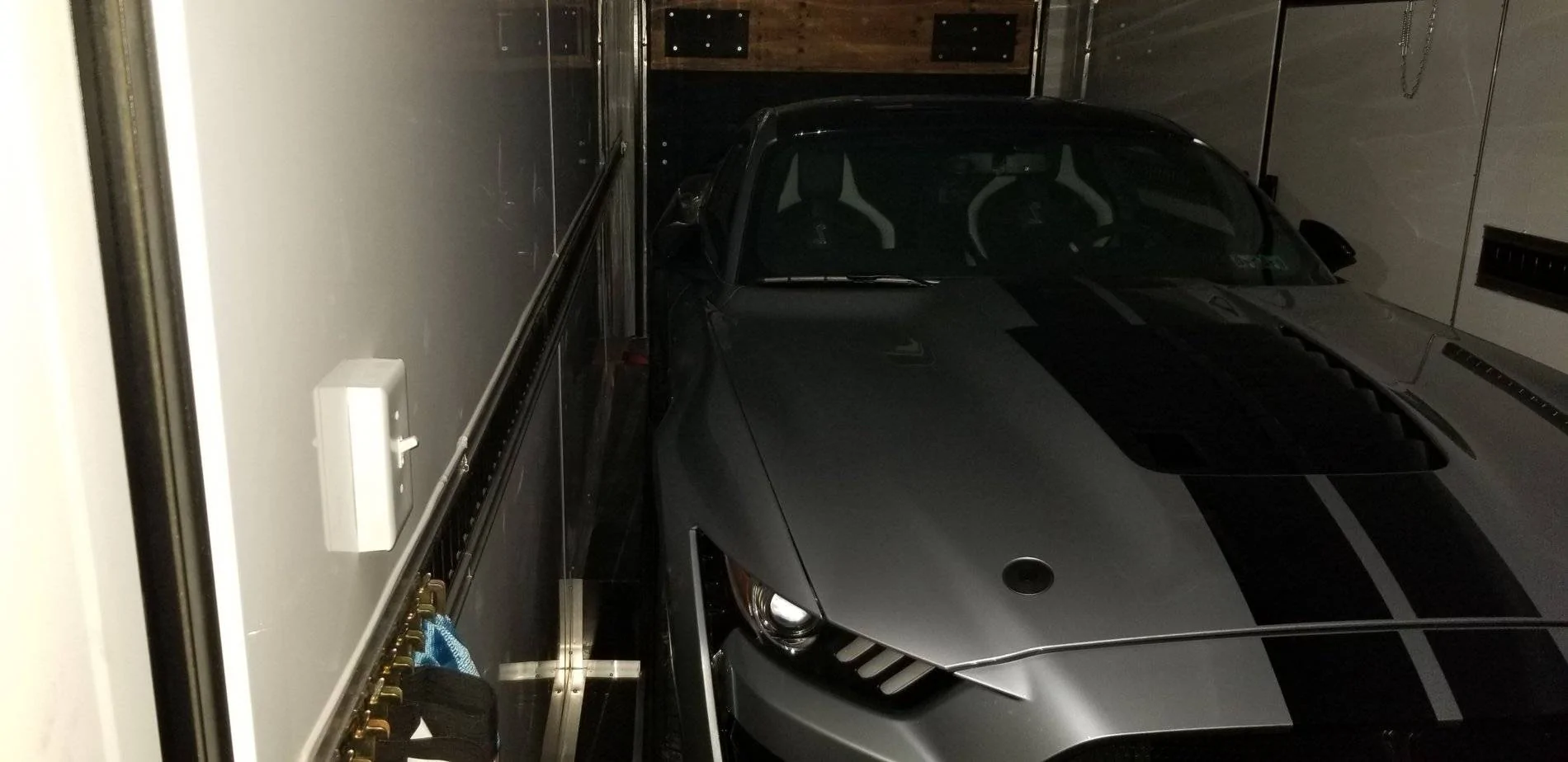

V00D00
Jan 27, 2015
73
2,642
2,167
Dover DE
2020 GT500
Ill take better pics to show how tight it is tomorrow...
Wasnt supposed to have precipitation yesterday or today... hoping the track can come around so as to not have wasted 12hrs, 24hrs really, of my life..

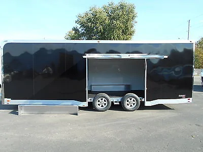

Get an ATC with full Escape Door
I have been researching these. I need to stick to 100% aluminum construction to keep the weight down, but I may still consider this one.
