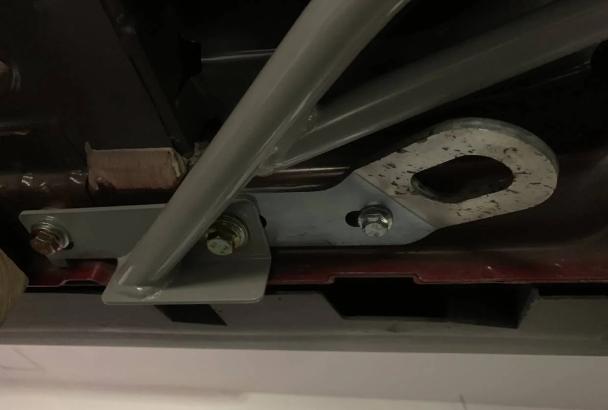

There are some that are comfortable going through the carbon fiber wheels. I myself am not one of them. The Ford chassis strap points are a much better option in my opinion. I have them on both my reg 350 and my R. I have an ATC trailer and as long as the ramp extension is, I still need ramp extensions so the splitter doesn’t hit. Hope it works out of the CFTP!

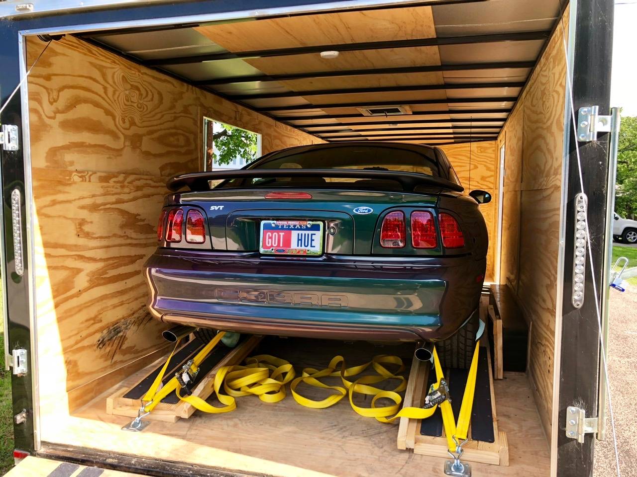

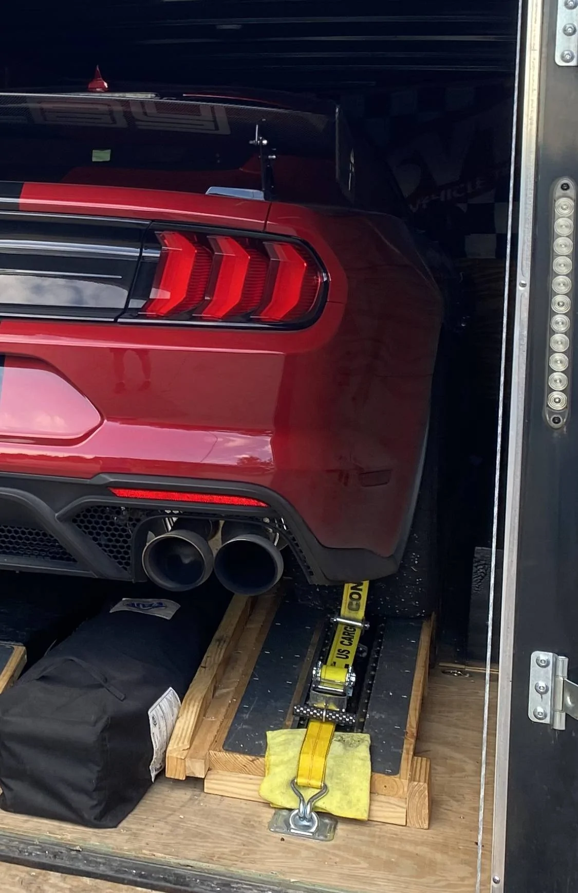

Yes, I trailer my CFTP a lot! I just did it again yesterday for another track day. I used to run straps through the wheels… it wasn’t an issue as I used protective towels to prevent any marring. I have since added e-Track and go over the top of the tires. I much prefer this setup.
Also, these cars are LOW! I bought trailer Race Ramps to keep from scraping the splitter. They work like a charm!
My old base model coming home from the dealer:

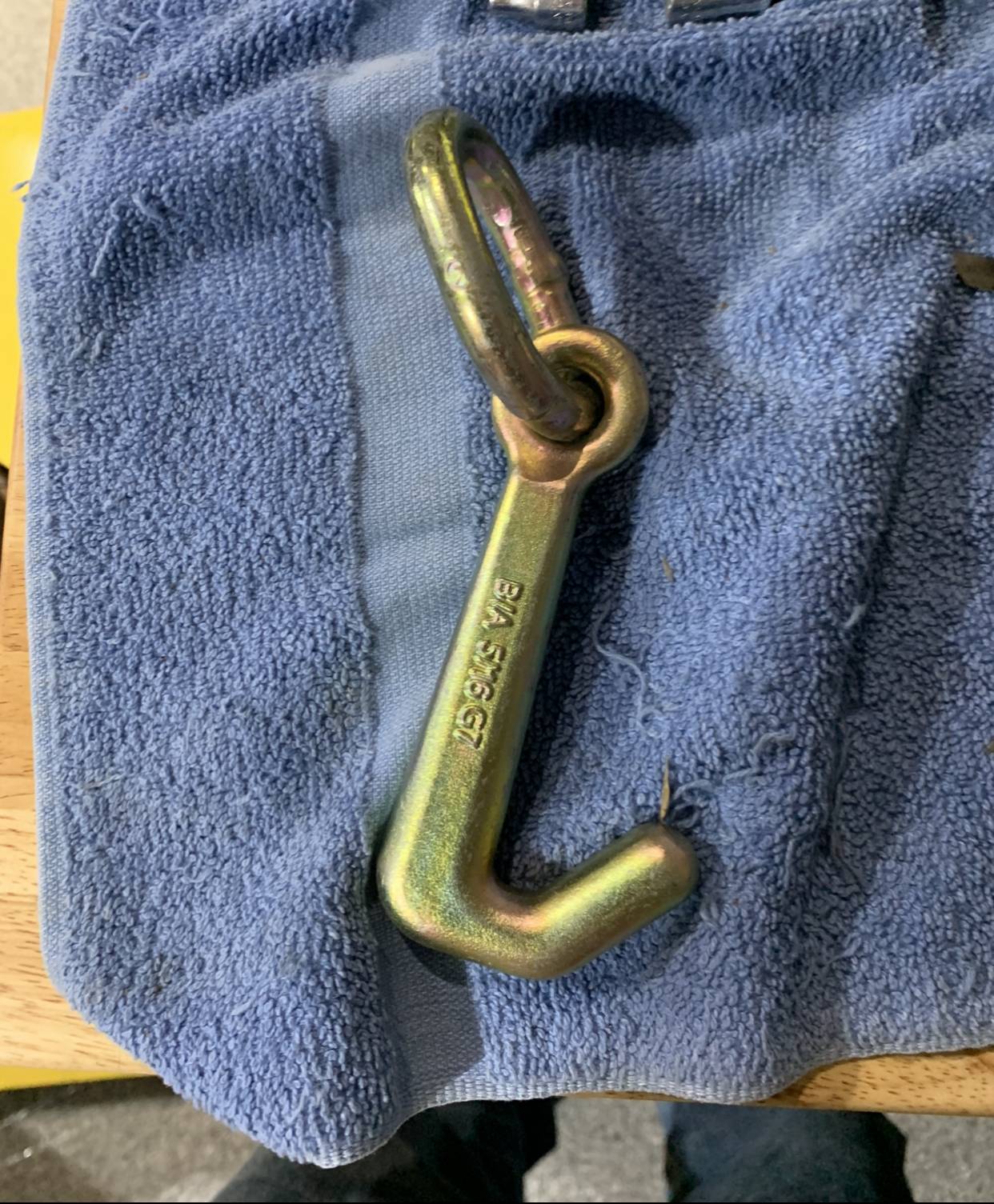

You need these J-hooks from Mac.
On either side of the car inside the wheels are ford tie down locations that the J-hook fits in. Mac made me a pair on straps with the J-hooks.
For the rear I purchased the ford tie down hooks.
The ford hooks are for both front and rear. So if you can’t get the J-hooks from Mac get the ford tie down hooks or both.

Everyone is spot on with their ideas on this. Using the wheels as mount lint is fine but use something to protect the wheels. Those J hooks will hook directly to the frame. And the Ford mounting brackets work great. That’s what I use now on my new Futura trailer. Those over the tire ones are amazing but there isn’t much room between the fender and the wheel up front so that’s why I don’t use those.

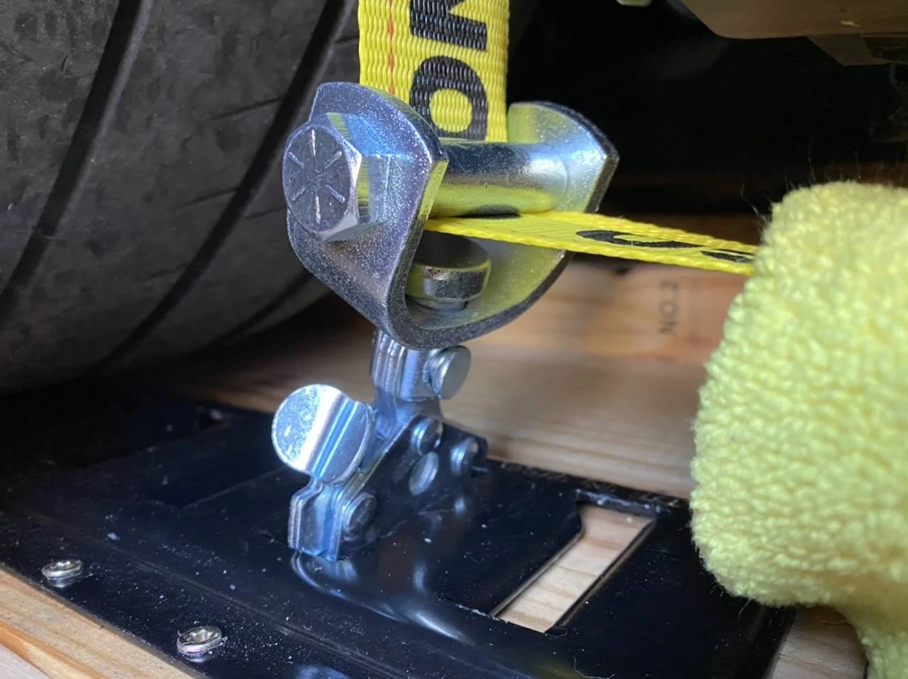

I have 4 of these that make over the top of the tire possible with these low cars:

Used the M-1700 brackets. Put all 4 tires up on 4” rubber ramps they had at the dealership. Installed all 4 myself in about 15 minutes. Could have done it without the ramps but it would be a squeeze. Brackets worked great with the longer MAC straps that come with the over the wheel set. Luckily I had thrown the over the wheel set in the trailer before leaving. Straps are about 3’ longer with these which is necessary due to the bracket locations (behind front tires, in front of rear tires)
