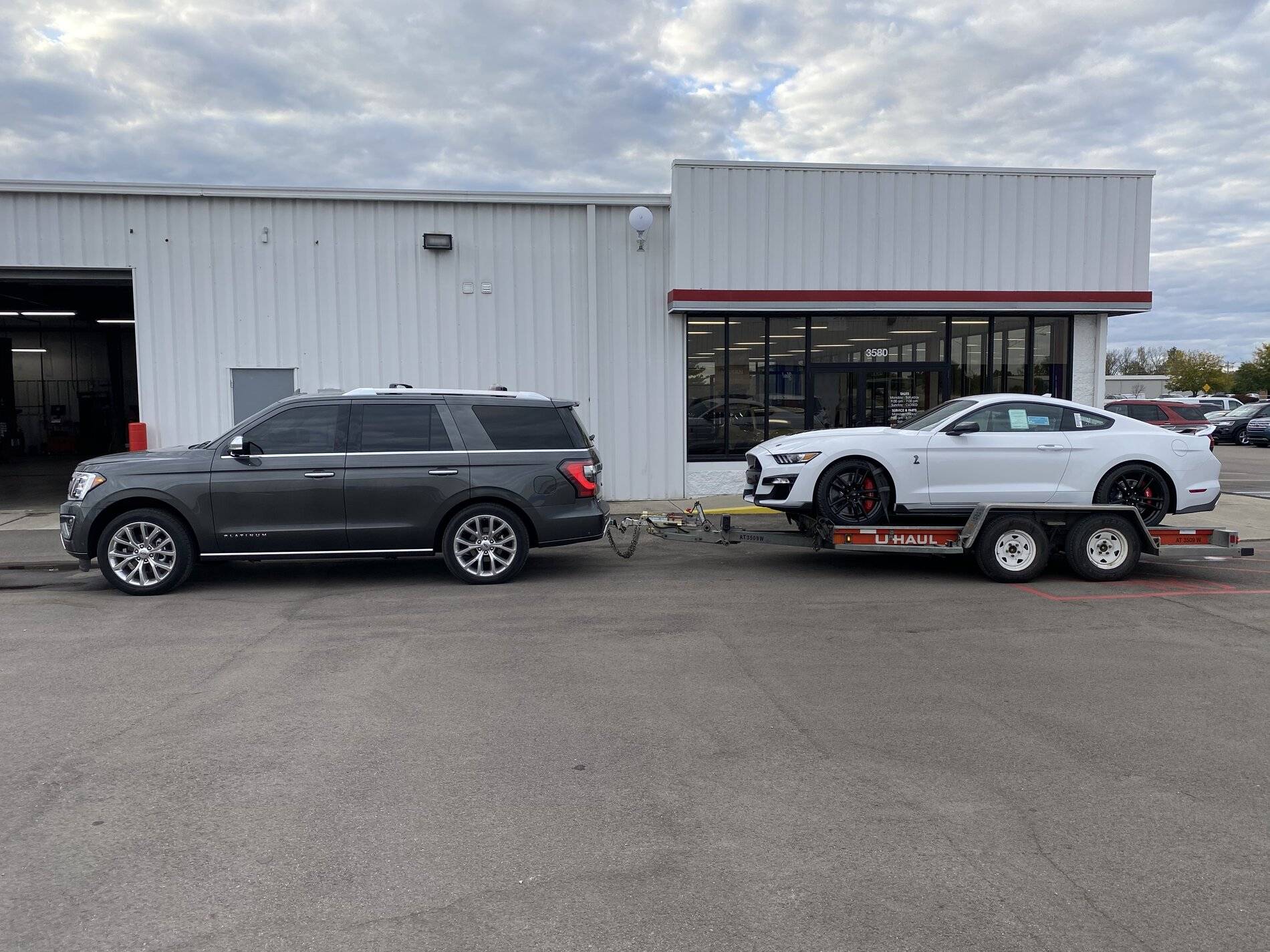

I hauled mine home from the dealer on a uhaul trailer. Had to cut 2x10 boards and let the car sit on those to get the front end over the front stops on the trailer. That was before I installed the splitter but if you had to stack 2 boards I think that would work too. Also raise the front of the trailer as high as possible when loading the car for lowest approach angle.

As other said, it fits on the U-haul trailer. I did not have the splitter installed, and I put 2x8 wood under from tires for enough height to clear the front of the trailer. I do not think I could have double stacked the wood, because there wouldn't be enough strap length the reach the wider-upper.
Sorry about the sideways video, my son was recording and didn't know better.But you get the idea. This was December 2019.
