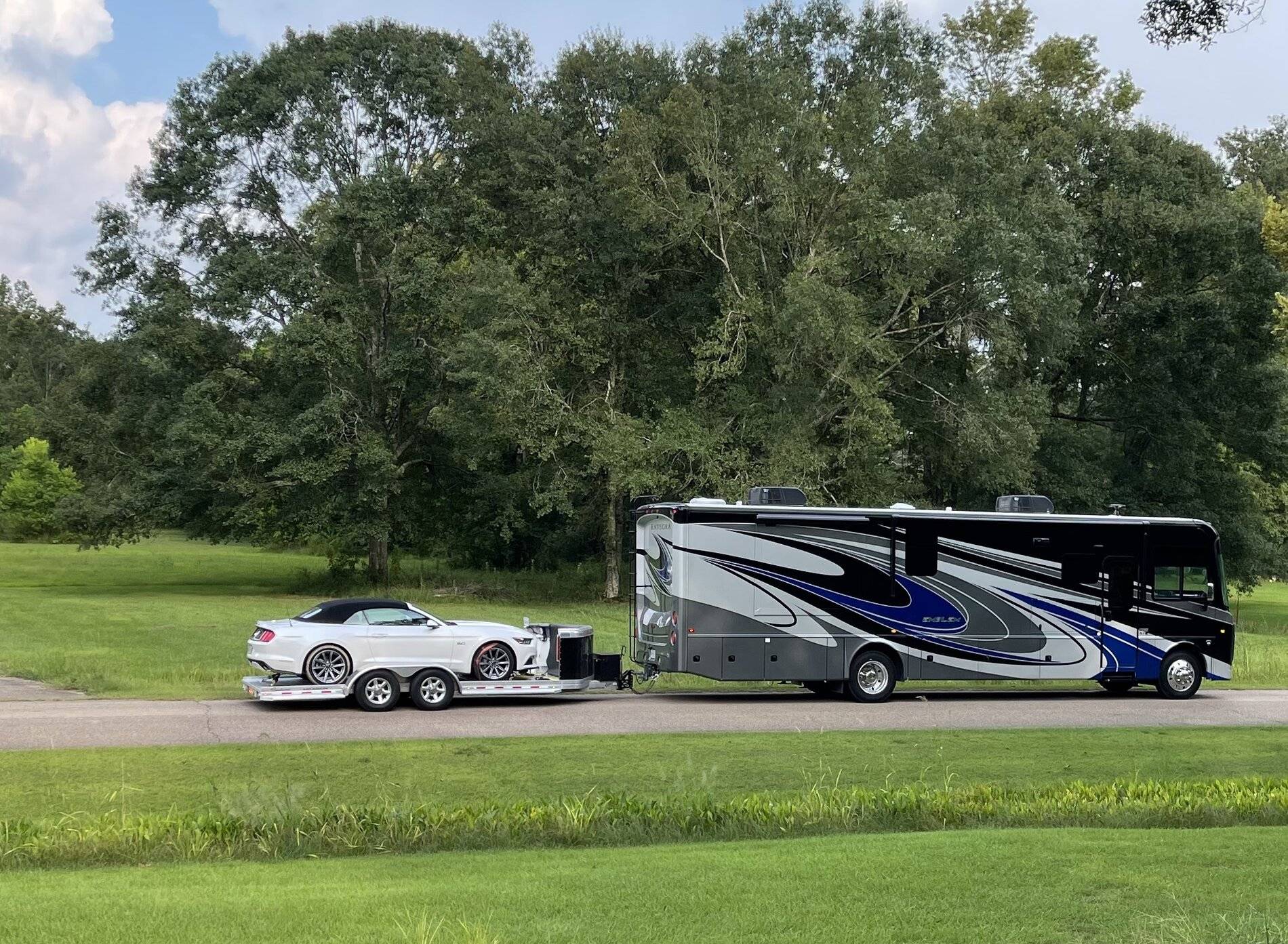

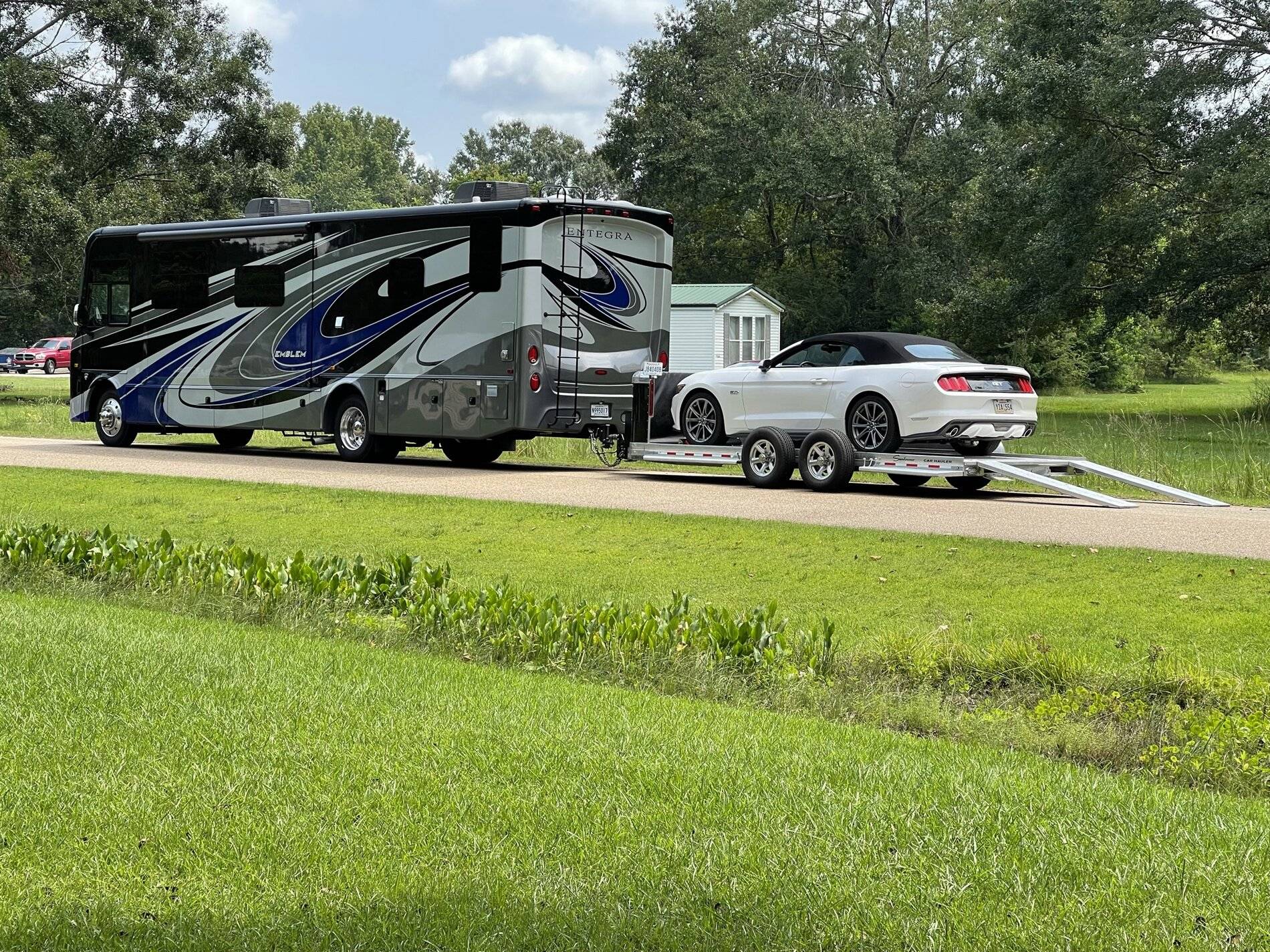

My 2017 GT Premium convertible has been my “garage queen” for the last 4 1/2 years. I’m hitting the road with it soon. It will be carried by a 2017 Sundance Ultra 22 with 6 foot ramps. The only issue is I had to place it against the right side of the deck, and in a certain position rearward, in order to open the door between the left side tires to facilitate getting in or out.

Looks great. Can also use a 2x12 under the front driver tire to get that extra clearance. Then you're not off centered with the tow.
