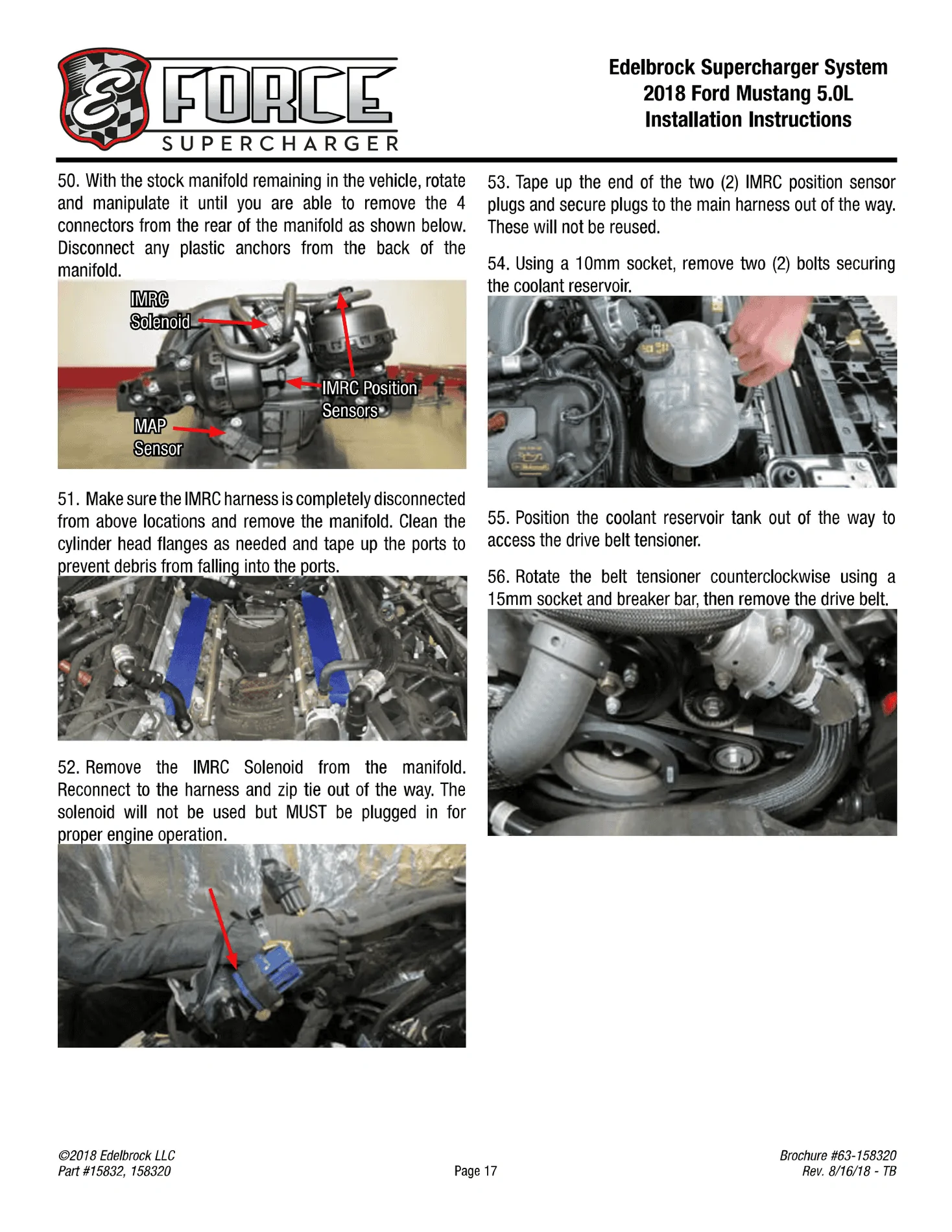

So he has a 2019Gt PP1 totally stock. He got the edelbrock stage one with tune kit installed by ford. Everything has been checked mechanically. all pins checked on harnesses. Car has been flashed back to stock and then reflashed back to tune. Files have been sent back and forth. tuner hardware is up to date. Problem is car wont run right. It starts, it does ok if you slowly get it up to speed but if you try to give it any gas and the vacuum drops to 5 it simply stalls out and lunches and just wont run. We been back and forth with edlebrock and they are now looking at the bef file. But initially they said they dont see right off what is wrong. It feels like its not getting fuel but we have been assured fuel delivery is not the issue. The nitrious pill or what ever its called is in there we were asked to check... has anyone else had this issue? any ideas? they will be getting back to him tomorrow but im just curious if anyone here had anything similar happen after install. Ive looked and looked all over the net and cant find anyone else that seems to have had this issue. the mechanic at ford has double checked and rechecked the install and is 100% behnd it is correctly installed.
We get no check engine light or error codes on the car either... its a mystery. we feel it is something with the tune or maybe something wrong with the flasher that corrupted the tune?
Again not crap talking eldebrock its a nice charger and they are bending over backwards to help. just curious on privet party input. Never know what info might help.
I'm assuming the imrc solenoid was plugged back in? Page 17?

There is nothing for the IMRCs to plug into though, once the old intake is removed. They should be empty and taped up out of the way.
The IMRCs are turned off in the tune.
I'm not sure if they are or are not turned off in the tune. Maybe the solenoid is plugged in for some other reason.
I simply stated what they asked for to be done in the instruction manual. See below:

Interesting.
I have a 16 and nothing gets plugged back in. Sorry to mislead you...
No worries brother we are all here to learn. Apparently it must be plugged in on the 18+ models.

Yea I see that. I just checked the manual for mine to double check and nothing gets plugged back in older models.

Thank you to those who have answered so far to my questions. we send a datalog to edelbrock today. and its back at the ford dealer where they installed it. its been checked and checked from the installation side and we are assured its installed correctly. I mean its pretty clear on page 17 what to do with that sensor so. I would assume he done it correctly.

I forwarded the info about that harness on page 17. heck never know :)
