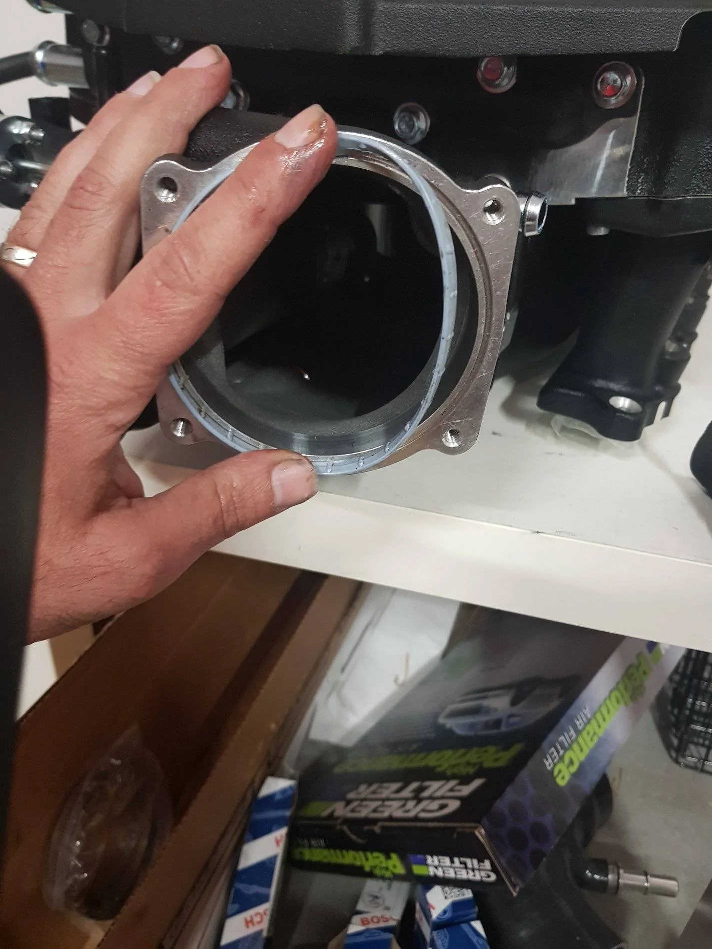

Don’t stress about the O-ring. They’re entirely reusable. something I should mention though, specific to RHD cars, is the fuel line. I’ll throw some pics up for you tomorrow. You’ll probably need to grab some bits to make it work properly.
Not sure if the photo worked. But that o ring is too small for the SC. Even if the diameter was correct the groove in the SC is not deep enough.
I'm intrigued about the fuel line. My kit has the 180 fitting and the braided fuel line. I removed the factory fuel line with the round plastic disconnect tools. Seems ok...
Yah, that won't work. You need the oring. Might as well have them send it in the same box as the brass sensor. I think mine was in the same bag as my plug for the aspirator.
My SC came with an adapter since i went stage 2 and i need 2 of those orings. They were in separate bags and they are very thin. I almost missed one of them so open every bag to be sure.I opened every bag into a separate container with the label taped to the lid and i still missed the o ring. They hard as hell to get from EB and i have a spare if all else fails. The vaseline of something similar is to help the SC move around.
Thanks for everyone's responses.
I contacted Edelbrock a few days ago in regards to the brass sensor. I gave them my address in that same email. I got a response back asking if I had a state side address or freight forwarding.
I responded back with a no and asked how to proceed. Waited 24 hours and got nothing back.
I sent another email asking for confirmation and it's been 24 hours and got no response.
Now I may need to send them another email about the o ring. I just don't wanna be that guy!
If I can't get one I might have to make my own with a silicone gasket maker.
@Burkey did see my explanation re fuel line. I think mine is all good.
