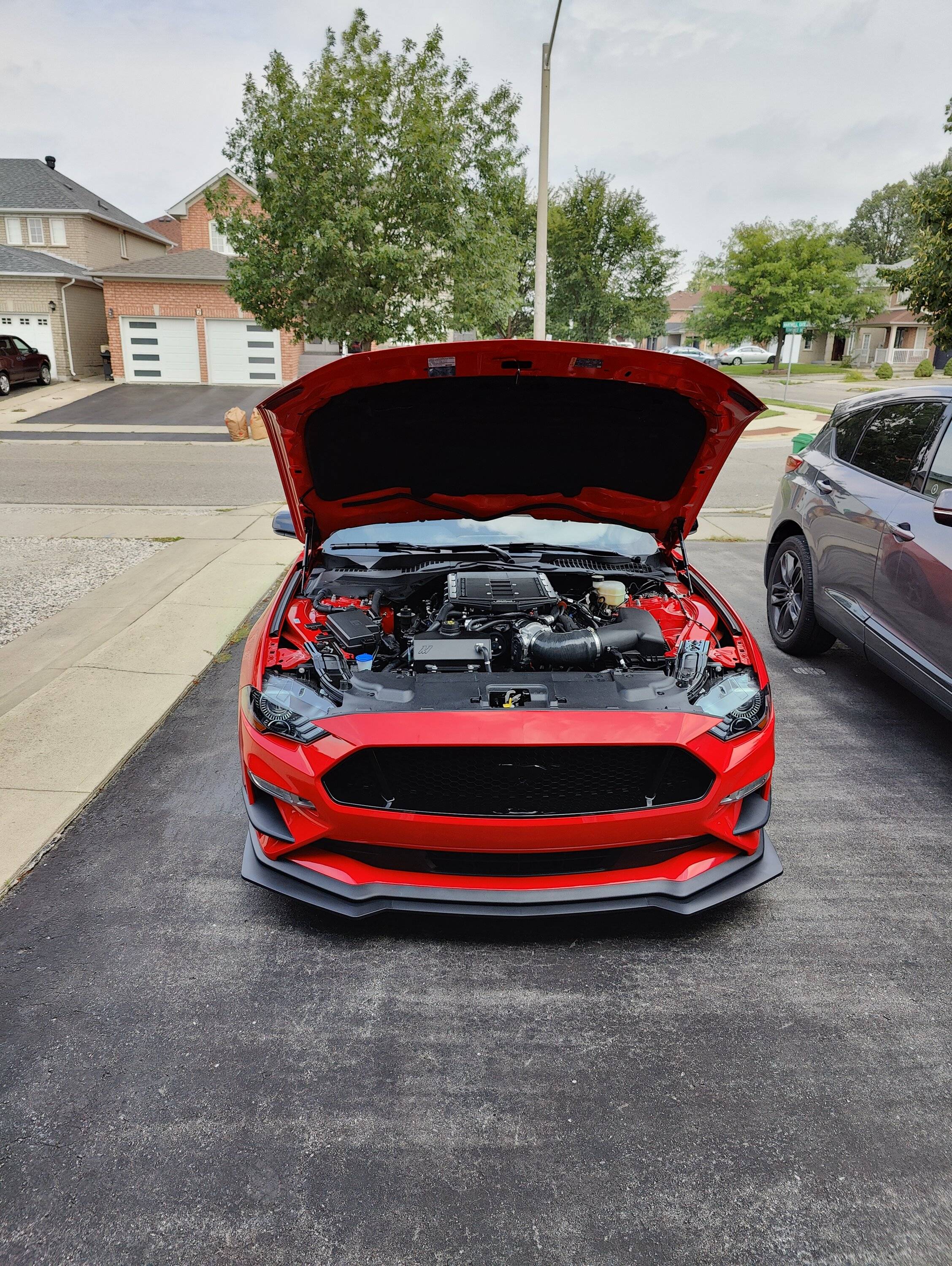

Quick update, got my intial start up tune from Lund, car started up without any issues, idled fine and went through the process of data logging to get Lund the data they needed. Everything looked good so I was given the ok to do a few WOT runs from 2500-5000RPM. Everything seemed to run fine and sent the log back to them. Got my R1 tune and told to do the same WOT pulls unfortunately started raining here so won't happen until tomorrow. So far they like what they see and huge relief for me that the install was good on my part and the car runs smooth. Sound quality from the dashcam isn't the greatest. Thanks for all the help i'm sure its not over yet....

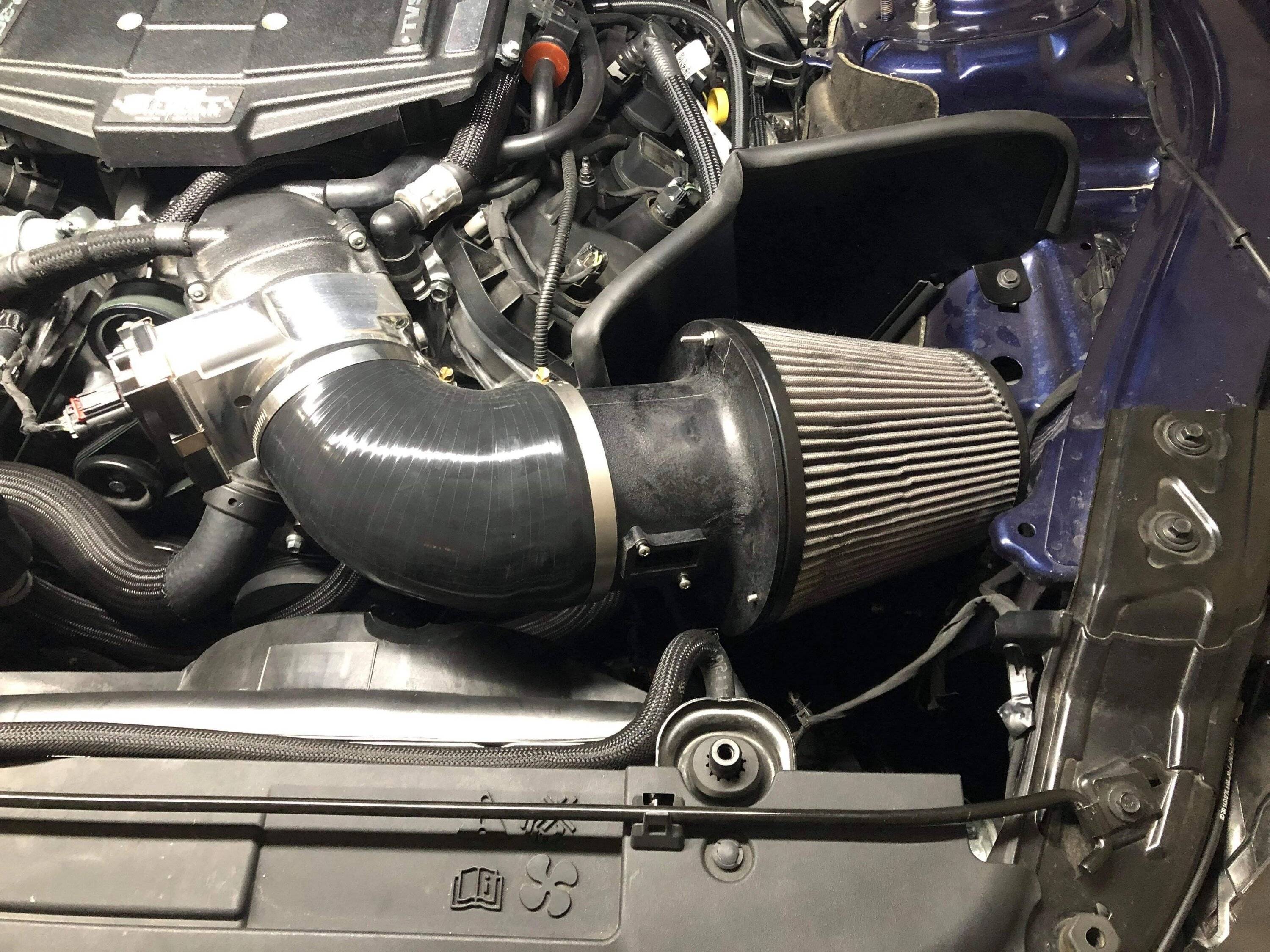

Has anyone tried the Bullitt or Mach-1 87mm digital throttle body with this supercharger?
Nevermind. I think that I found the answer to my question. Juggernaut Performance makes a modified PMAS solution with a 120mm MAF housing to connect directly to the Edelbrock 103mm throttle body. I can make the throttle body opening connect to the 87mm unit without any leaks.
Jn2ning Edelbrock PMAS 120mm Intake Upgrade Kit | Juggernaut Performance Inc. (juggernautpower.com)

So let me see if I'm reading this correctly, you are using the PMAS intake made for 103MM throttle body to work on the stock 87MM throttle body? If so I am interested knowing more about it. Did you have to retune?
