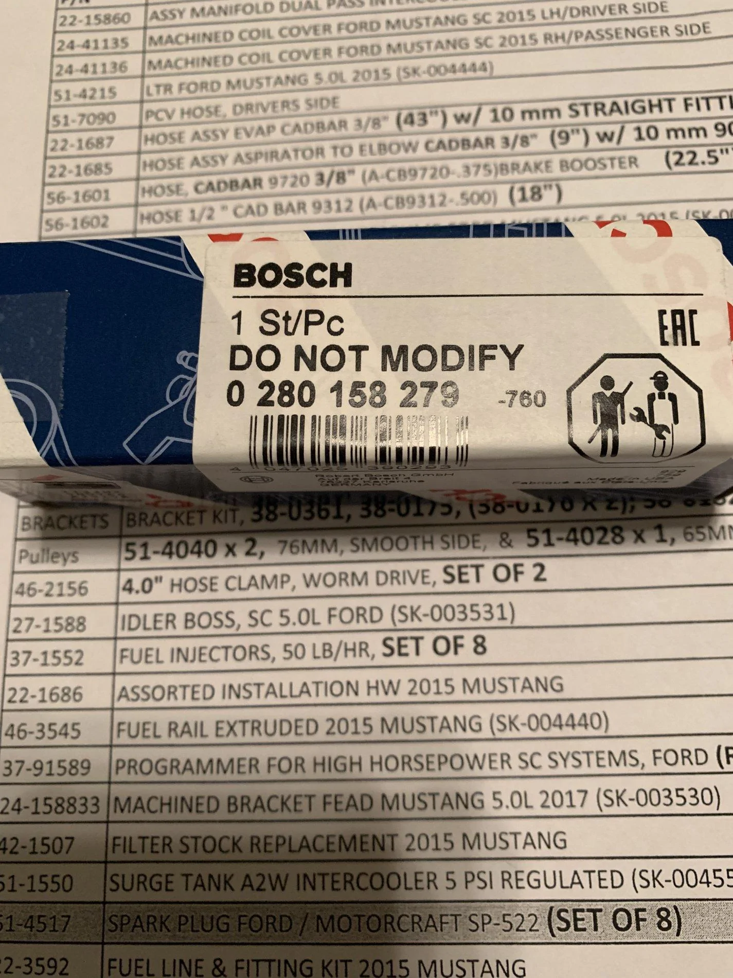

The injectors in the kit are the LU47s. Make sure they (Lund) knows that. The injector rating is depended on the fuel pressure.I talked to Lund and I have to get new injectors first, they don't tune the Bosch 50# that came with the kit.

Craigj also got bosch 50lb injectors in his kit. Mine were lu47s. Maybe thats why his edelbrock tune ran like garbage?The injectors in the kit are the LU47s. Make sure they (Lund) knows that. The injector rating is depended on the fuel pressure.

Should be the same injectors whether they come individually packed in Bosch boxes or the Ford Performance packaging.Craigj also got bosch 50lb injectors in his kit. Mine were lu47s. Maybe thats why his edelbrock tune ran like garbage?

whereas mine are definitely LU47s, in ford racing box etcYep there the ones that came in my kit too.
Even states 50lb in the EB paperwork.
This is the spec on Bosch website
https://www.bosch-motorsport-shop.com.au/547cc-min-ev14-injector~4308
