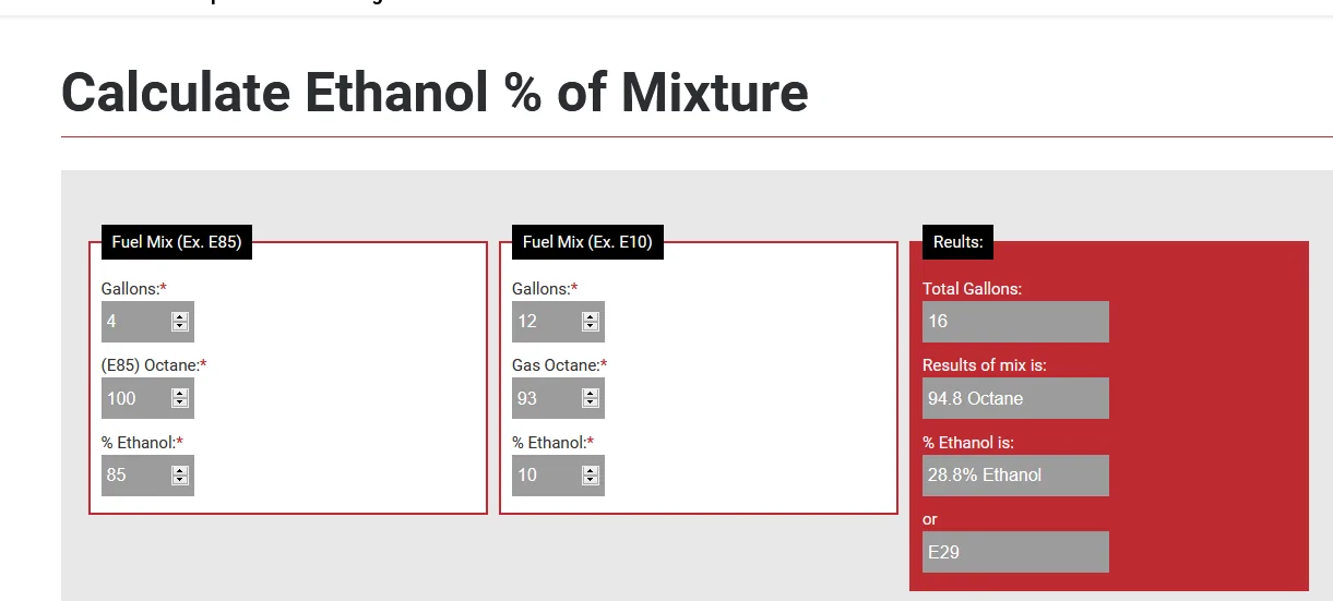

I told him that unless he's not tune for it he wont see any perfomance and I dont think that's healthy for the engine.
Neither of those are really concern with this low of a blend. As you can see below, this is around a E30 blend.
Also, modern computers are much more powerful than earlier ones and can self adjust for both ethanol and power (up to a certain degree). Alot of GMs you see are marketed as flex fuel vehicles, my old Jeep Grand Cherokee was one also and they could handle up to a certain mix.
And on the power thing, the computer constantly monitors knock and adds or subtracts timing based on lack of such. For example, the Coyote computer can add or subtract up to 10* of timing from its base tables. If you put in higher octane fuel, and the computer doesn't see knock, it will keep adding timing over base and thus you could see more power. It's not as good as a real flex fuel tune which adds timing more aggressively, but it's not completely useless.
