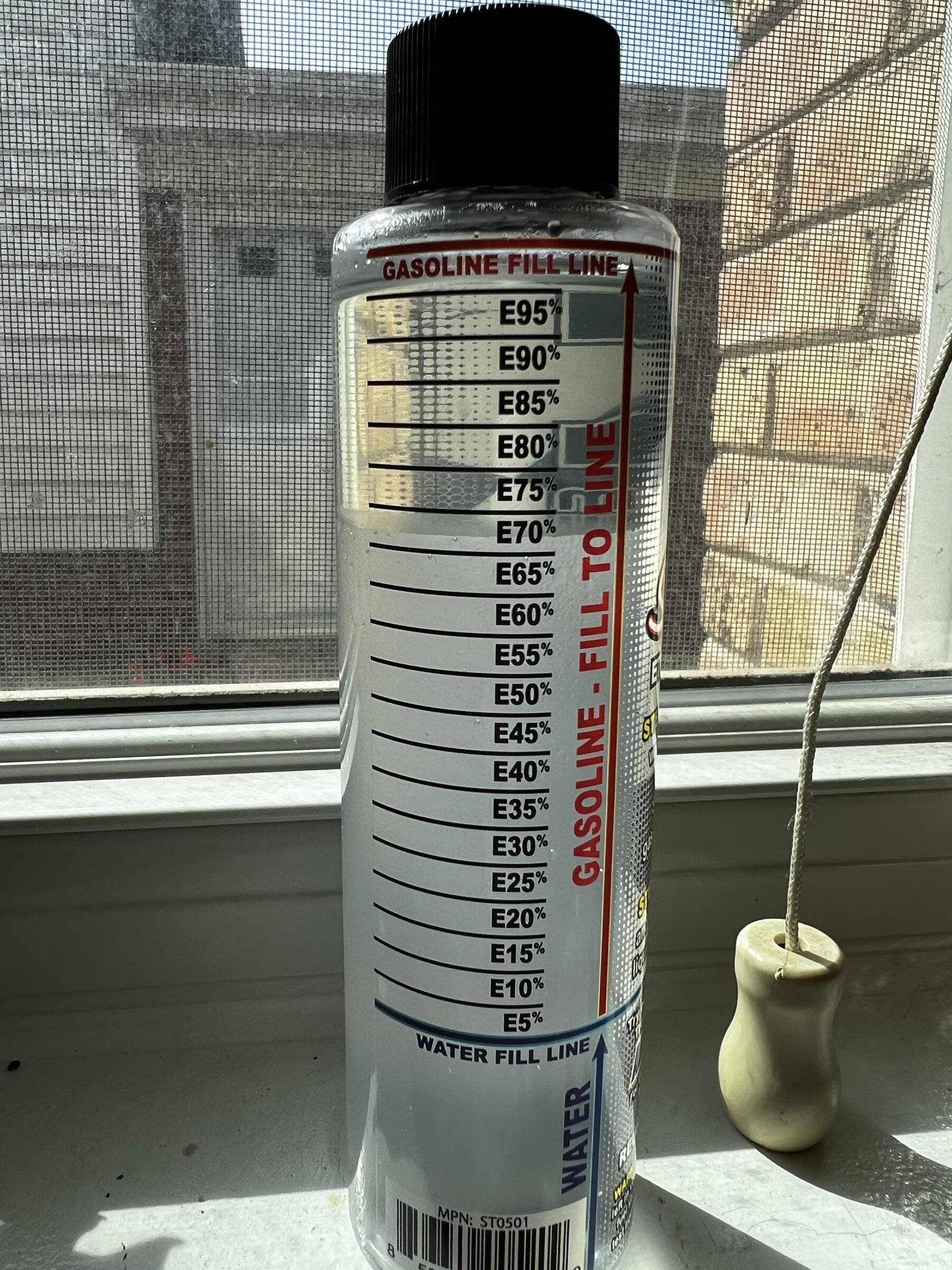

So I’ve been contemplating the PBD tune with a flex fuel tune but just not sure the quality of my E85 at the only gas station around me is good enough.
So I bought a tester bottle off Amazon and here are my results.
Is barely 70% ok?

All of the stations local to me read this low most of the year & car ran like a champ with a e85 tune %100 of the time. Would only run 1 tank of 91 per year, rest was always Ethanol.

70% ethanol would be perfect for a Flex Tune. That’s what I run most of the time and my ethanol content ranges from 62% - 85%. It really is hit or miss.

I can run as low as 64% on my Ethanol calibration. STFT’s are only removing 7% fueling. Still get full spark advance as well. 68-72% is my sweet spot…….

For a flex tune 70% is fine. Literally any % on a flex tune is fine, that’s the point of a flex tune.
On a dedicated E85 tune (non flex) I personally don’t feel comfortable under 75% E.

I’m with you there. My car is happiest at 70% ethanol content and above on the Flex. When I get into the low to mid 60’s. I can tell the car isn’t running quite as good.
