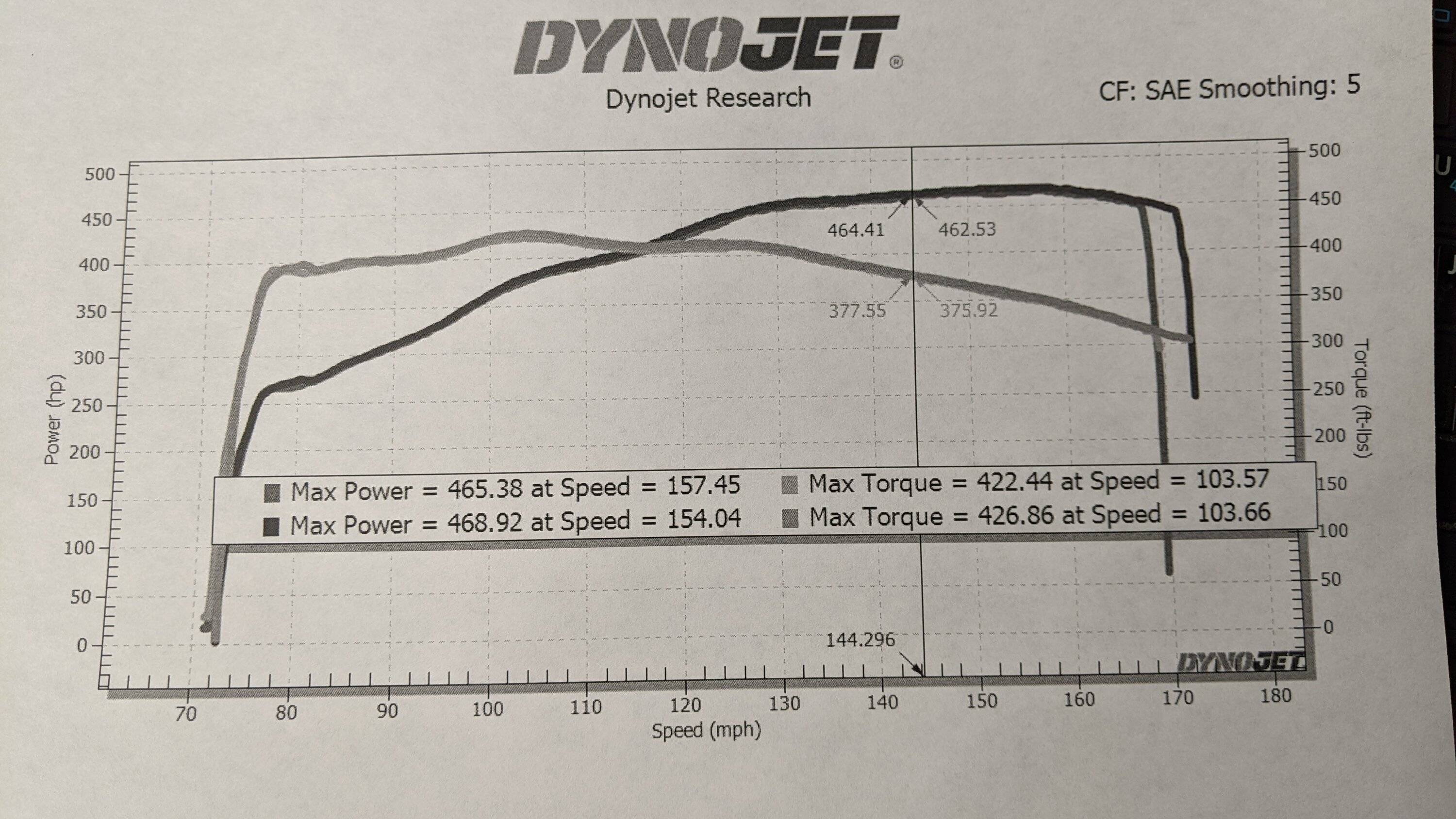

The e85 tune has been a blast so far. The low end increases have made traction a challenge (275/40r19 Nitto 555r2) but the smile factor at WOT is significant! I'm hoping to shoot for 11.0XX next month at a local track event.
I had it on the Dyno today.
