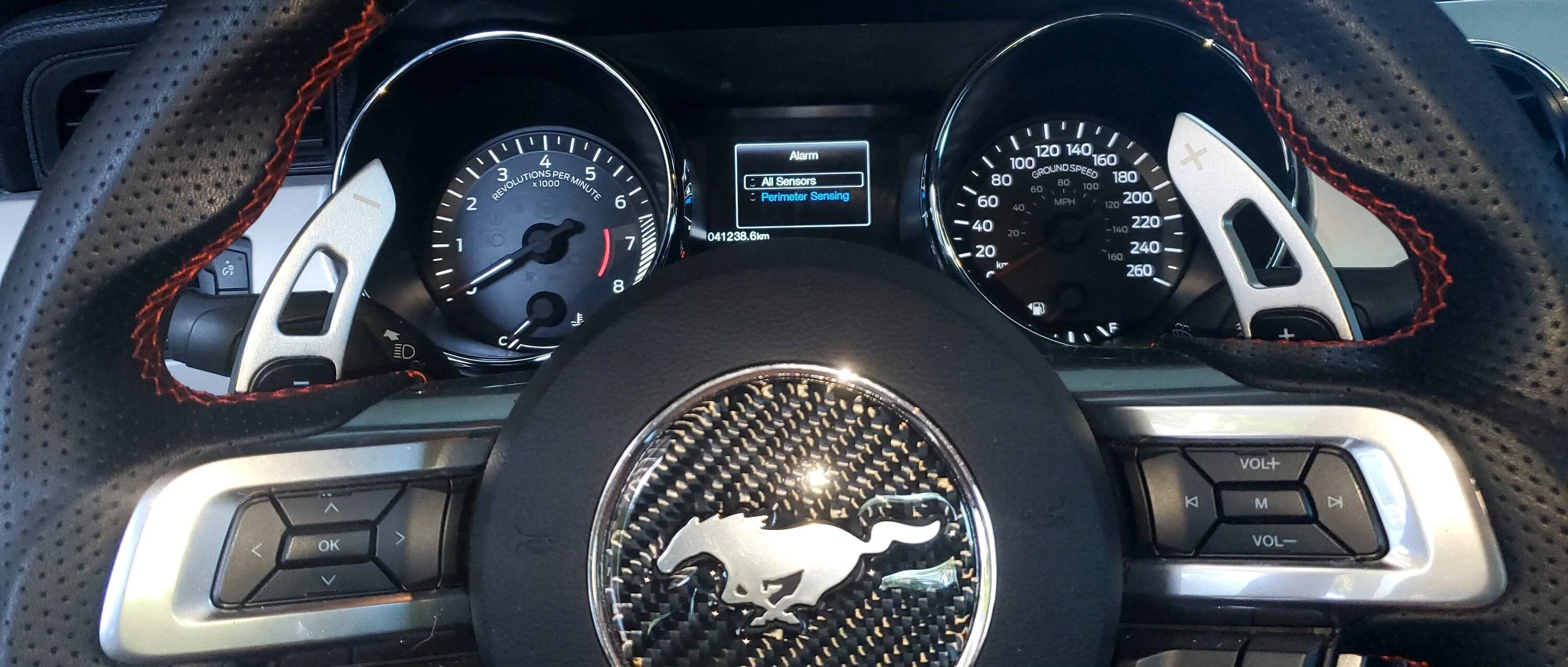

I noticed the same thing when I installed these but it was after I put in the new steering wheel as well. They won't make a connection up near the point.
Oh wow!!! Love the wheel.. I'm waiting on mine as well. =) The paddles look bada$$!!!!!!!!!
Yea it's a good look.
Just don't forget to to swap the counter weights in the wheel like I did.
Turned an easy swap into a time consuming deal
