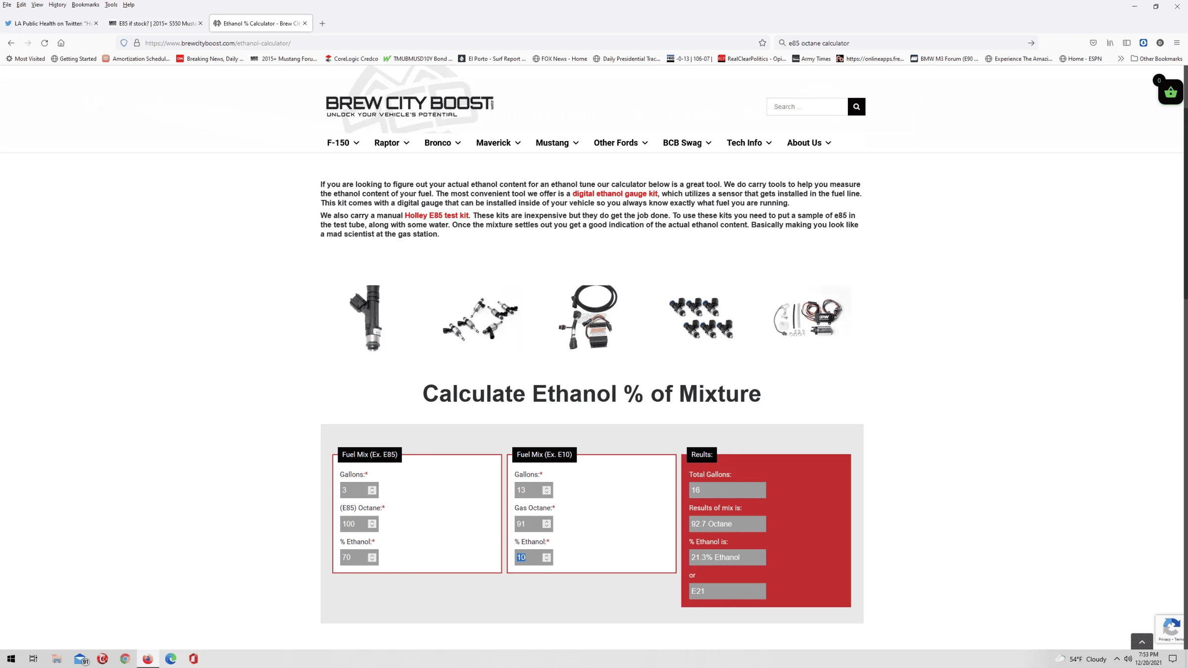

I run 2-2.5 gallons of E85 with 2 gallons of VP 101 and the rest 91. The problem is you are from Wisconsin and I bet your E85 isn't even E85. Colder climates normally get it down to 65-70% ethanol if not even lower. As Ethanol can cause cold start issues in cold climates. We are lucky here in Cali, as our E85 actually tests out to E85-87 giving us 105 octane per gallon. My blend gets me to 94 octane.
As the previous post said you can probably run up to 3 gallons which will give you E21, which is a bit more than the E15 Ford recommends.
