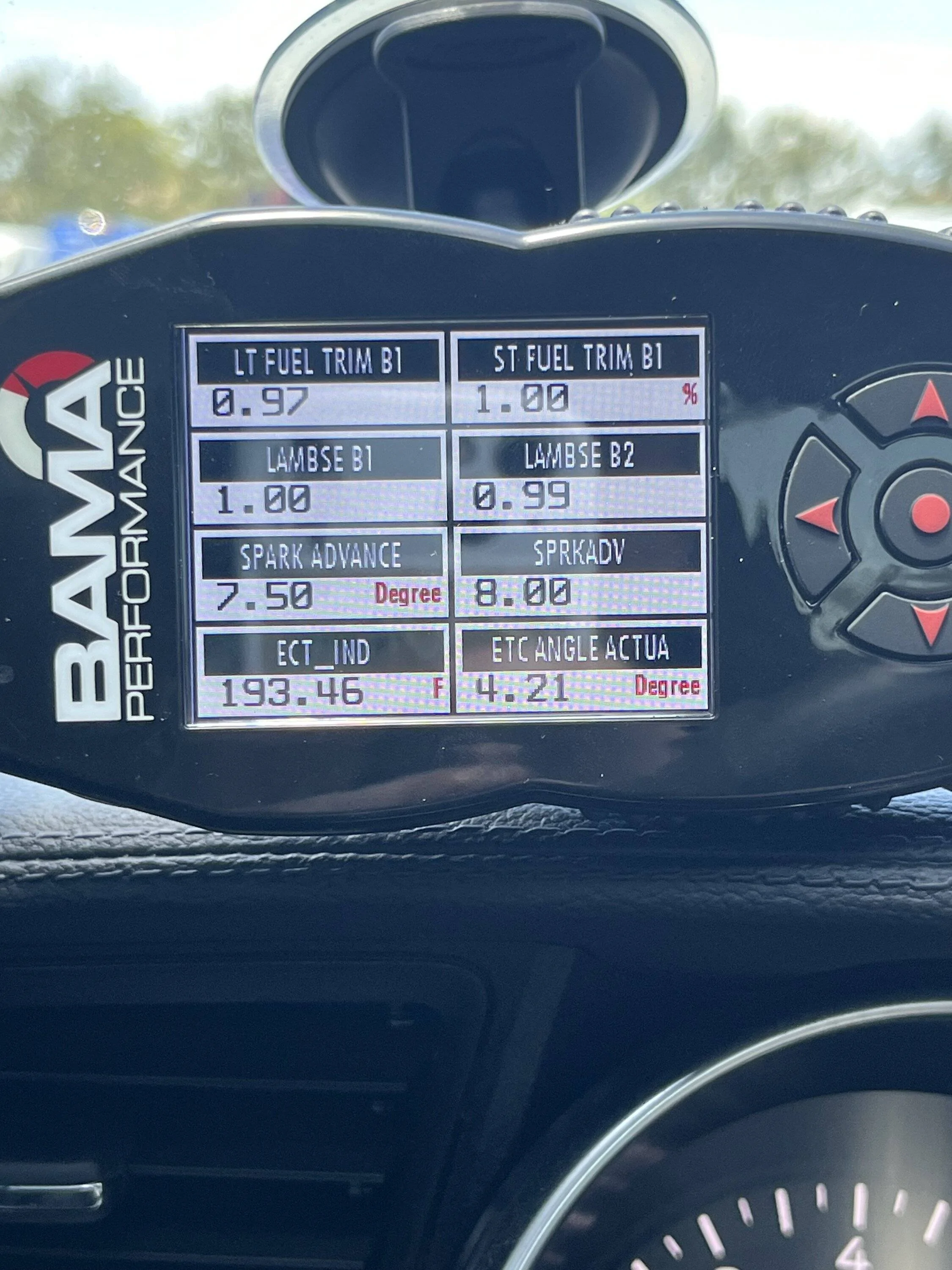

so am i good to drive until it’s empty and go back to 93
I would have to see actual logs to answer this. Looking at your video it appears it is running a bit lean 1.05 lambsa. It should vary from .98 to 1.02 or so.
Are you sure you are flashing the flex tune? If you can, pull up LTFT and STFT and put up another video showing those.

it is for sure a flex tune and i can when i got to lunch what are the ltft and stft on my bama tuner

They are long and short term fuel trims. That will tell me more of what is going on with your car.

B1 and B2 You should be able to select these from your Bama tuning device. Replace spark advance and AFR with the LT's and ST's keep lambsa.
