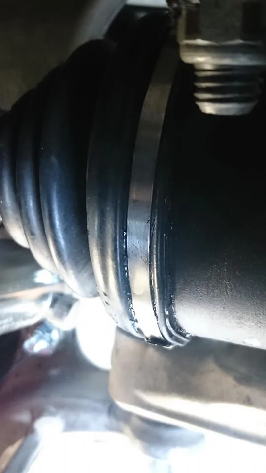

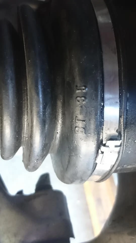

Mine is leaking, but appears to be from around the band clamp. I don't see any tears otherwise. Unless DSS steps up, I'd steer clear.

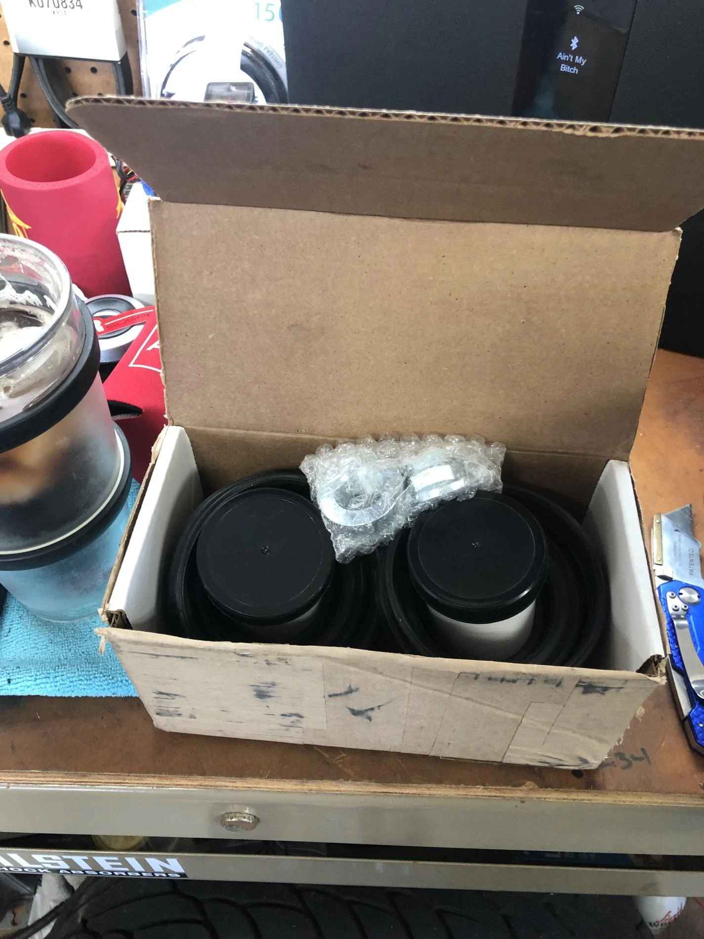

Boots, 2 small and 2 large clamps, and grease arrived today. No nuts though. Weird how you got nuts and no clamps, i got clamps and no nuts.....

Got the new boots, grease and nuts but zero clamps. Well hell
Next guy that gets replacement parts is going to have the nuts and clamps but no boots. What a clown show.
