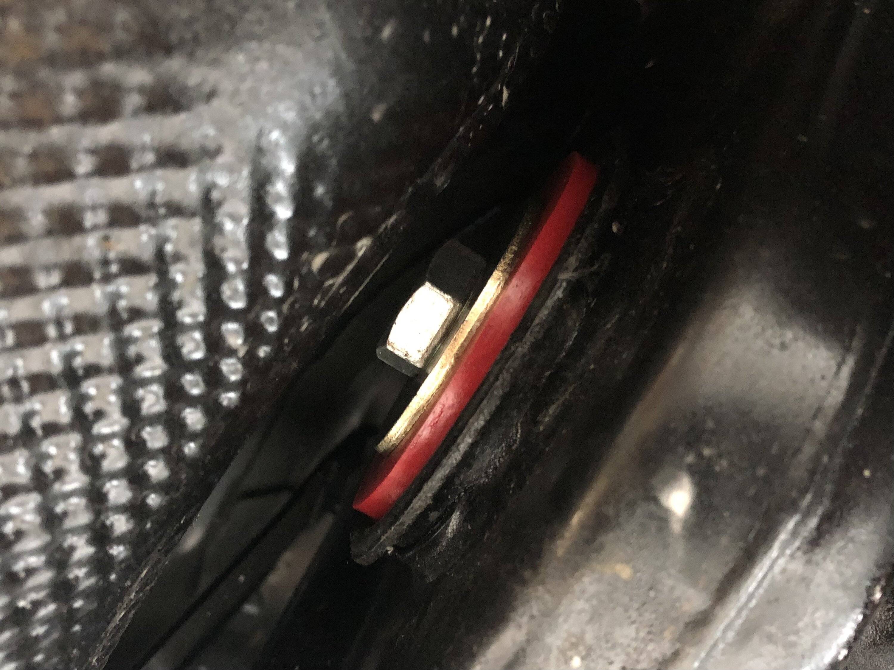

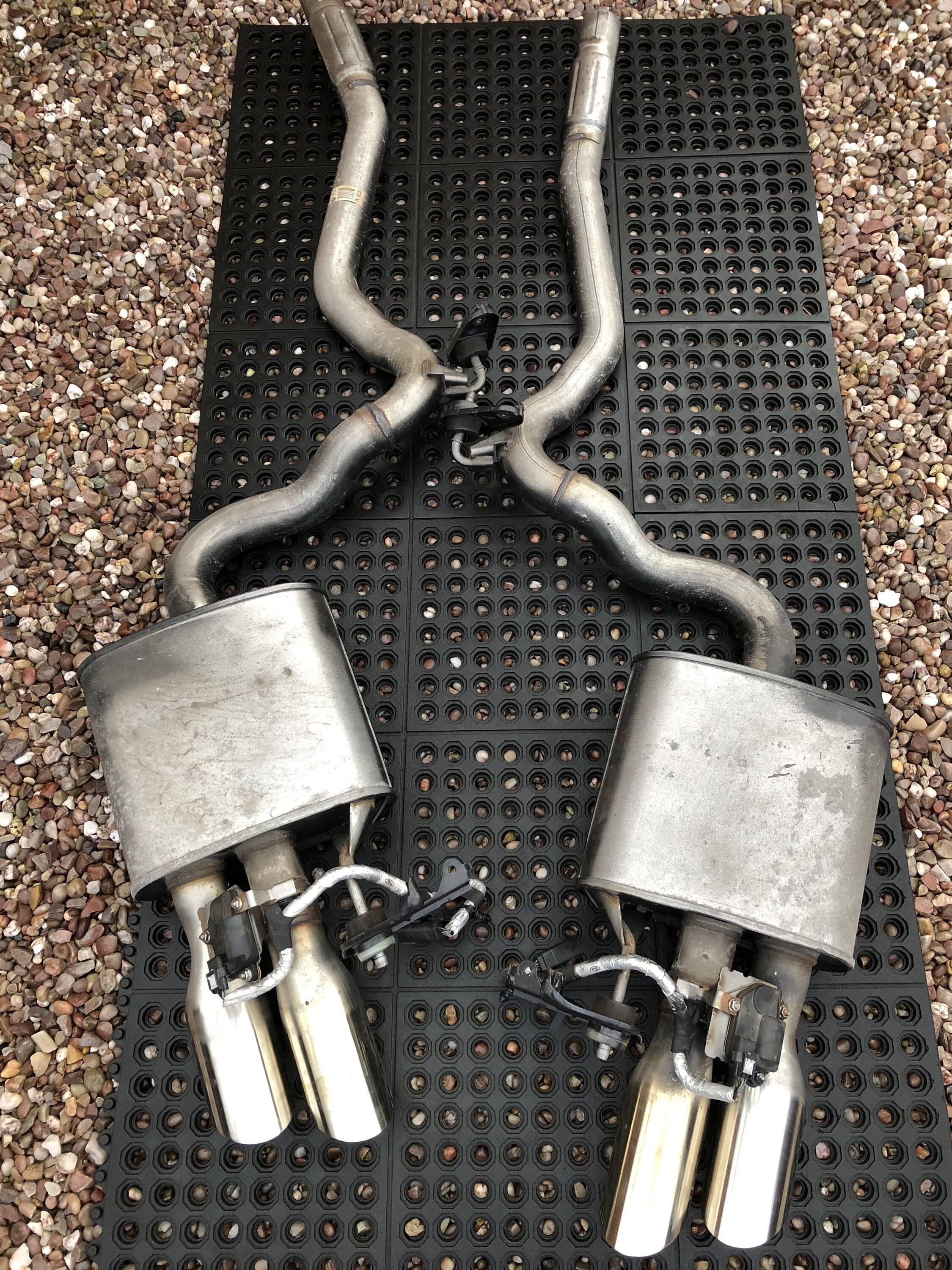

Yeah to confirm, here’s how Ford dropped my exhaust i.e. complete with hangers and loom :
Front diff bushes in my 20 don’t offer much clearance :
I’m guessing the subframe needs dropping a ‘reasonable’ amount to give you enough room to install without marking up the heat shield.

Thanks for the info! :like: Looks like an easier way to deal with the wire harness.
