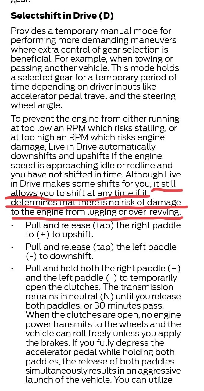

Of all people, Tim, I take what you have to say seriously. Is that written somewhere? If there was an issue, I need to point to something official in writing.
The manual doesn’t specifically mention it in the M shifting section, but it is discussed in the Live paddles section:

SelectShift in Manual (M)
• Provides a permanent manual gear selection where full control of gear selection is required. Manual does not automatically upshift even if the engine is approaching the RPM limit. It must be shifted manually by pressing the (+) button.
• Pull and release (tap) the right paddle (+) to upshift.
• Pull and release (tap) the left paddle (-) to downshift.
• Pull and hold both the right paddle (+) and the left paddle (-) for a temporary neutral position. Neutral (N) remains until you release both paddles.
• Pull and hold the right paddle (+) to command the transmission to sequentially upshift to the maximum allowed gear.
• Pull and hold the left paddle (-) for the lowest allowable gear. This is only available in Normal and Sport drive modes.
I agree. I don't think the manual specifically addresses these concerns. Reading between the lines, I could see how manual mode carries over with the same shift logic. Both you and I work in a business where we need to know things that are important, not assume that is how they work.
I really thought the manual wasn't written very well pertaining to the logic of how this exactly works.
