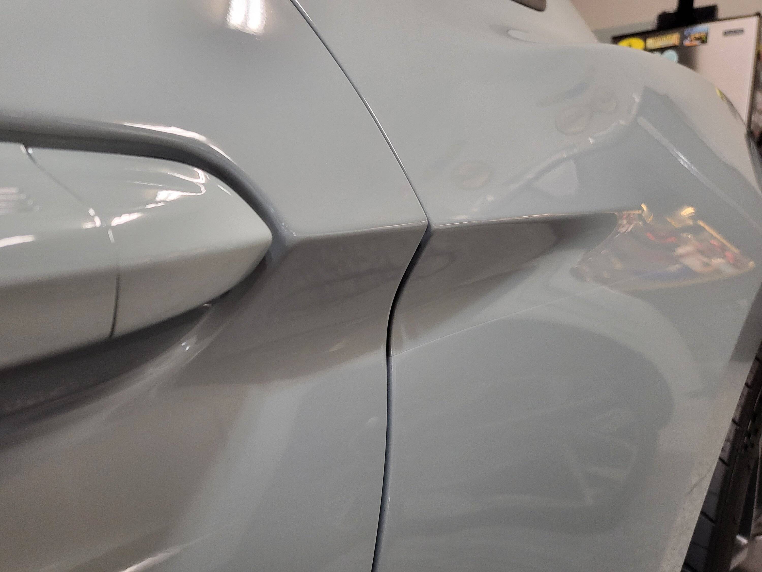

Once seen, can't be unseen.
Noticed this recently...hoping this post can fix it.
Bugging the heck out of me now.
Ya....that's a tad off!
