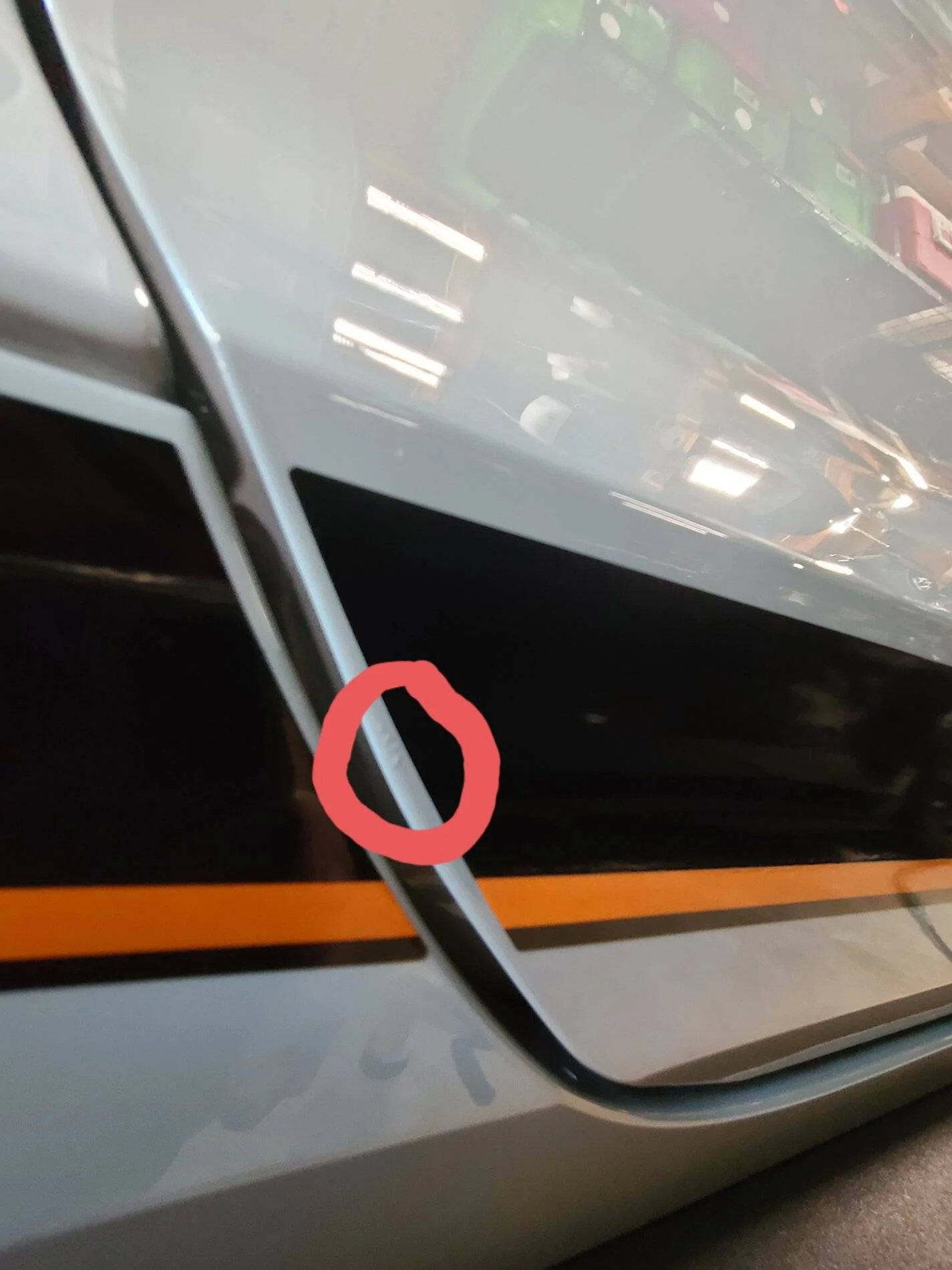

Hi All,
I was giving the Mach 1 a deep detailing today and noticed what appears to be a small area of bubbling under the paint of the passenger door by the stripe. I regularly clean this car after track events and am 100% sure this was not here a month ago.
Full disclaimer - as I just discovered this, I have not yet taken it in for a warranty claim, so Ford has not had an opportunity to view it and respond. I am planning to take it in sometime next week and will report on the outcome.
I deeply inspected the rest of the car and didn't see anything else like this...but based on my past experience with my 2011 Mustang I am not looking forward to dealing with it. Ford refused to repair any of the corrosion that developed on my 2011 which looked exactly like this when it first started, so I am hoping for a better outcome given the car is under 4000 miles and 5 months old. Nonetheless, it is a bit alarming to already be seeing this.
This car is number 937 for reference. It is 100% garage kept and has seen rain twice. Those with a early Mach 1 and 2021 Mustang in general may want to keep an eye out for this since it is very subtle and will get worse over time if it is indeed corrosion. Apologies in advance...the grey makes it a bit hard to see in photo:

If you are referring to the Ford Aluminum panel corrosion issues:
Starting in 2016, Ford revised the 5/60 Paint and Corrosion Warranty to state that metal perforation on aluminum panels is not a prerequisite and that if any such corrosion is present, the body panel must be replaced (not repaired).
As far as the doors, I don’t think the door skins on the S550 are aluminum UNLESS I’m totally wrong…. Maybe that has changed at some point? I thought the door skins and shells on the S550 were still steel.
It’s hard to tell from your image if that is in fact corrosion, but to me it looks like there was dirt or debris trapped under the paint when it was sprayed. Why something like that was not caught by QC is beyond me…. Especially going on now 6 years of the S550 rolling off the same assembly line . . .

That's good to hear about the revised warranty wording - thanks.
The points you bring up are the ones that have me scratching my head. I am pretty sure the door is steel, magnets stick to it (not as strong as on the trunk though). But, I am quite certain these bubbles were not here last time I cleaned it a month ago...Which is why I am suspecting corrosion, but I didn't think steel would have this problem.

Are you finding any other such issues under the decal on that door, or along the leading edges of any other panels?
Sometimes there are what are called paint pops that can happen too. It occurs after the paint has been applied and there will be small air bubbles that will pop (or some that don’t) and leave a similar artifact on the surface.
I’m just posting the below as an FYI for any needed future reference regarding paint defects. YOUR defect is certainly covered under warranty, as it’s not a user or road inflicted issue - it’s a manufacturing QC defect issue.
Attached is Ford Warrantable vs Non-Warrantable paint guide. The Ford paint is covered under the 5/60 Paint And Corrosion Warranty outlined in your Mustang Owner's Manual.

So I got the car in today to get looked at. The dealer confirmed it is some kind of contamination/corrosion issue under the paint and documented it. They are going to take care of it thankfully. They won't start the work until I bring it back in a few weeks...it's going with us for a road trip to the Mach 1 track attack in North Carolina that's scheduled next week 🙂
I'll post an update on what the ultimate finding/cause is if that's ever determined and what the repairs will entail.

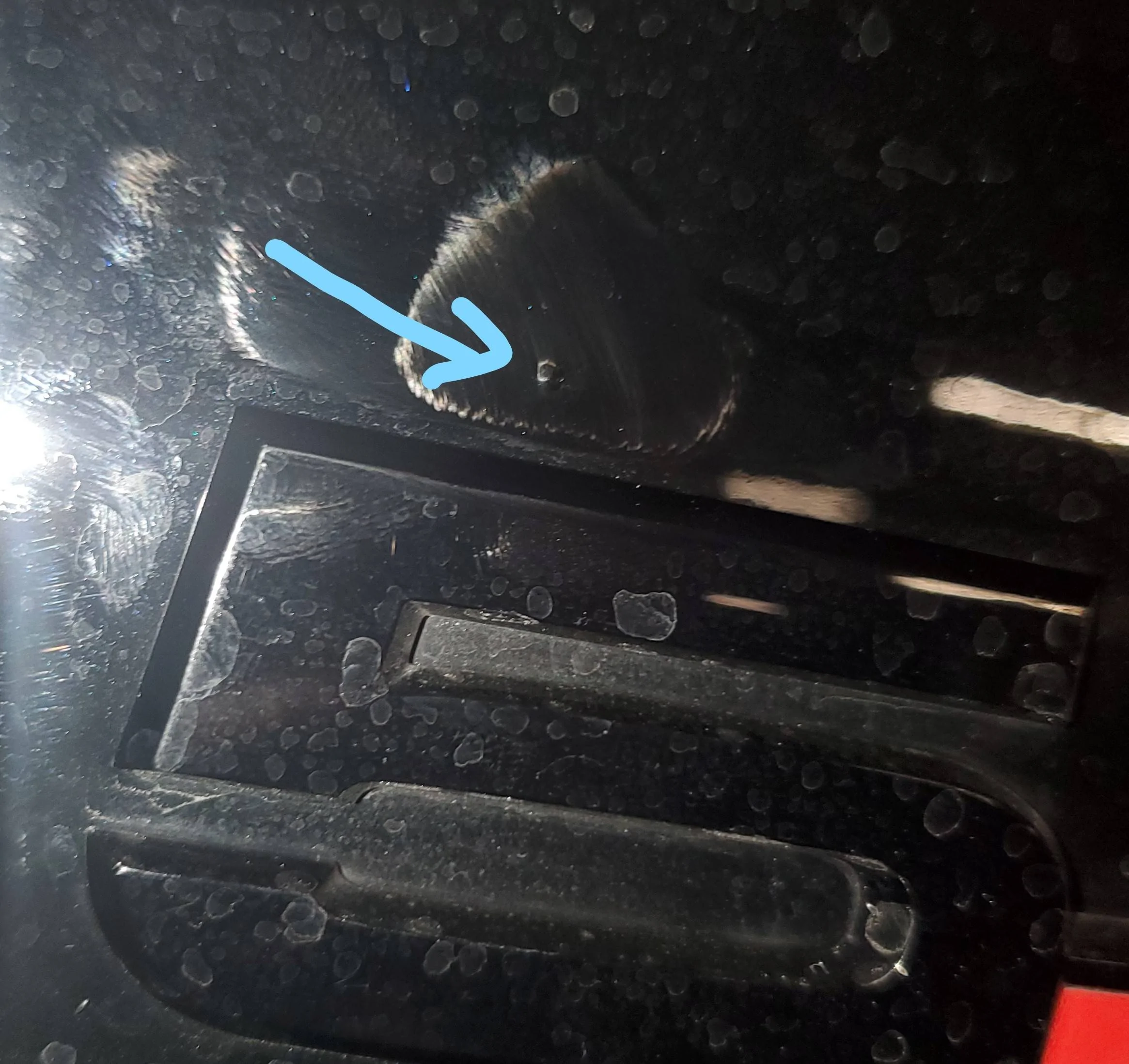

Sorry to barge in, but you seem to have good knowledge on this topic,
Is this picture an example of a paint pop or extra paint drip that was left and clear coated over? I recently noticed this "pimple" above the 5.0 emblem and it's perfectly circular and hard to the touch. I have no idea how to tell if this is corrosion related or just a paint defect ei. overspray or whatever. I'm sure my dealership would be in the same boat if I can't determine it's corrosion. Any advice or insight on this?
