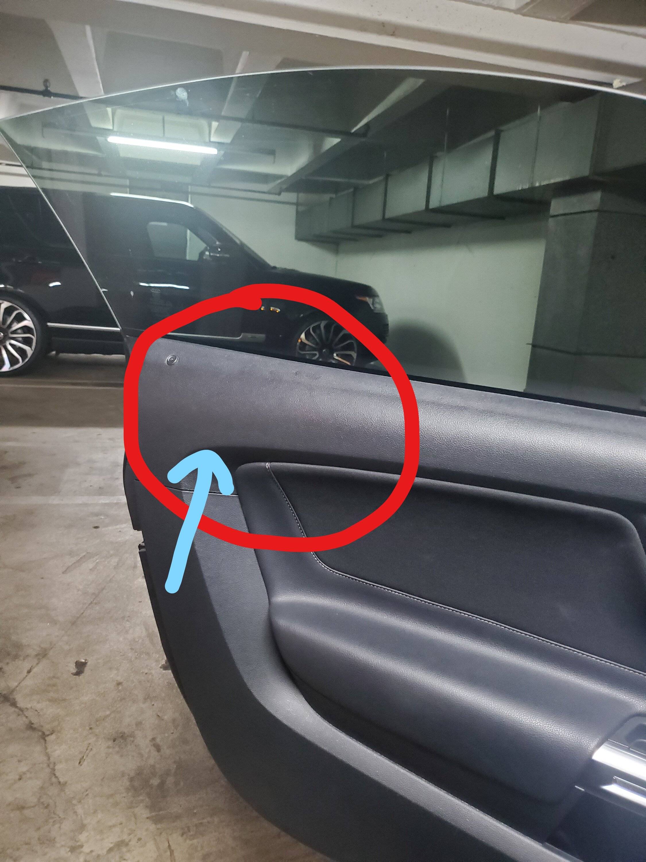

I recently started hearing this constant clicking/rattling coming from the circled area in the picture below.
I'm not 100% sure this is the specific area but when I press on the part marked with the arrow it produces a rattle or clicking noise of something loose.
Is there something inside that area that's known to be loose or cause interior noise? If there's a fix to this a thorough step by step of removing the door panel would be helpful. The last thing I want to do is break something while taking apart the door or make the rattle worse.

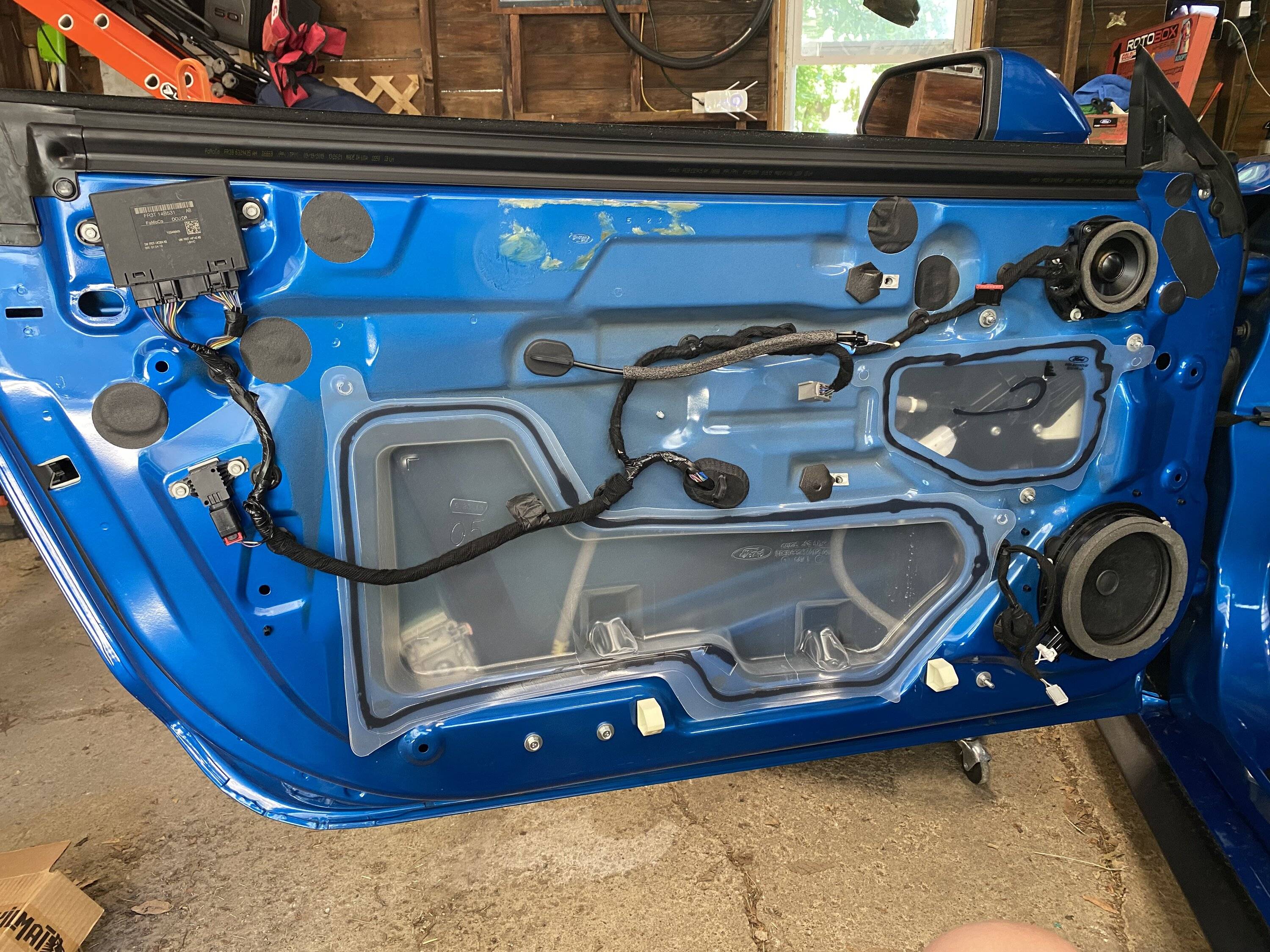

Here's a view of the underparts. That area has a black box with some wires, my guess is something needs tightened up or padded under there to stop your rattle.

omg if this turns out to fix my rattle you are goated. do you have any tips on safely removing the panel without breaking any clips or pins and what else I should be tightening/padding up?
Place felt tape under any harness or object that is coming in contact with the door shell (as seen in the above image). Also, check the back side of the door panel itself and make sure nothing on it is rattling.

Do you by chance know what that black box with the wires is?

I do not know the specific name. It is part of the wiring kit for the door (if you look up driver door wiring kit it is attached to that whole thing).

thanks! Can you tell me the shape/size of the socket I need to loosen the bolts on the bottom of the door panel and the one inside the door handle?

I have a small rattle here as well near that box. I just whack it and usually it stops. What exactly is that box?
