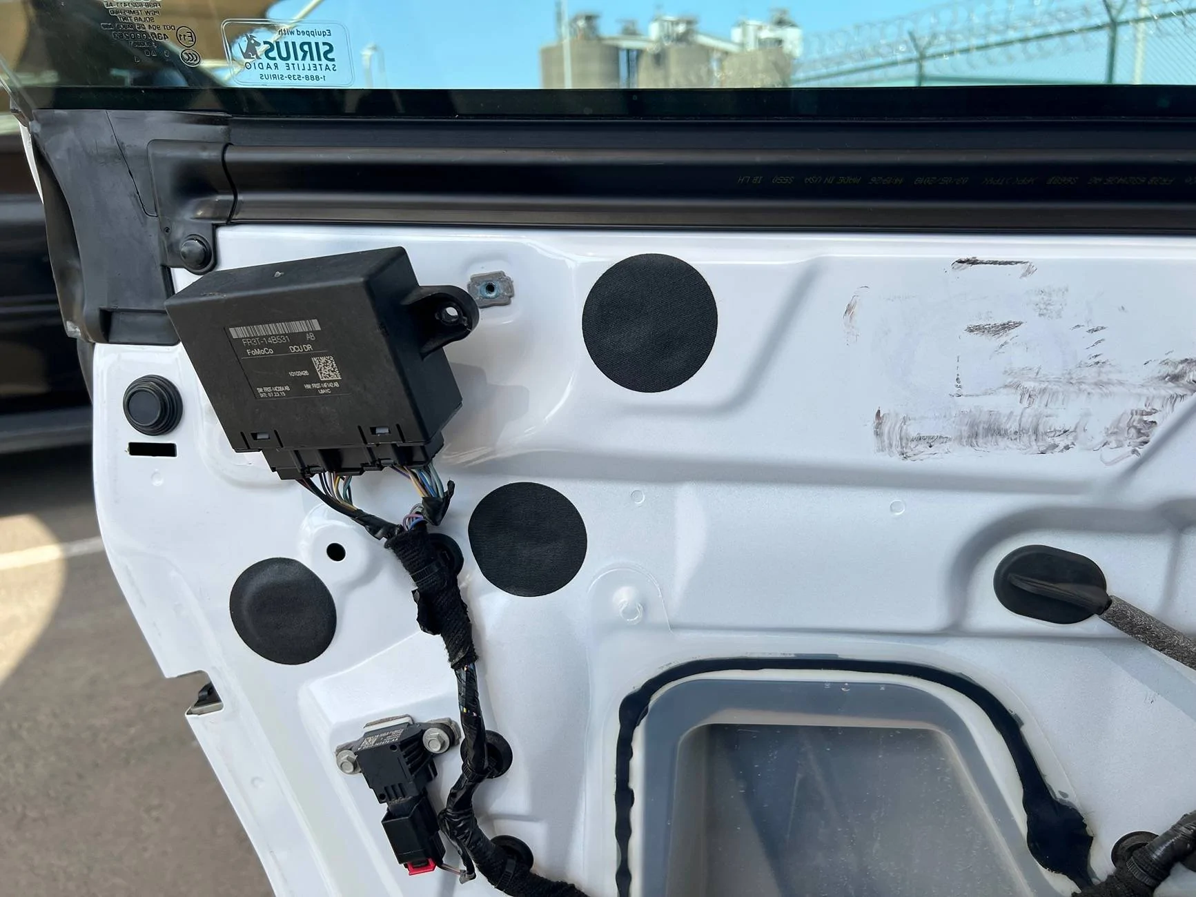

I’m experiencing the same issue, and it’s been quite frustrating. I removed the door panel in an attempt to identify the source of the noise, but unfortunately, I had no success. The sound appears to be coming from the area where the black box is located. However, even after removing the box, the noise persists, and I’m still unsure of the cause.

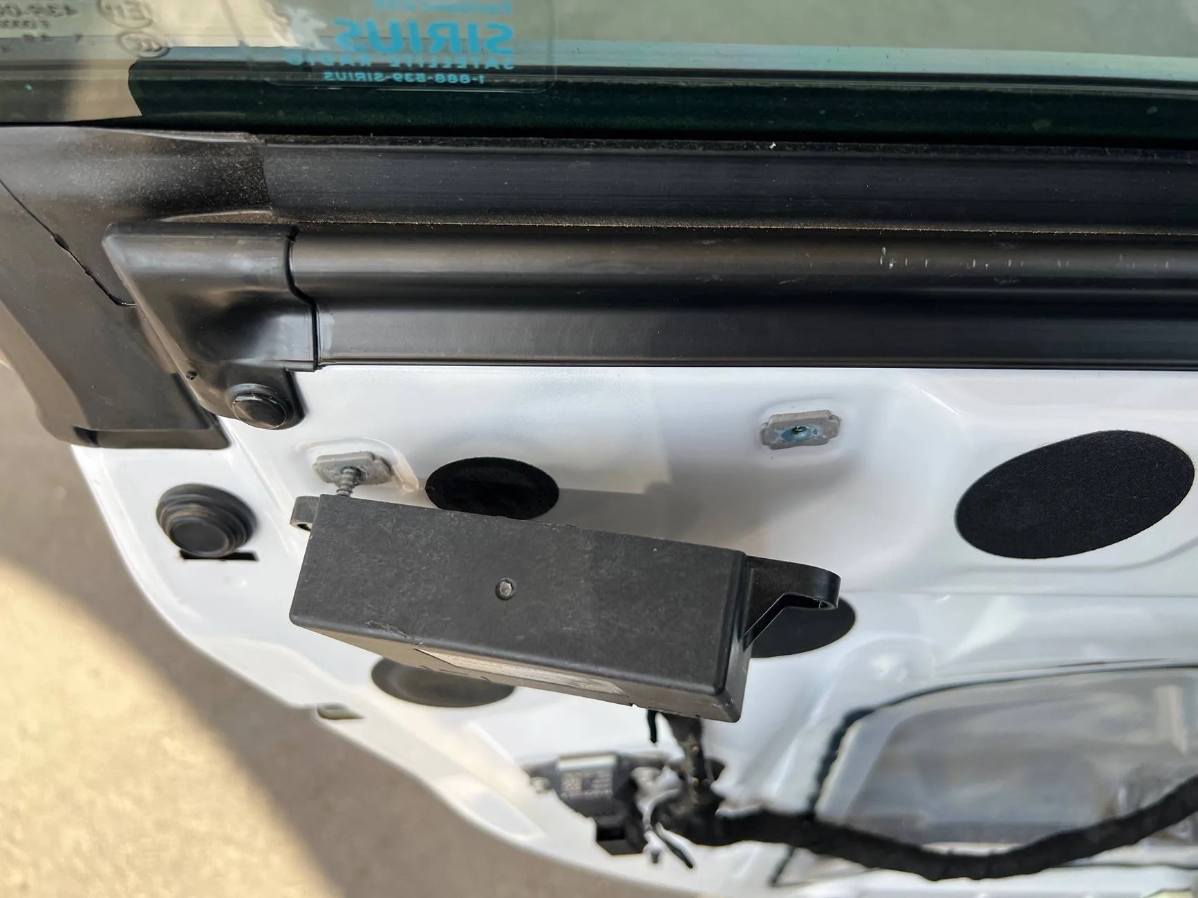

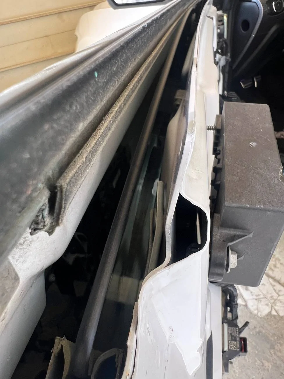

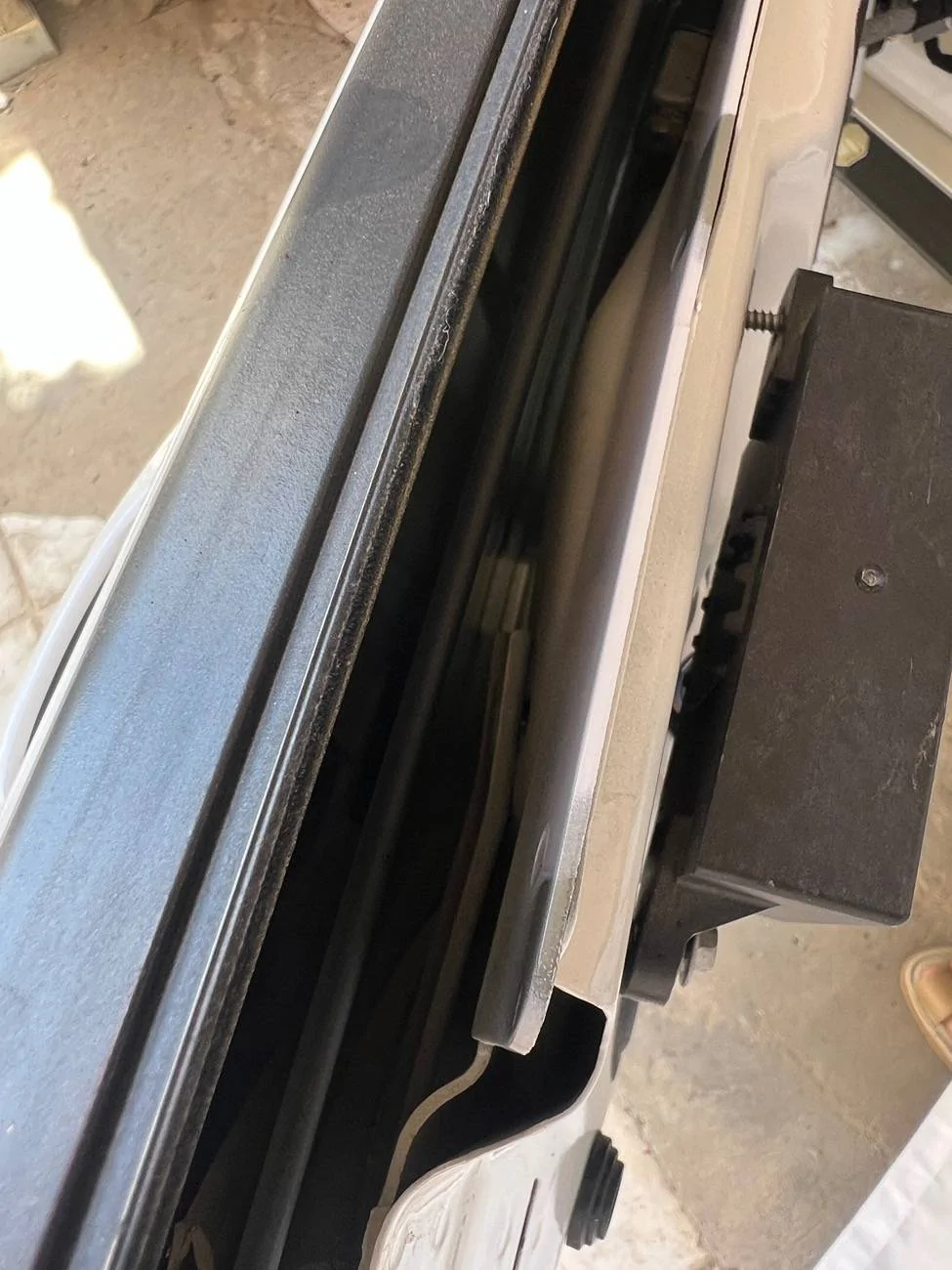

Well hoss, I’ve thoroughly pressed around the door panel but haven’t been able to pinpoint the dang source of that rattling. The sound appears to come from directly behind the black box. I removed the weather strip and discovered a metal piece with a screw on it. I’ve attached a photo—although it ain’t very clear, I believe the noise may be coming from that component.
I plan to use an air blower to clean it a little bit, and apply silicone spray hopefully it eliminate the rattle. I want to use grease, but the space is too tight.
P.S. I read somewhthere’s supposed to be a piece of foam in that area, but I haven’t been able to locate it. Can anyone clarify where exactly it should be?

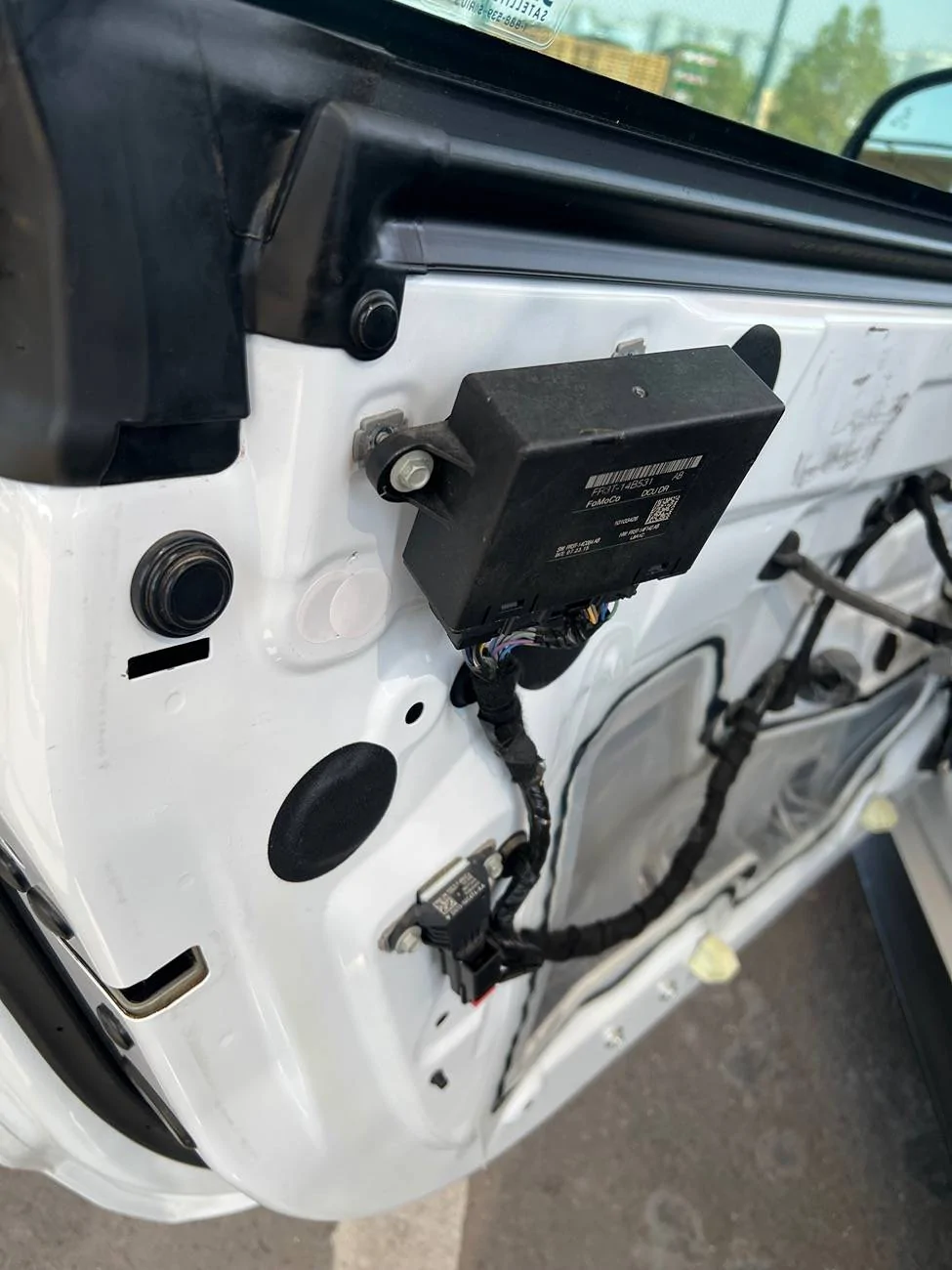

thanks! Can you tell me the shape/size of the socket I need to loosen the bolts on the bottom of the door panel and the one inside the door handle?
There are two 10 mm bolts. One is located under the little plastic flap under the door handle. There is a little drivit on the upper front of the panel you use to pull it out with a small pull tool. The other one you will see once you remove the housing that holds your window/door lock buttons. Then you remove the 2 7mm bolts on the underside of the door panel. Then starting under the woofer, use a plastic pry tool to start popping out the door panel working your way towards the bottom towards the back of the door. Then work your way up the front side and back side then the panel will lift straight uo and off
