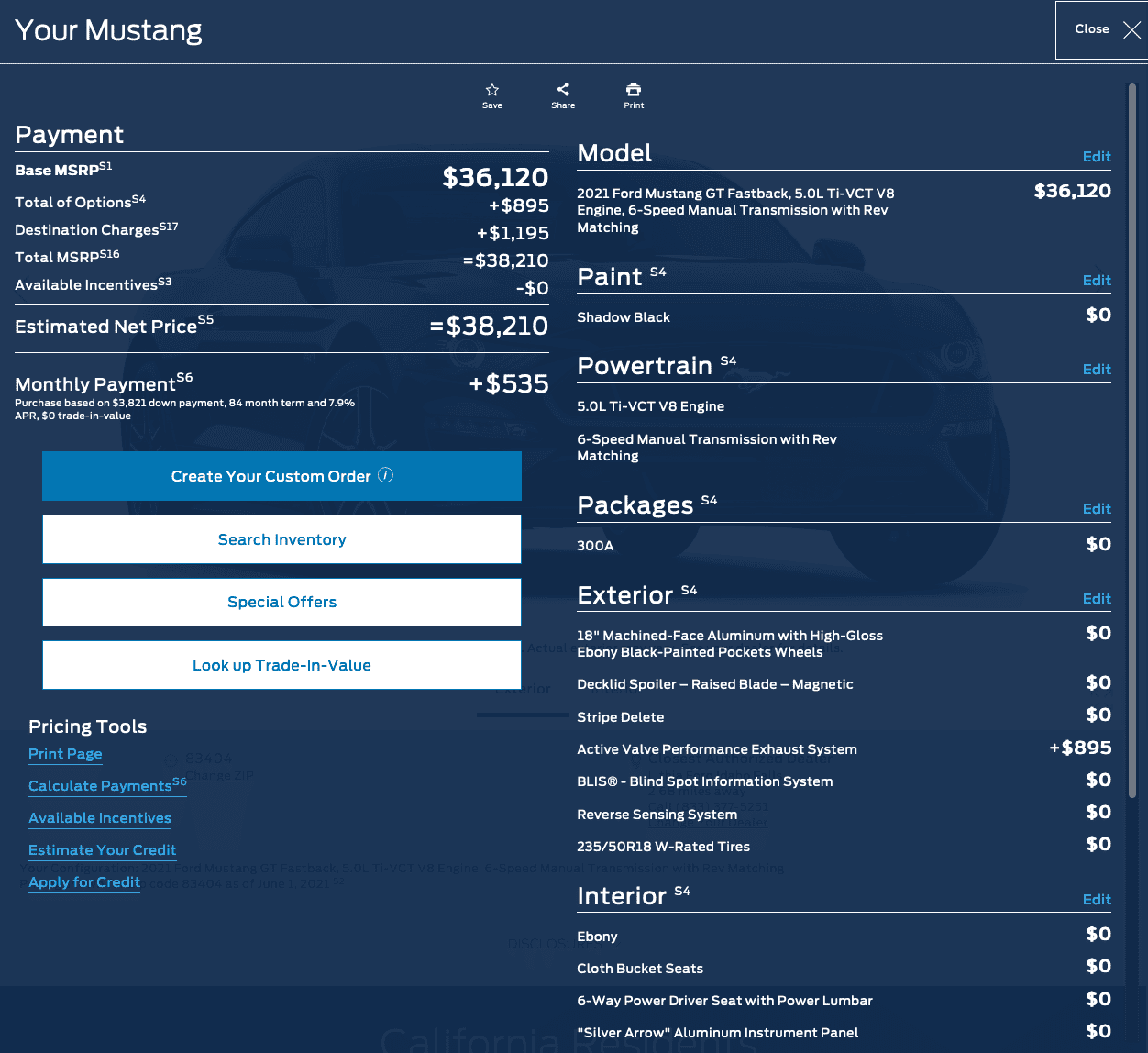

except you can't get AE on a base car, nor MR. The only missing aspect for 300A 6MT is throttle curve. But you do know that base cars have 'sport' mode - just double-tap the center button. I don't know if that changes throttle map at all since I have an aftermarket tune - haven't noticed anything.

You absolutely can get AE on a “base” car: both with 300A and 301A. I have it on my 301A.
Sport mode on my 6MT definitely changes the throttle mapping - much more responsive vs Normal.
301A is NOT a base car. As soon as you add AE it requires 301A. Base car is by definition 300A/100A and it has the old-timey buttons and no toggles and 4" screen.
correct, on 101A/301A/400A/401A. Does not apply to X00A cars.
It REALLY does NOT require 301A for AE. Go to the configurator right now and try it. You can select AE in the "Exterior" section without it selecting 301A.
Here is a screenshot of the summary for the car I just configured like that. Note the 300A and the AE!
