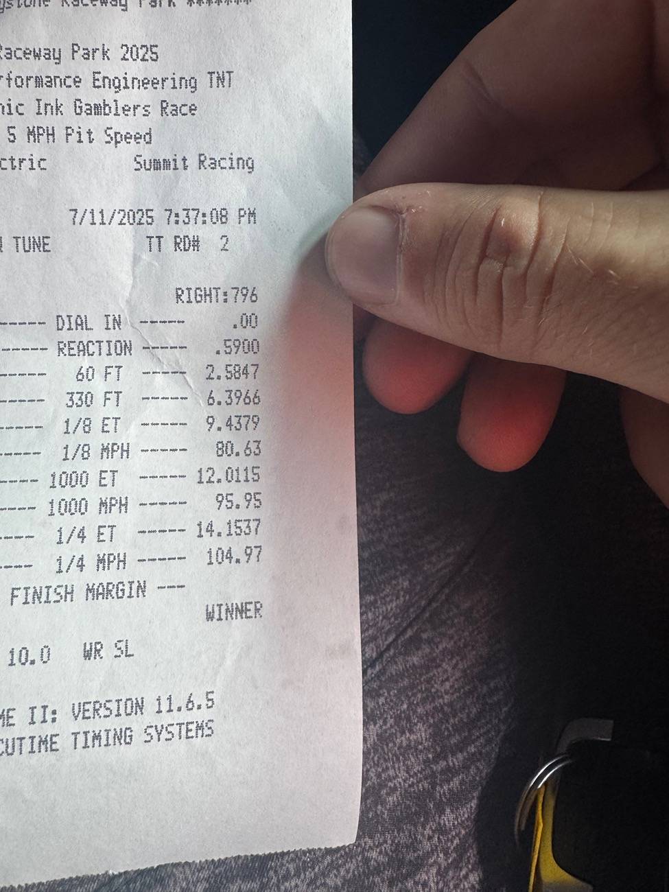

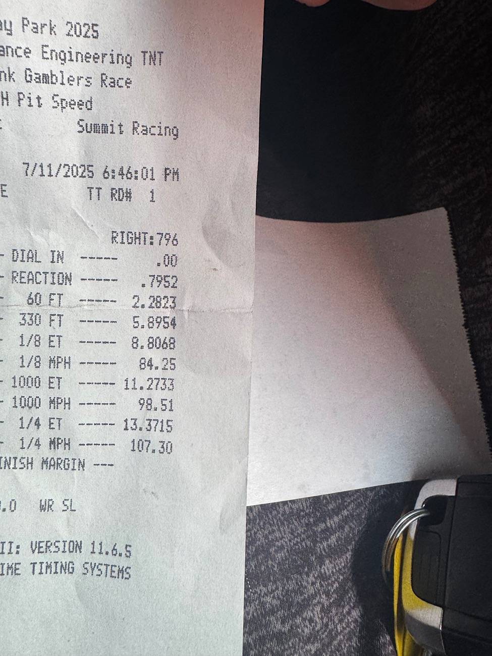

What’s up guys, going to go ahead and make a post on here after making my car look bad at the strip. I got a 21’ GT PP 6-Speed, only mods the car has is a h-pipe and lowering springs. Finally got the chance to take the car to the strip last night and I ran terrible times. I was trying to understand the different modes and traction control options along with the launch control. Let me start by saying I just got this car as a replacement to 20’ after another driver crashed into me, so the 21’ has some terrible all seasons installed by the dealer in the back and I haven’t got a chance to upgrade tires yet. First pass I spun really bad trying to leave at 4200 RPM, in the moment I was trying to figure out how to hold the clutch, brake and gas down all at once, I trapped myself a 13.6. My second pass of the night was even worse, I tried launching the car at like 2500 RPM and the car bogged down bad giving me like a 14.2. I know it’s gonna be a learning curve trying to come up to the line and get the car “set up” to launch but I was just trying to see if anyone had any pointers. By the end of the night I realized I’m definitely more of a roll racer and I have a lot to learn. I need to understand all the modes, LC, and traction control better, even considering just going old school and turning everything off and learning the car that way. Also after my second pass I realized my rear tires were aired to 36 PSI so that definitely did not help either. But anyway any advice would be appreciated, thanks guys.

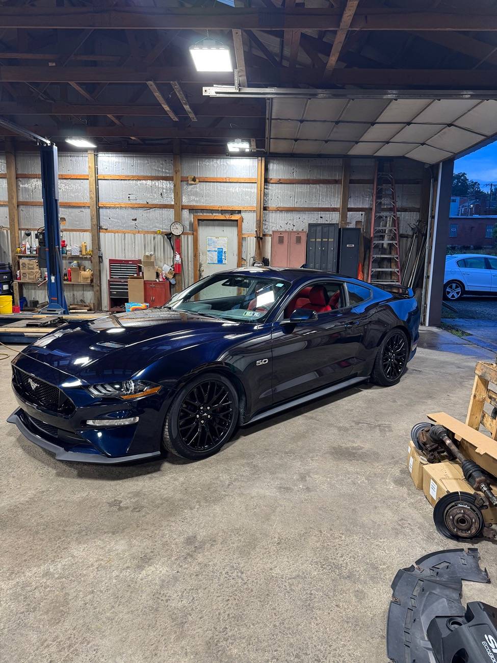

I can't help you. But that blue is pretty. My '22 is atlas blue. I like that blue you have better. I'm not a drag racer, and only drag against my wife. I just like the feel of getting there with my 4.10 axle.

I’m going to guess he was in the 104-106 range on the 13.6 pass and 98-100 on the 14.2 pass. Let’s see what he says when he comes back here.
With a bad 60 foot time like a 2.3...
He was probably 106mph on both runs

What was your trap speed on those runs?
Bad lol. Thanks for the replies to everyone ! I’m going back out tomorrow for flashlight drags at a local air strip so I’ll get more practice in tomorrow and I’m going to try everything mentioned.
