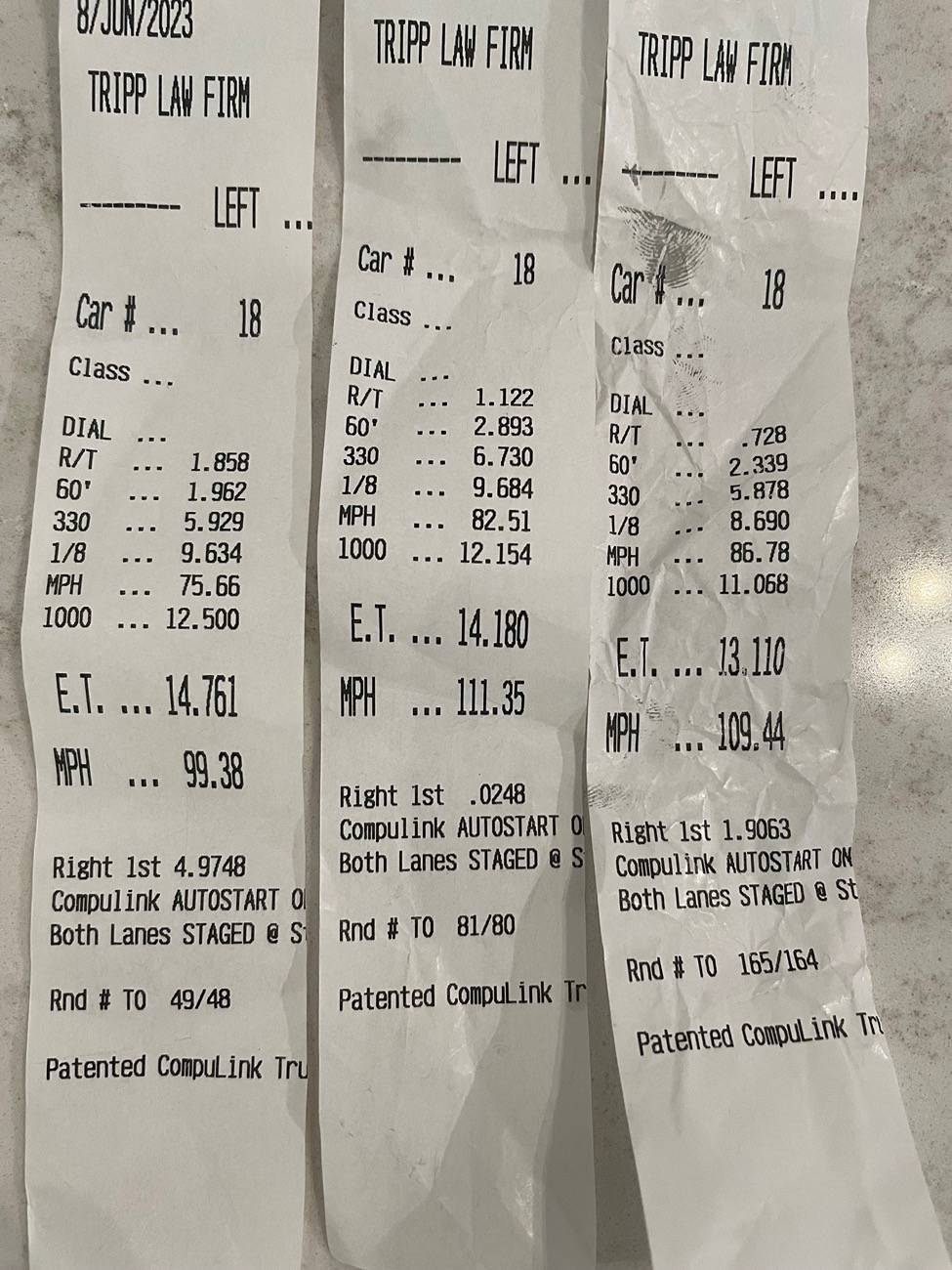

With a bad 60 foot time like a 2.3...
He was probably 106mph on both runs
I went back and looked at a few old timeslips with close to his ETs with crappy 60’ times and came up with that mph range for his runs.
Yea but you can't accurately guess on hilarilously bad runs like he made
You can really only do that on a 'good' run.
For example, 98-100 on the 14.2 pass would be 'about right' for a 1999-2004 Mustang GT.
But I was just assuming he was both consistent and bad, so that's why I was so close :giggle:
