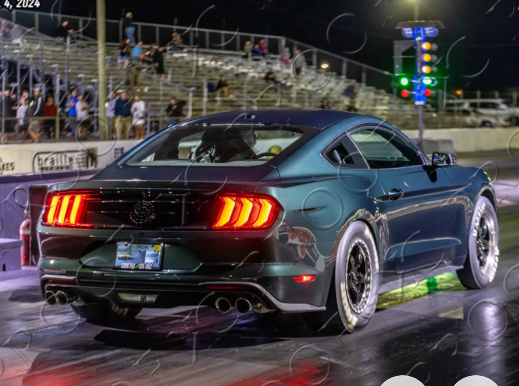

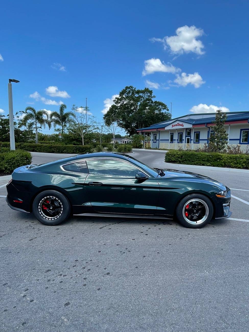

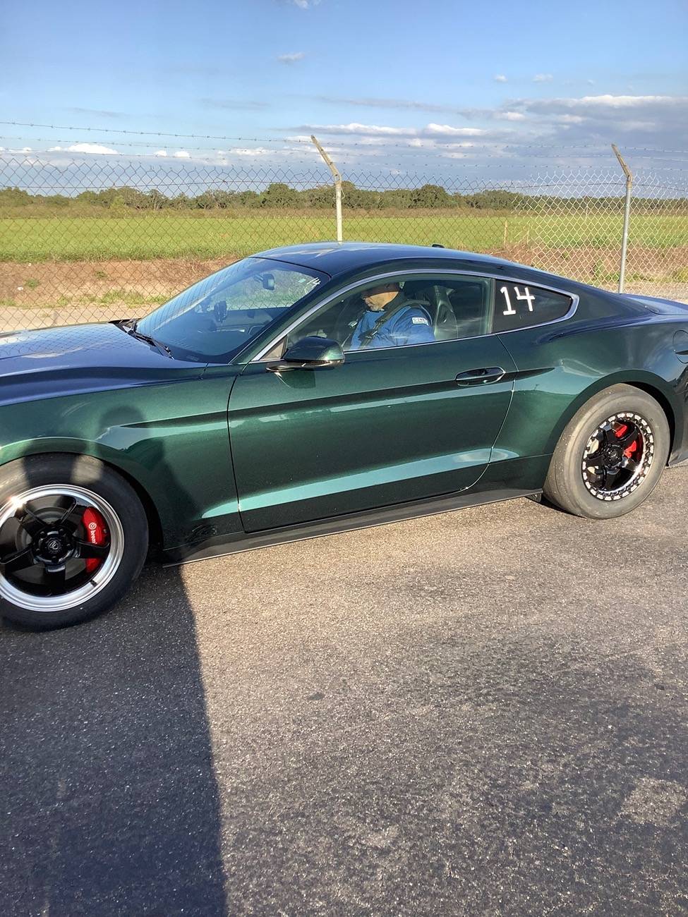

I was thinking about something around that size but once I’m boosted, I don’t think those wheels would be good enough because I wouldn’t be able to fit bigger tires on them
I ran a 305-45/17 Mickey Thompson ET Street R on the same wheel before switching to the Hoosier QTP. The next size up is a 315. I think that would fit, but it may not be optimum.
Just curious, what power level are you shooting for? Wondering if going 315 would even be beneficial? Then there’s the issue of poke (will they stick outside of the fender wells)? I like the look of the QTPs on mine better than the ET Street Rs. The QTPs filled the gap in the wheel well a lot better.

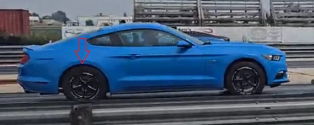

Best 60ft ( 1.6x) I ever got wasn't with my MT ET STREET R BIAS PLIES 28x11.5x17 ( God know I tried ), but with my ET STREET R 305/45R17.
WildHorse
N/A or GO HOME
Jun 28, 2017
270
10,297
8,350
Home World: CLASSIFIED
Puddintane
'17 S550
Also, I ain't running any stop the hop kit. Only suspension mods are cradle bushing lockout kit and vertical links. But I did do a $15 mod that stopped my base stock GT rear springs from fully compressing, thus not burying the rear tires right into the fender well. Helped BIG TIME. Gonna to a couple more things over the winter to completely eliminate the hop & get it into the deep 1.6 60' N/A with the drag radial.
