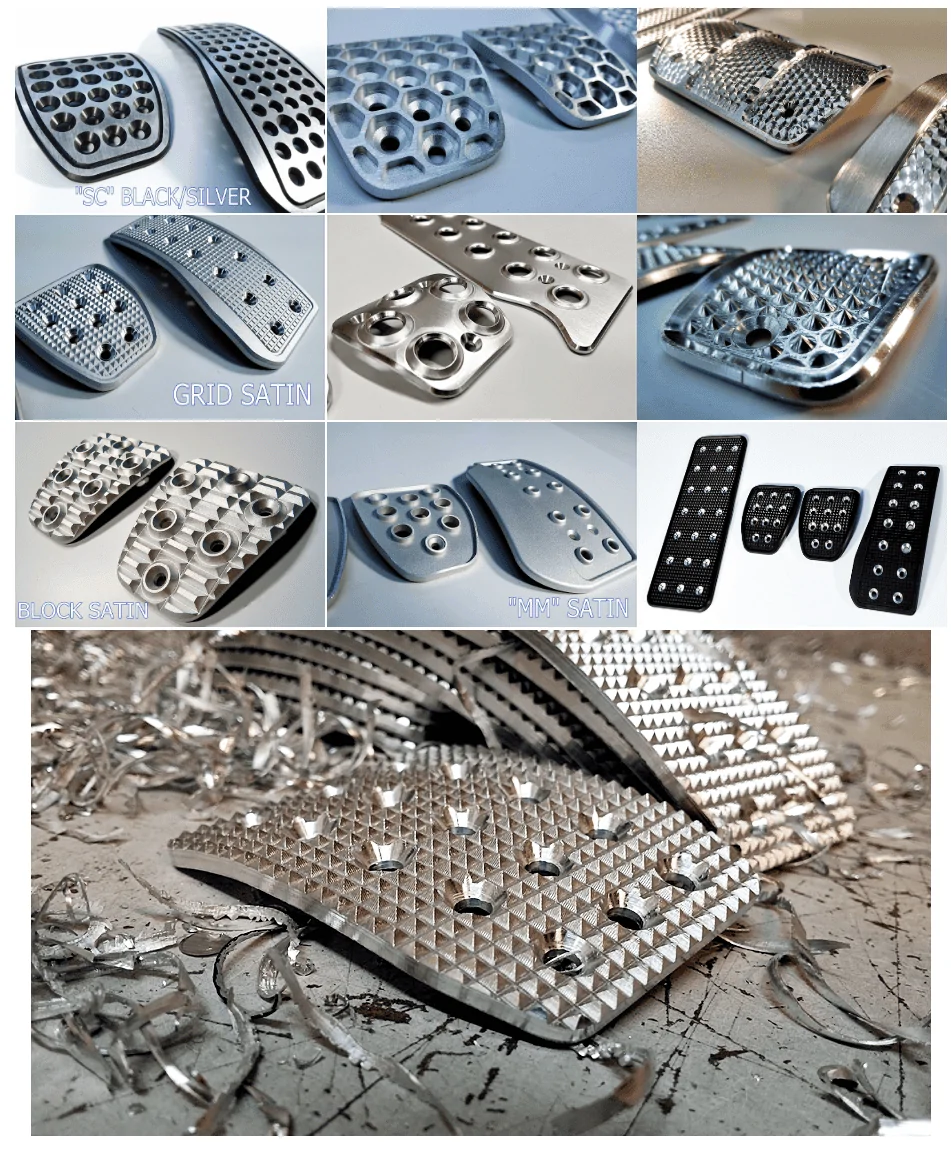

I ordered Sullivan Racing pedals. The gas pedal comes in different widths for different driving styles. I can roll and blip okay but I got tired of having my wet sneaker slip up over the loaded clutch pedal so I got some aggressive surface coming...
https://www.srpracing.com/
