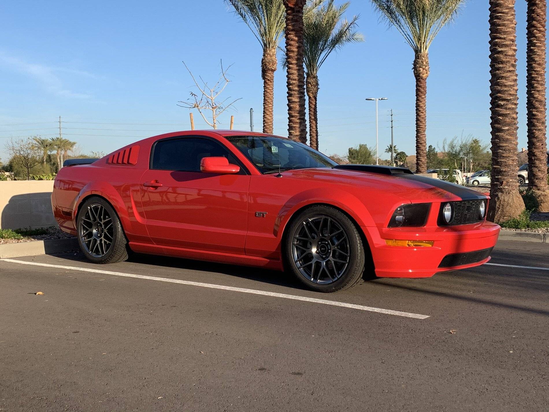

I ran a 285/35r19 in front and a 285/35r20 in the rear on my 06 and I thought the stagger of 19”/20” looked really good.
It isn’t quite as dramatic as what you are looking at though since the aspect ratio and width of my tires were the same.
