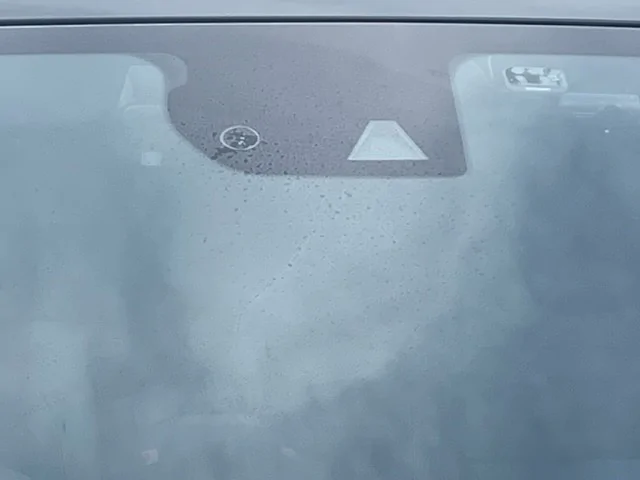

does this look right? windscreen sensor (under rear view)
kyrusdemnati
Sep 7, 2021
84
london
kyrus
mustang bullit
please see picture
im still trying to resolve my pre collision assist error and have my windscreen replaced because there was a crack in it, but if you look at the picture
it seems there could be some water in the sensor area, from the outside of the car when i use a cloth to clean the windscreen in this area, i can see the water moving.. and it just doesn't look right from the outside either (the sensor camera?)
if you have a bullit/mustang, - does yours look similar?
excuse the rain splash / smudge on the second picture, i was cleaning the windscreen with a cloth which got wet

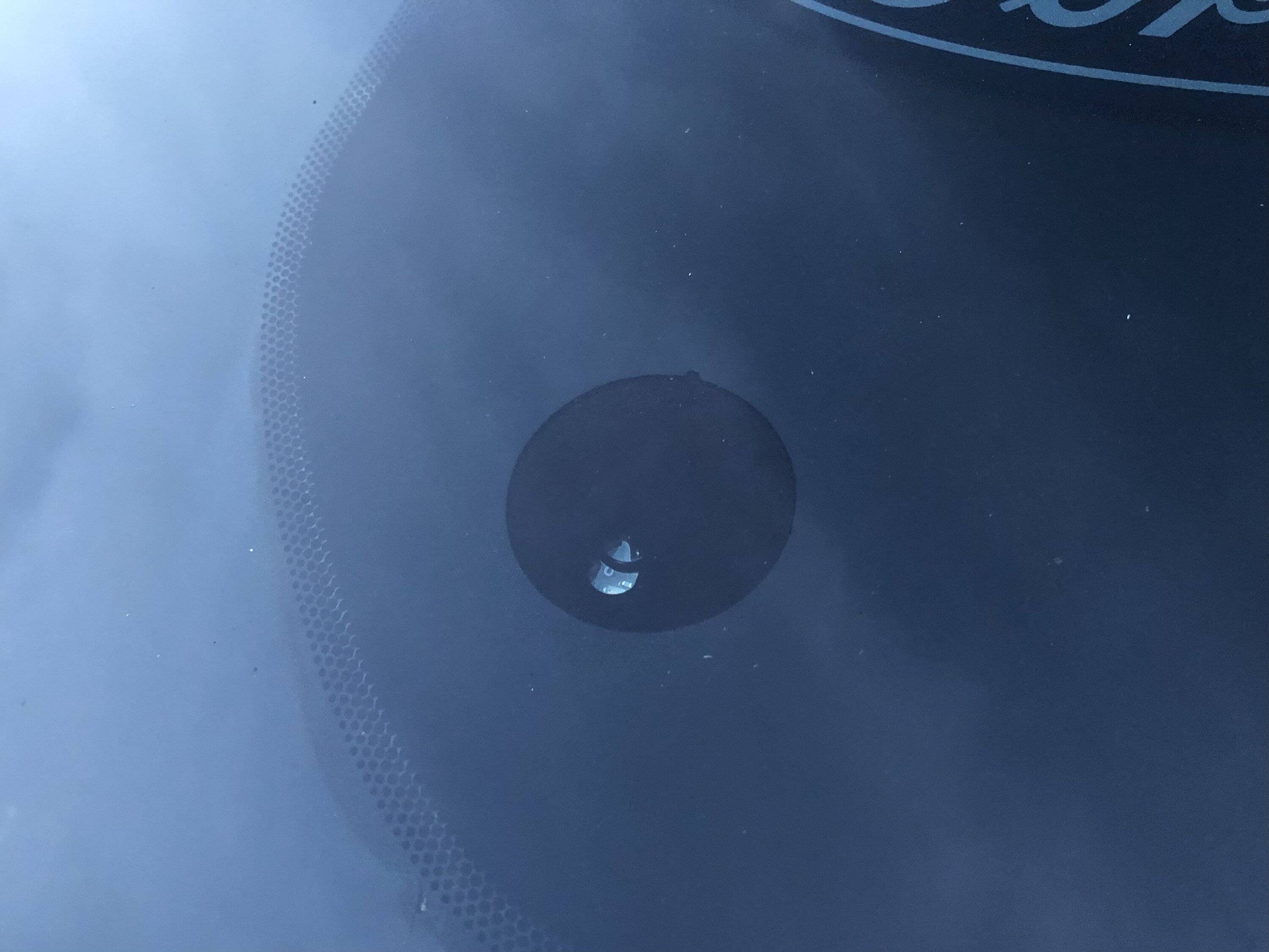

Here’s mine :

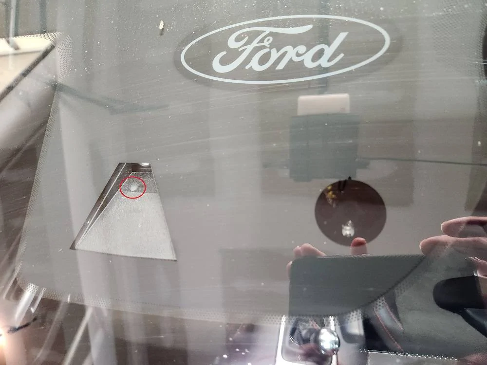

It looks a bit funky to me. Here is a photo of mine (it's raining here this weekend, so the windshield is embarrassingly dirty right now). When my windshield is clean there is a bit of schmutz UNDER the glass near one of the sensors (circled in red), but it does not seem to affect operation (but it does annoy me to no end 🤬).

I wonder if my sensor is a mess and needs replacing or cleaning at least because I am get pre collision assist error which annoys me …
I took off my rear tints and strangely it appears to let me have access to the settings again … but then error came back

The circle that looks like water in it is only for the rain sensor- it has a clear jelly pad sandwiched between the glass and sensor. That would not have anything to do with the issue you are having. Perhaps there is a calibration procedure for the camera after a glass replacement?

It should not look like that to my understanding.
With the rain sensor (that's what the "eye" is for), there is a gel layer in between that has apparently run.
This could put the rain sensor out of operation.
