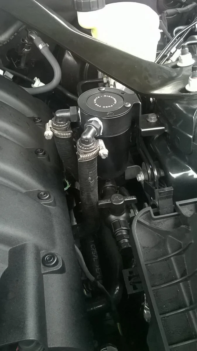

Alright Mishimoto, and everyone else. I've got my 2000 degree flame suit on :D
A little urban engineering. It's just an experiment that's reverseable. Yea it doesn't look great, but a coat of black plasti-dip will help. Let me have it, I can take it!
I think coated black it will look good.

Thanks, that's all 3/8" coming off the bottom of the can so it's a little bulky.
Looks good! Did you see if they had a 3/8 brass ball valve and a 3/8 nipple instead? Should be much smaller.
This was stuff I got from my work. 3/8" is definitely overkill for a drain valve. No doubt you could find something smaller.
Haha I love it. Definitely a departure from most underhood components but props for just doing it your own way.

Catch can retro fit 201. Valve blacked out with plasti-dip, looks much better, IMO. Thanks for taking it easy on me, I thought I was gonna get thumped for sure. :thumbsup:
Not bad, the plasti-dip makes it look much better!
