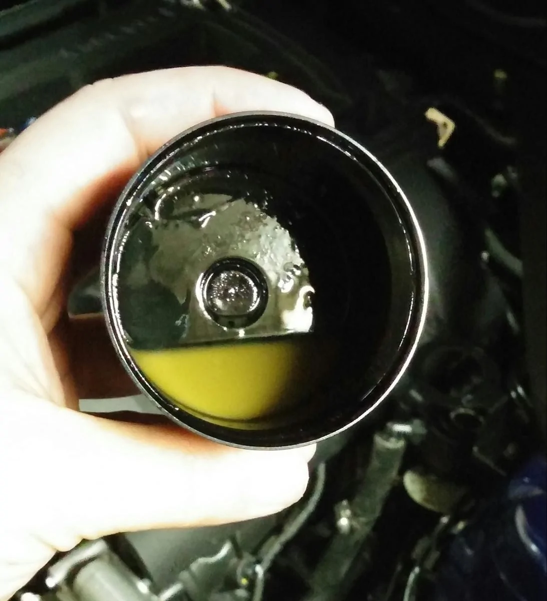

Well with 200 miles passed since install I figured time take a look inside.

Very cool, thanks for posting your results! This is around the amount of accumulation we saw with similar mileage. Shooting you a PM shortly!

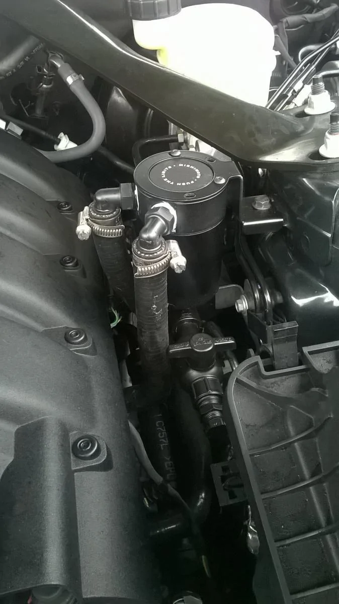

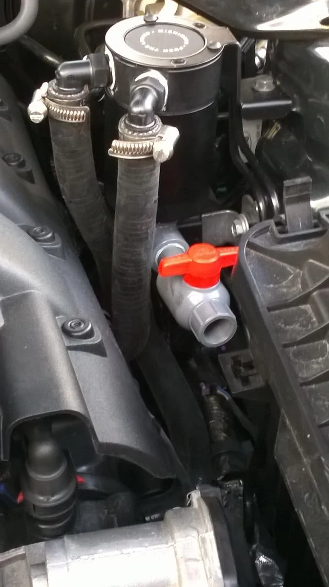

Alright Mishimoto, and everyone else. I've got my 2000 degree flame suit on :D
A little urban engineering. It's just an experiment that's reverseable. Yea it doesn't look great, but a coat of black plasti-dip will help. Let me have it, I can take it!
