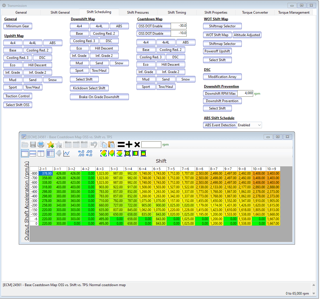

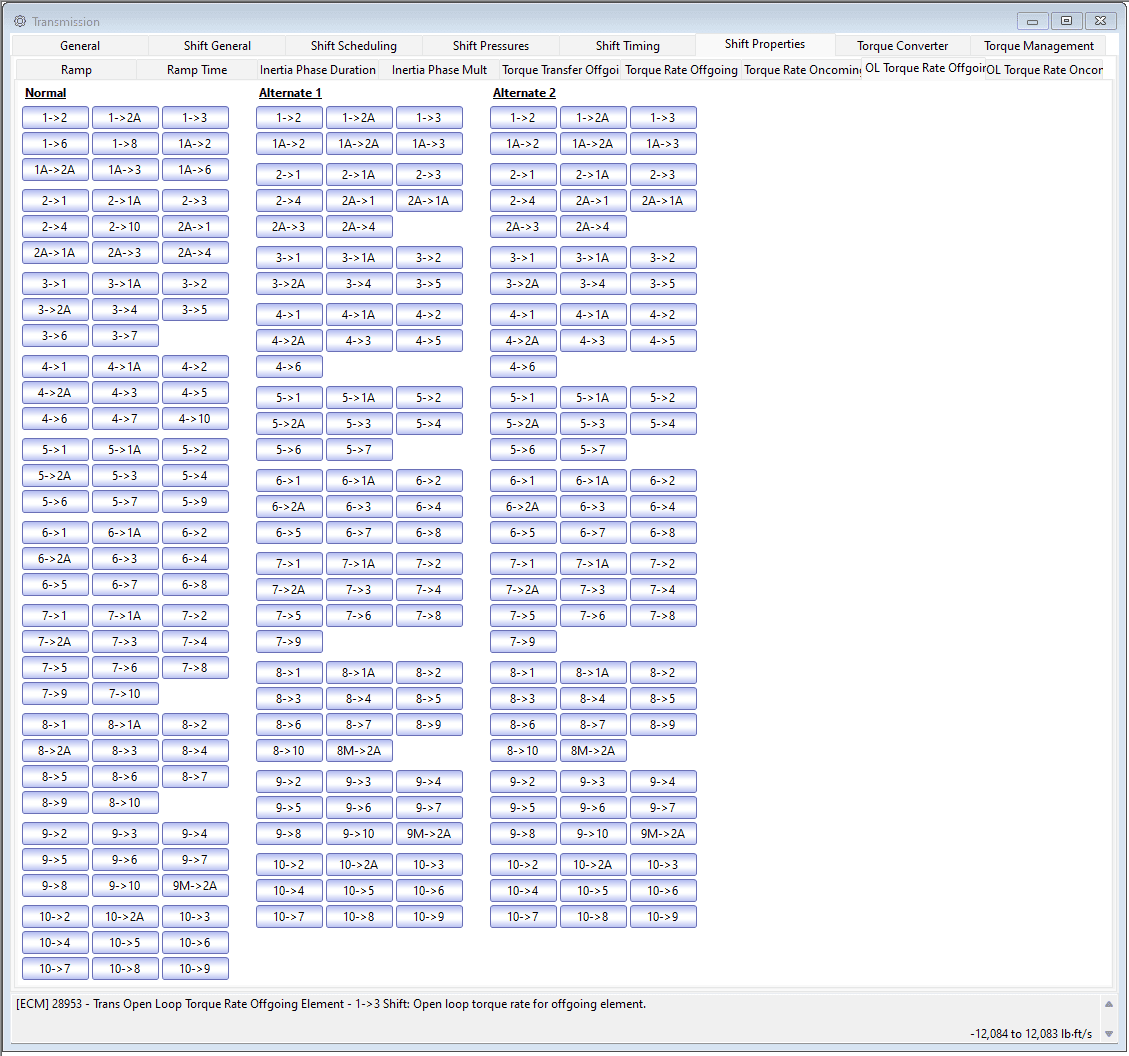

Funny thing, ALL of that can be changed in the tune. I have switched over to tuning my own car and have spent literally MONTHS trying to refine the trans tune. You have no idea how many tables and values there are for every inch of a shift. The TCC settings alone are in the thousands of values. I would pay REAL MONEY to a tuner that could refine the trans out for any driving scenario not just WOT. Look, this is from the tune.
This is one tab of one sub category in the trans only. #goodluck
And @young at heart heres the table for what you're talking about... Try to figure that shit out.
