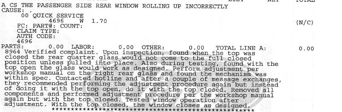

I had this problem about 9 months after I got my car. I had mine repaired under warranty, but as my dealership doesn't see many convertibles it took them 4 days to figure it out. Below is my service write-up, hopefully it will help others work with their dealership.
Of course it wasn't a permanent repair and started to do again 6 months later. Not wanting to take it to the dealership constantly, I tried re-calibrating the window myself. After some trial and error, here's what worked for me:
- start with the top closed, the front windows down and the back windows up
- lower the back windows and hold the button down for the count of 10 once they are all the way down
- raise the back windows and manually move the window closed, hold the button for another count of 10
Once I did this, the window would close all the way again. I think it was just a matter of getting the window in the right position while it re-calibrated the end locations. Since I've never seen this written up anywhere, I'm curious if it works for anyone else.
I have found the calibration lasts longer if I always roll up the back windows first and keep the seals clean and lubricated.

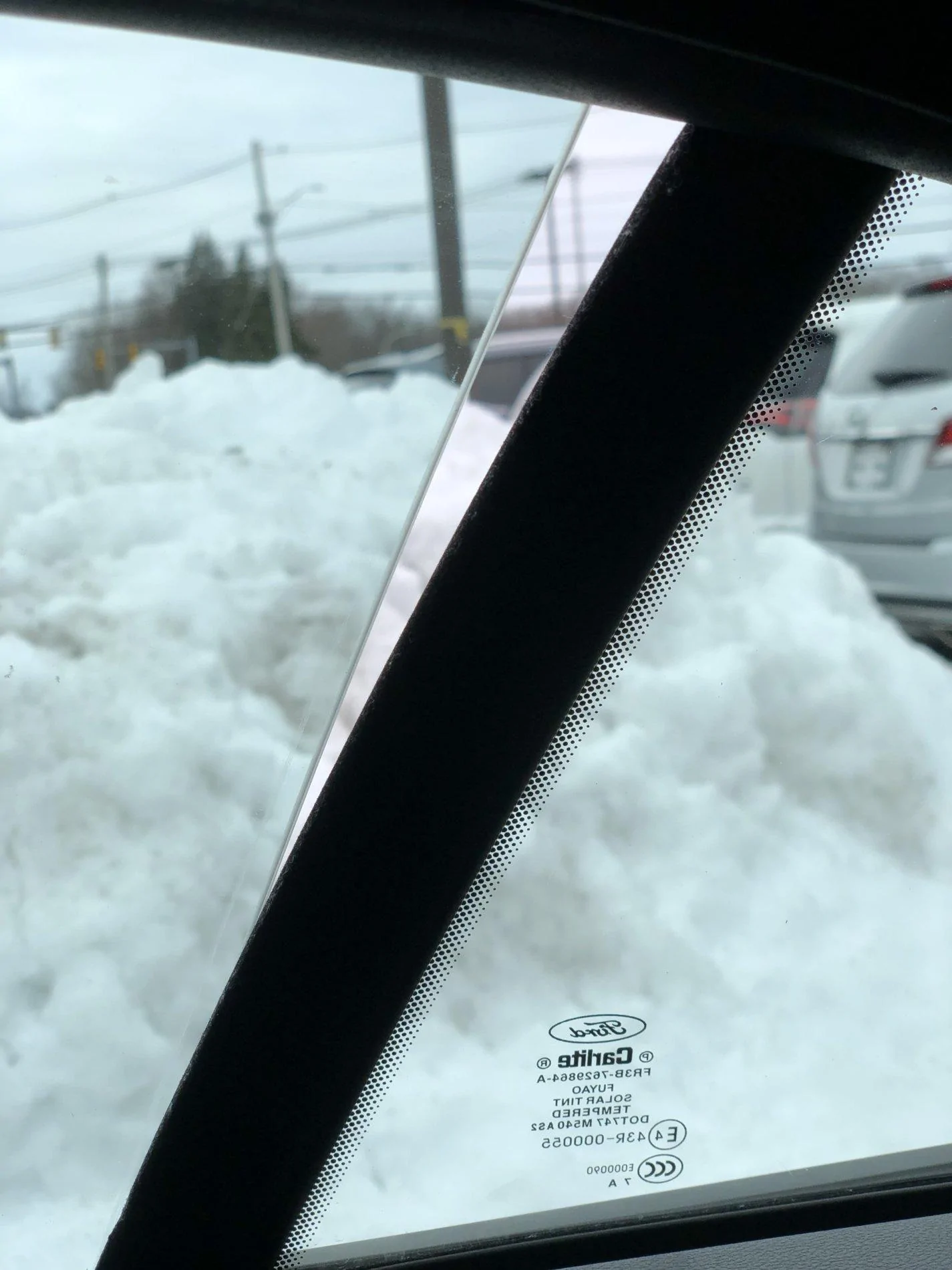

Good info! I'll have to try that. I checked out 4 other convertibles Thursday. They were 2017-'18 models. The windows got stuck on 3 of the 4. That was with closing the rear window first. This was the worst gap. I tried reclosing it a few times before taking this picture a

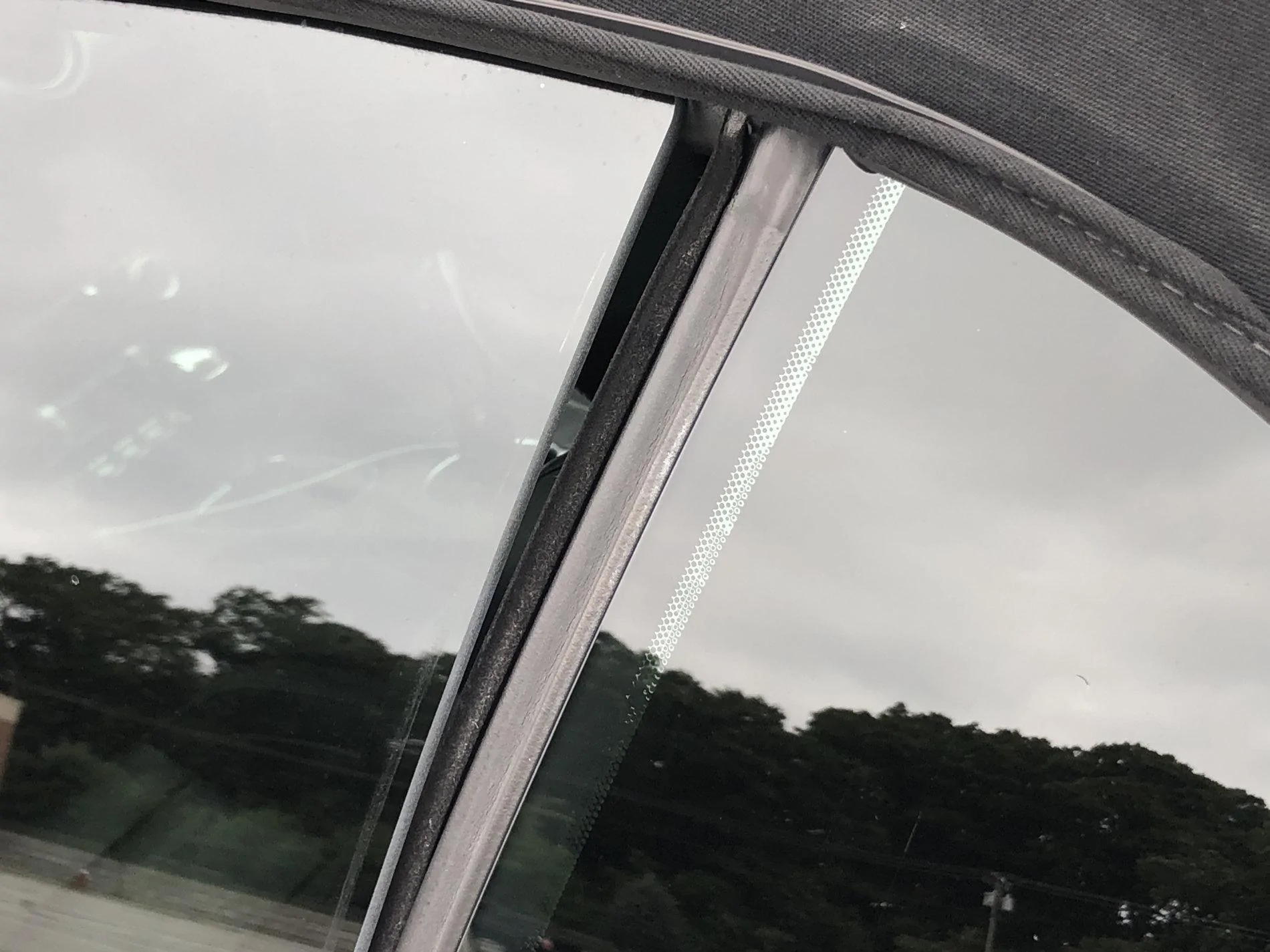

Mine are sticking more now. This picture was taken today. I usually pull them into place but I shouldn't have to. I guess it's time to break out the lube. I rather take care of them myself over letting the dealer do it unless something needs to be replaced.
