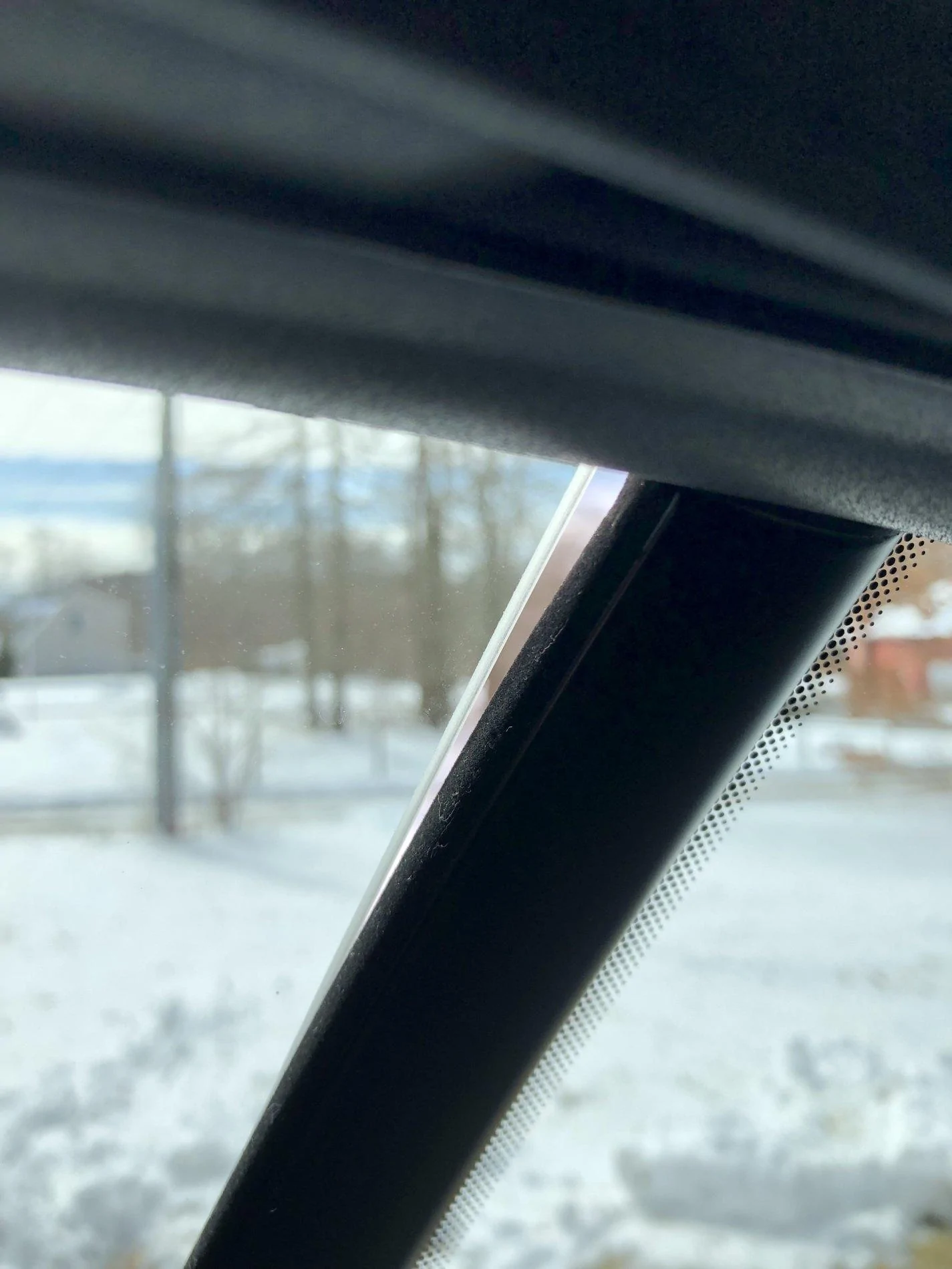

Pic from the last time it happened. I checked out an '18 convertible at a local Ford dealer. Tried putting the windows up a few different ways. Those closed without a problem.

Thatguy, Ford and the Top’s manufacturer have probably fine-tuned the operation, alignment & fit of these rear quarter windows so that late models work correctly.
My ā€˜17 left rear window has never been an issue, only the right. Luckily my 3 or 4 months interval application of WD40 Silicone Spray keeps me out of the shop.
