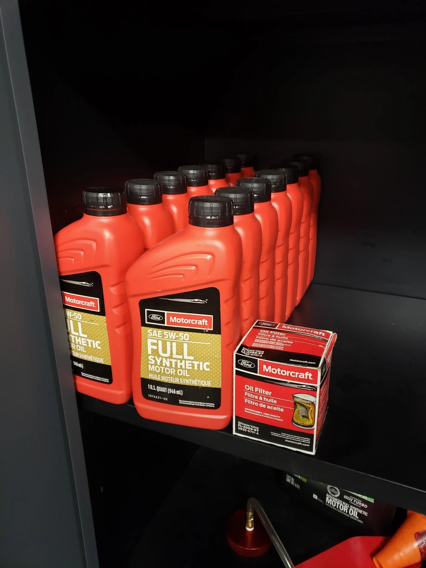

i thought that was for my oil change when im (inevitably) back down there in 5 months? :cwl:
hehe. I am doing some mid-summer cleaning and need to get them gone so I can get my garage and house back in control. 2 rooms are filled with car parts!
