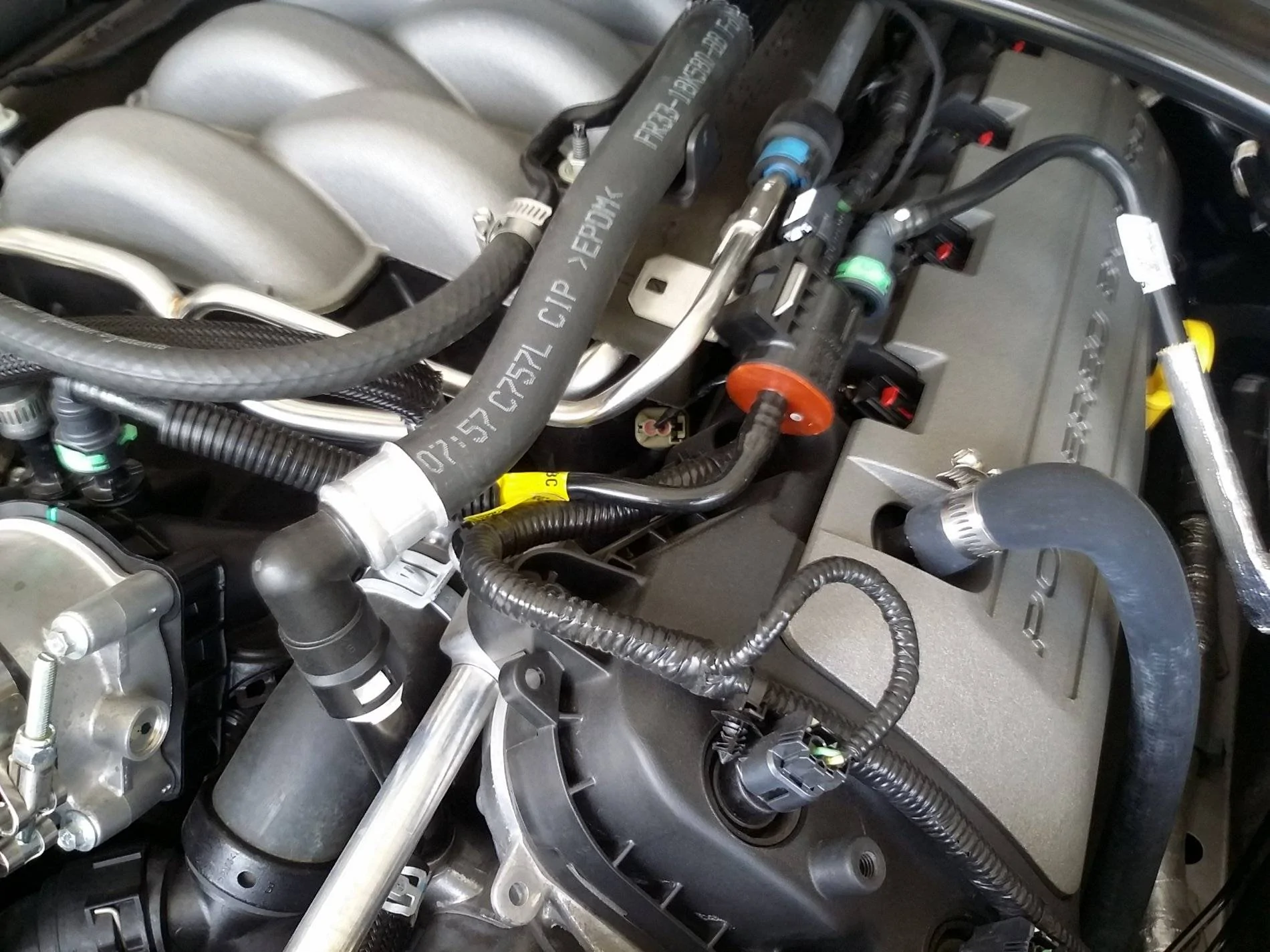

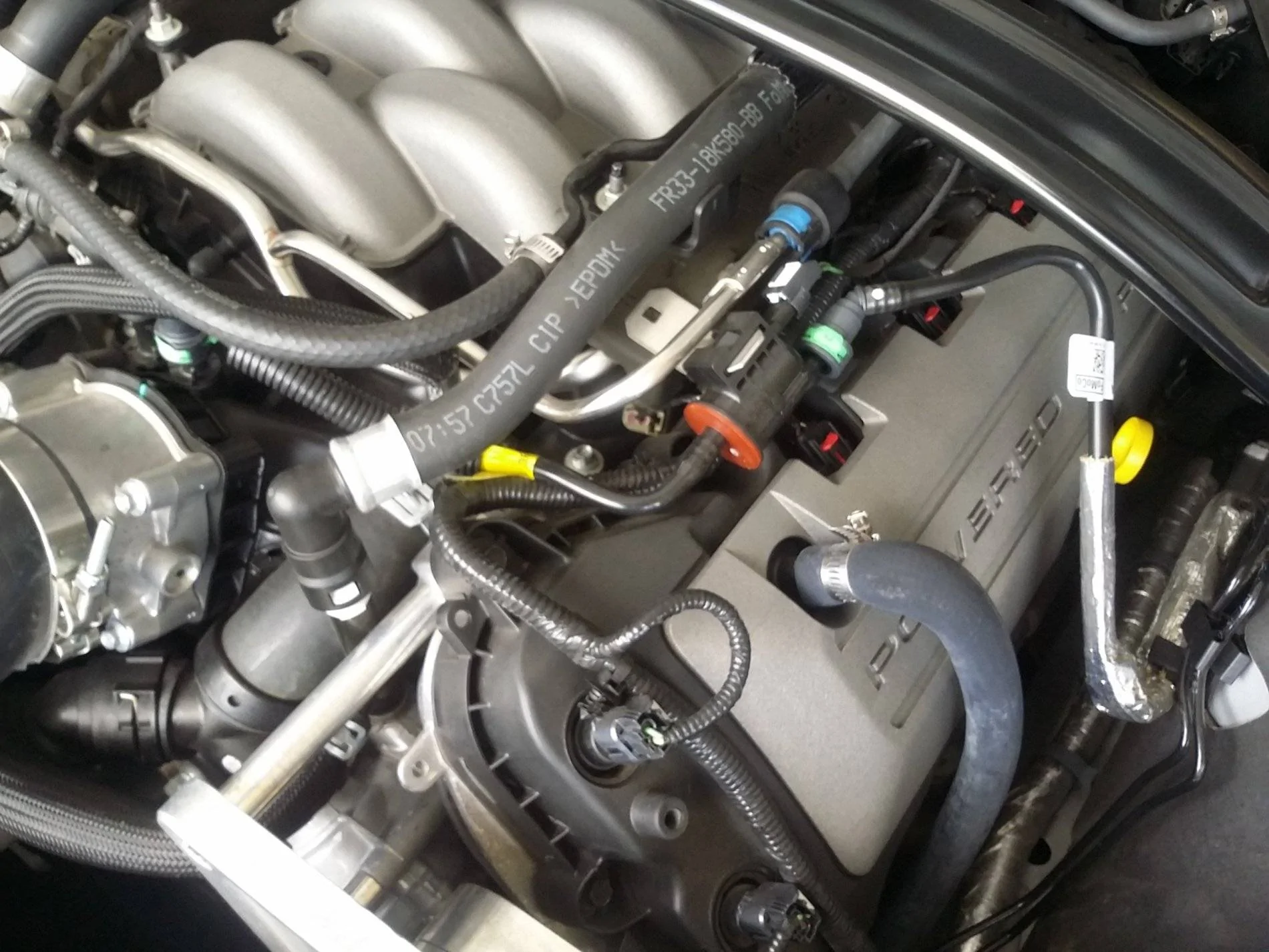

I can look them up in the morning when I get to work , here are some pics .

Part numbers you will need . Purge valve jr3z-9g297-a line from purge valve to line on car jr3z-9g271-a and connector gu2z-14s411-ka .
