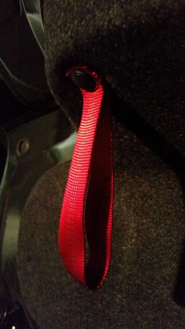

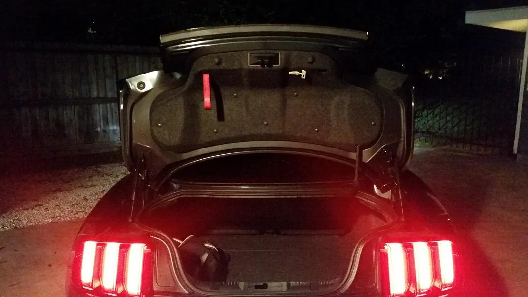

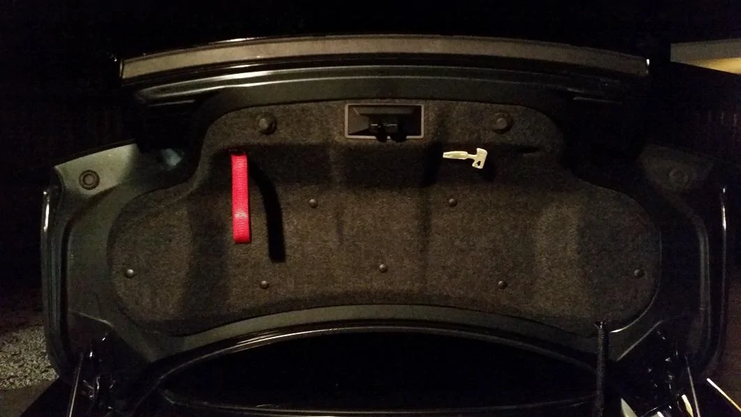

[MENTION=8319]doulos4jc[/MENTION] and [MENTION=16837]stanger95[/MENTION], hope you guys don't mind. I took your design and development one more step!
I love the idea of a "touchless" trunk pull; I hated the growing row of fingerprints that seem to appear on my trunk like small children with a stainless steel refrigerator door. :rant:

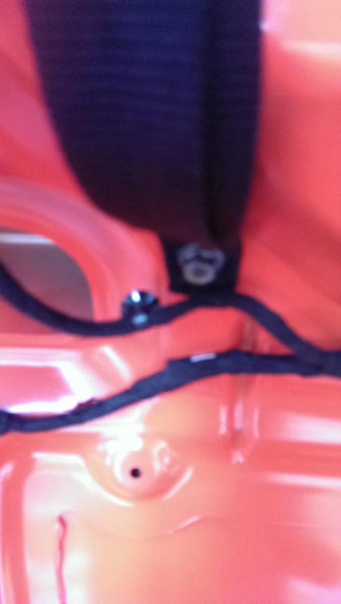

My requirements were
  • no new holes - drilling and self tapping screws are out
  • no marring of the metal - needs nonmetallic washers and/or hardware
  • secure attachment - don't want it rattling loose one day
  • no possibility for rust - lock washers that bite are out
  • easy install - too tight to fit a nut on the end of a bolt in the interior of the trunk frame
After a day of prototype shopping, on my second design - success!
Very scientifically, I tested this contraption by yanking on it HARD repeatedly. So far so good!
Perks:
  • 30 second install
  • no disassembly required
  • OEM nonmetallic fastener
  • Choose your color!
I'm looking into getting materials for a plug and play kit if people are interested.

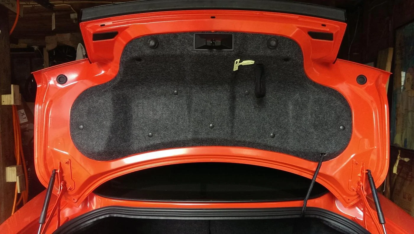

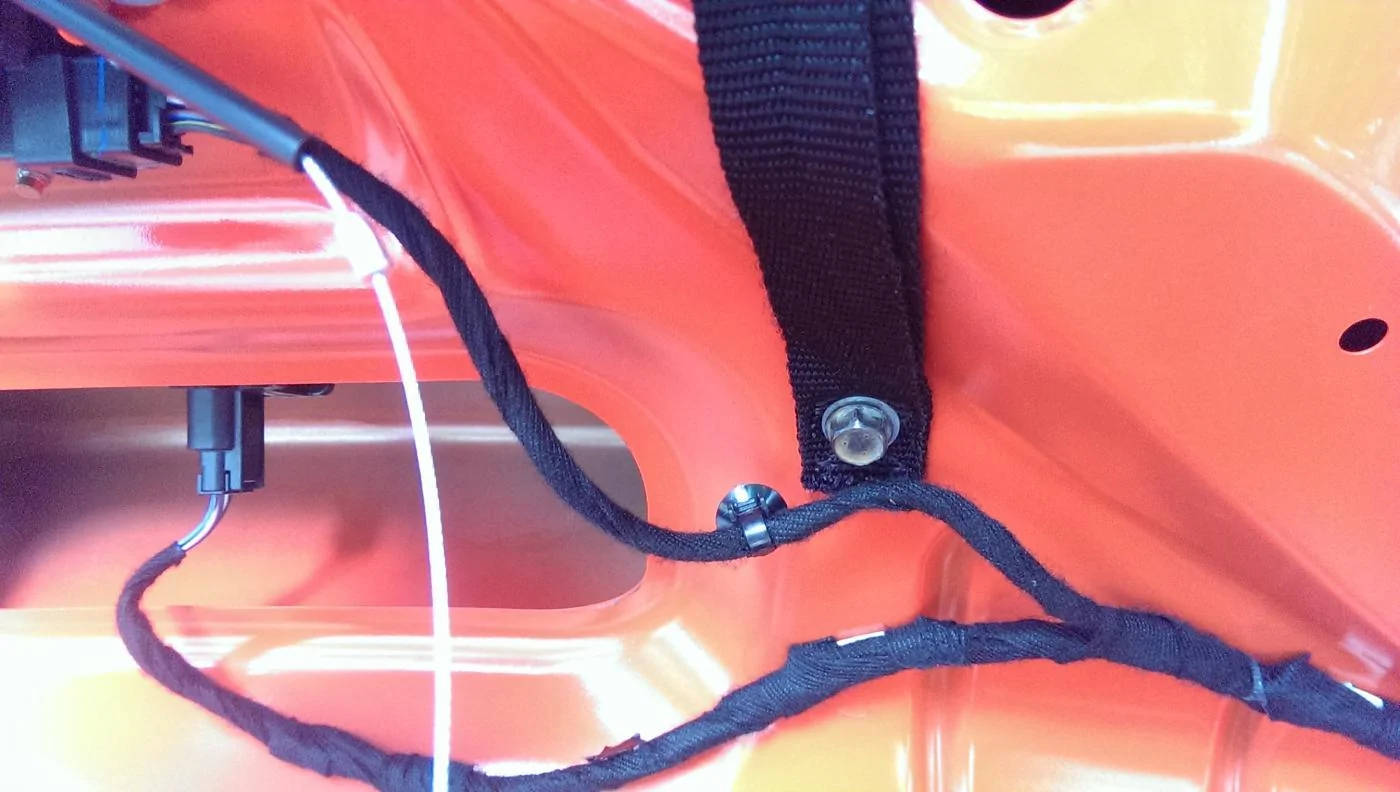

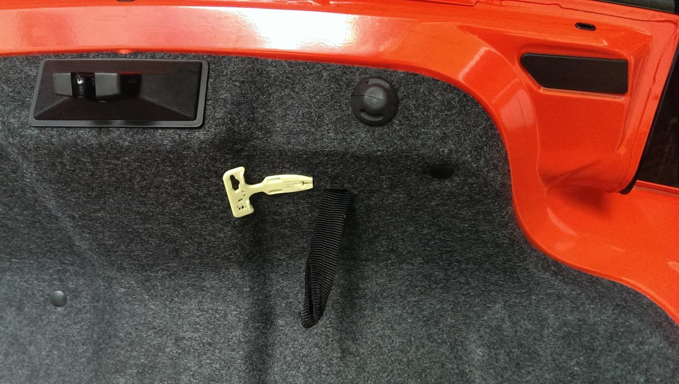

Dollar store dog leash, self tapping screw, washer.
doulos4, I love this, but I wasn't a fan of drilling the trunk. so I took your awesome idea and modified it slightly (hope you don't mind)
I removed my trunk panel and popped this wire clip,
took a 12mm bolt and put it through the leash and tightened it down.
I cut a small hole in the panel and pushed the leash through.
this is the final result. :headbang:

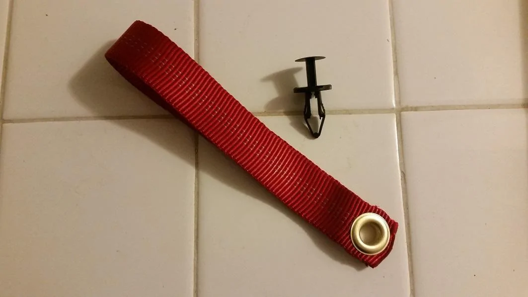

I have a 2004 Acura TL with the built-in trunk handle, so the lack of something in the trunk is annoying. OySmallFry, you had a great idea to use the existing black fasteners in the trunk. I'm not an expert on the hood loops -- is the grommet in the red strap a standard size? I'm curious as to where you bought your strap--is that the one you ordered from China that arrived early?
Thanks for the idea.
Hey [MENTION=17914]jwmraz[/MENTION], I actually made that strap. I already had the punch, die, and hole cutter. Picked up a role of flat vinyl and took some measurements. It's a 7" strap with 3/8" brass gromet, that length seems to work well. It feels very natural.
That is NOT the existing fastener. The current fasteners pull out with very mild force, go check your trunk and you'll see. I had to shop around for that one - it was an extra long, stepped design with a very snug fit.
[MENTION=18336]OnYourKnees[/MENTION] I'll see if i can find a part number, I believe it was labeled as a GM bumper fastener.
It's only OOS because the parts arrive Friday. I won't sell anything until i know for sure i can deliver :)
