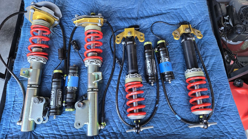

Do the springs not have numbers on them identifying what they are? I know my Eibach springs have a part number on them that specifies the size and spring rate. For instance if you look at the rears on the right side of this image you can see they have a part number of 0600.225.0900 which translates to a 6" long, 2.25" diameter, 900lb/in spring.
It isn’t written on the spring itself but doing a little digging, fronts are 12k and rears are 14k.
Well that is what they're "supposed to be", but without any writing on the spring itself I don't know how you'd definitively confirm what you have at what corner.
