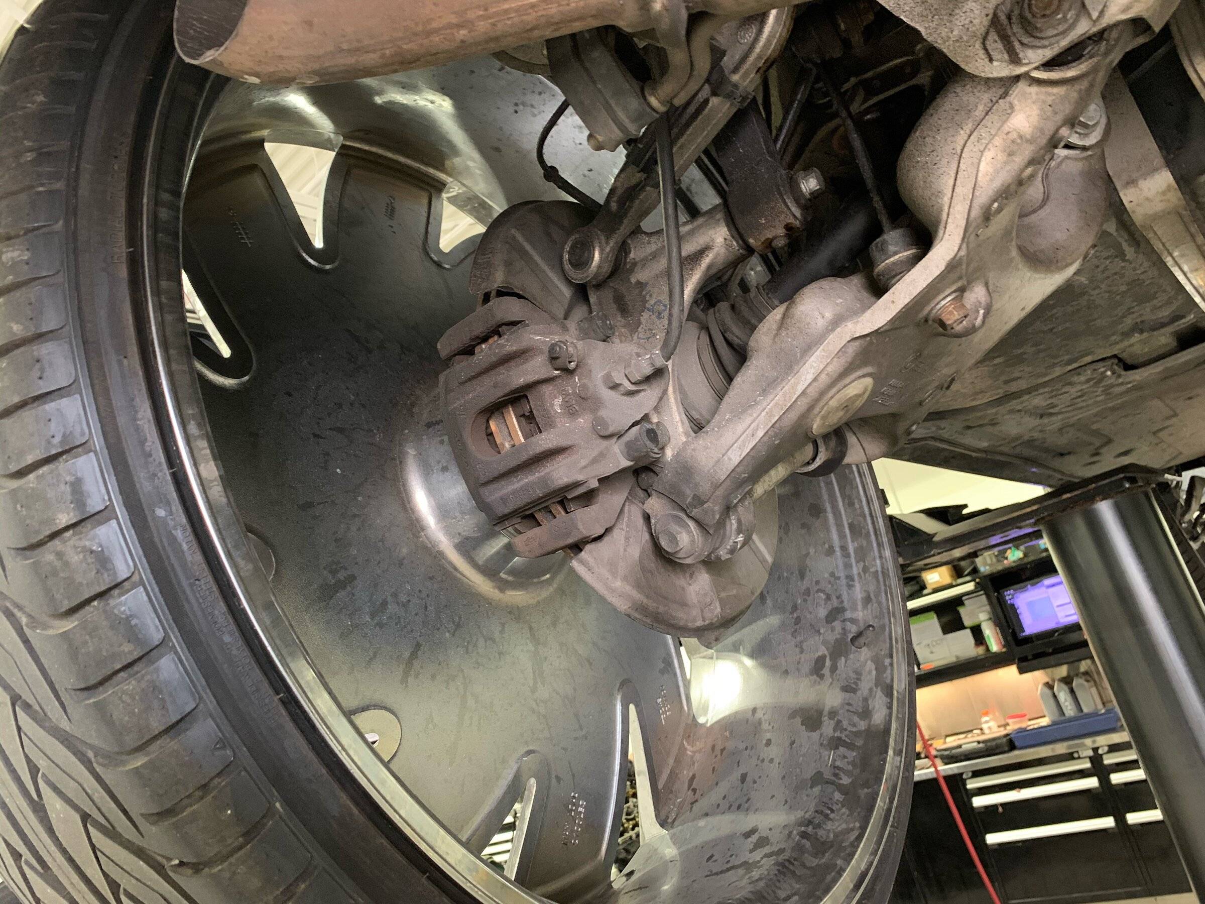

Man that would be something if you could get the caliper and rotor off without removing the tires.
I had a car at work once that had gigantic wheels on it and you could totally get the caliper off without taking the wheel off. A 745Li with 33s. What a dumb looking car.
