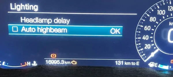

This “feature” drives me crazy. Great in rural areas perhaps, but a constant back and forth in the city. Search here didn’t provide anything for 2021 and newer. Not seeing a lighting menu on the settings. I leave the lights dial on the auto but prefer to control the high beams manually. Is there a way to do this? Thx.
Vlad Soare
Jan 21, 2020
67
3,679
4,522
Bucharest, Romania
Vlad
2020 Mustang GT 6MT

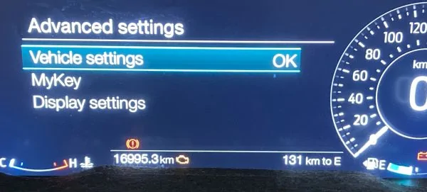

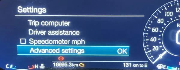

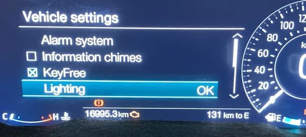

It is in the intrument cluster menu. I don't know the exact sequence by heart, but it's certainly there. I've deactivated mine.
